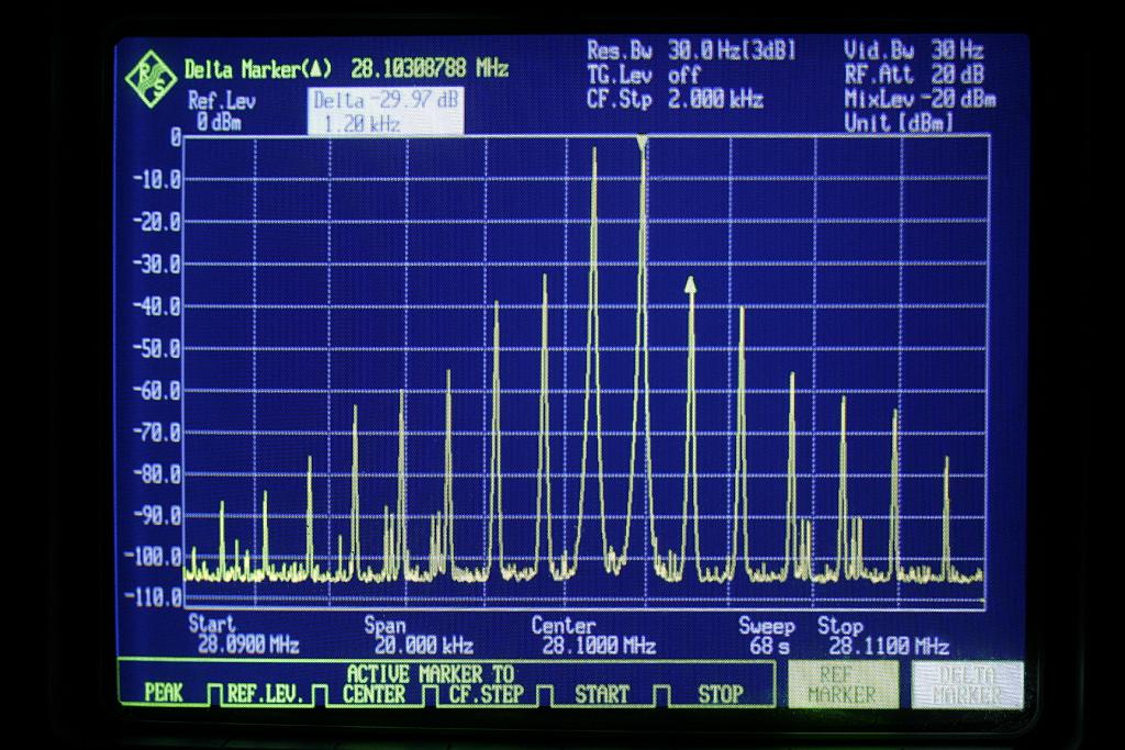

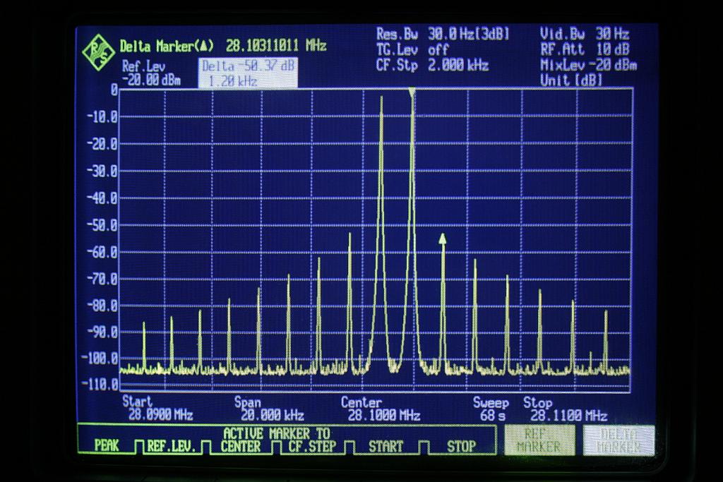

Using 2 Tone testing I am a little surprised at the two tone performance of the ANAN-10 at 8W. The TX output however is very good so I wonder if I have a bad PA?
Here are some images:
First 28 MHz from the TX out with the PA disabled this is at the same level that produces 8W PEP in later measurements.
Now 28 MHz at 8W as indicated on the ANAN-10 Power meter I know that it is actually 9.2W PEP but it's less than 10W and should be better?

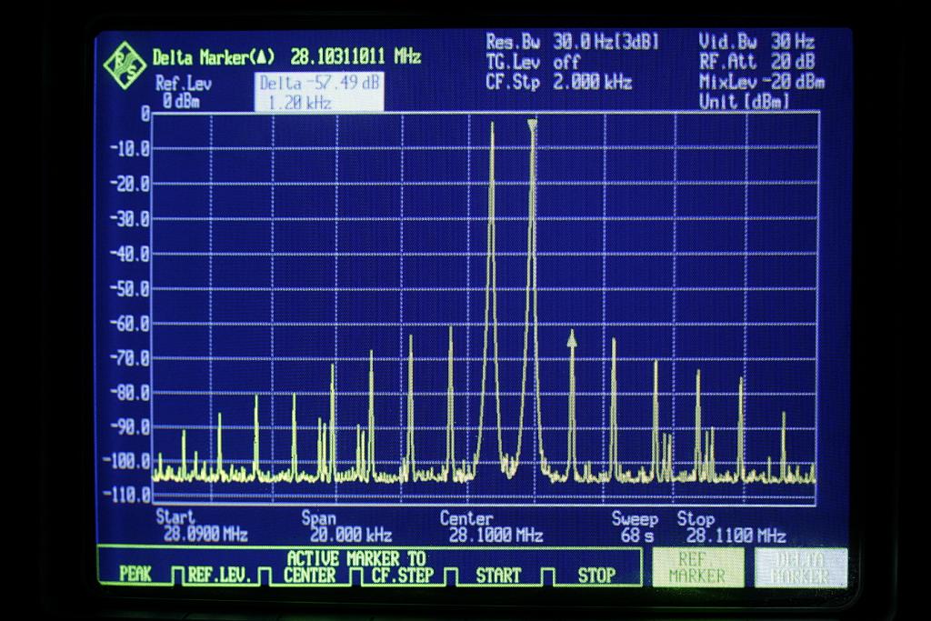

here are my ANAN100 IMD-tests on 10m band for comparsion.
After purchase i had to readjust bias currents due to poor performance (4 years ago).
Hermes output at 80% drive level, PA off, predistortion off
PA output at 80W, presdistortion off
PA output at 80W, predistortion on
On Hermes output i had expected less than -50dBc, this could be related to DAC niquist limit. On lower bands this is much better (-65dBc on 80m).
-30 dBc on PA output at 80W looks reasonable for a transitor-pa at 13.8V supply.
Throwing in PureSignal dramatically improves IMD to -57.5 dBc, which is even better than Hermes direct output!

I don´t know how you measured this - analyzer overdriven ?? at 33dBm on Marker 1 ?
Don't worry about the +33dBm, there is a function (Reference Offset) to display the "real world power" on the chart.
I have simply forgotten to do this.
Analyzer should get max -30dBm at Input to show distortion free - but I think you know that.
Depends on analyzer. Standard should be about 0 dBm. Don't mistake input level for mixer level, there are internal attenuators.
The standard procedure to test for overdriven analyzers is to put in additional 10 dB attenuation. If everything on the screen drops down the same amount the measurement was fine. I'm quite sure Conrad had checked for that.

Conrad,
Are your measurements taken with PureSignal enabled?

There is nothing proprietary about the PA design, increase the bias for better IMD without PS, however, PS works best with 250mA bias (each MOSFET). Not sure why one would run the rig without PS enabled?

Now more serious. My ANAN is worse that PA5Y , IMD is -21 relative to one tone on the 3rd order and -33 on the 5th order (at 9W pep).
I find it is another bad surprise after my tx spurs which are at only -60dbC;
This problem can be solved by tuning the quiescent current , I don't know wether it is of easy access on the pa board without taking the amplifier apart?
