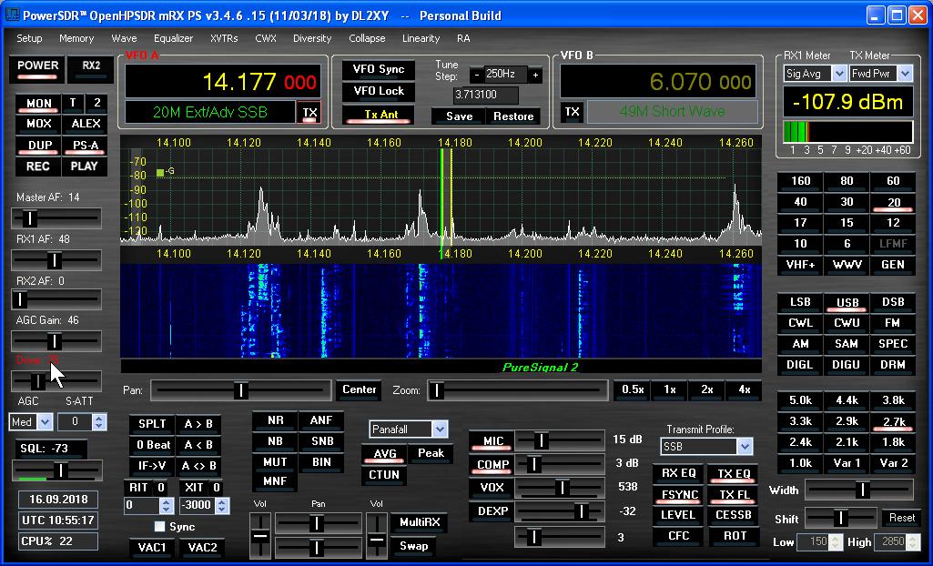

ok, it would be quite simple to add this functionality to source-code.
In my personal build i implemented that in this way:
In console.cs add a DoubleClick-Event for lblPWR.
Code: Select all
  private void lblPWR_DoubleClick(object sender, EventArgs e) // DL2XY Drive PWR Lock
            ptbPWR.Enabled = !ptbPWR.Enabled;					// Toggle slider enable state
            if (ptbPWR.Enabled) lblPWR.ForeColor = Color.White;    // change label color
            else lblPWR.ForeColor = Color.Red;
Add appropriate ToolTip-text to lblPWR.
Drive PWR mod.jpg (144.5 KiB) Viewed 7478 times
This will do what you expect.
One double click on the label will grey-out/lock the slider and turn the label color to red.
The next double click will restore normal slider function and label color.
Notes:
The state is not persistent, the slider is always unlocked after programmstart.
There are other funktions that may overwrite the drive level settings (Tune and Two Tone Test) if not set to "Use Drive Power" !
Profile switches will overide power setting with profile defined Power even if locked !
73 Walter
DL2XY
