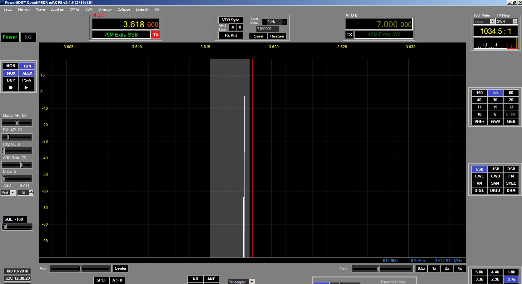

Not sure why, but the panel is reporting high reflected power on a band I'm not tuned up on, but the SWR reading is 1.0:1! The forward power meter reads less than the reflected meter reading in Power SDR (V3.4.9), but the SWR meter reading is incorrect.
I'm curious as to whether this is an issue anyone knows about or whether it is specific to my radio.

It seems that on the band I am tuned up on it presents a reading up to 1000:1 and then anything over that seems to now show as anything other than 1:1, which isn't great. I also don't get an High SWR warning in the display. :-/
The rig is only a few days old so if the unit is defective I should be able to replace it, but I don't want to look stupid before I attempt to do that.

Increased the drive slightly, but it didn't do anything. It occasionally warns of high SWR. If the SWR reading is off the scale, it just says 1.0:1. I remember the Flex5000A would bitch quite easily, but I believe the outputs are different and this could well be something to do with the warnings or lack thereof.
