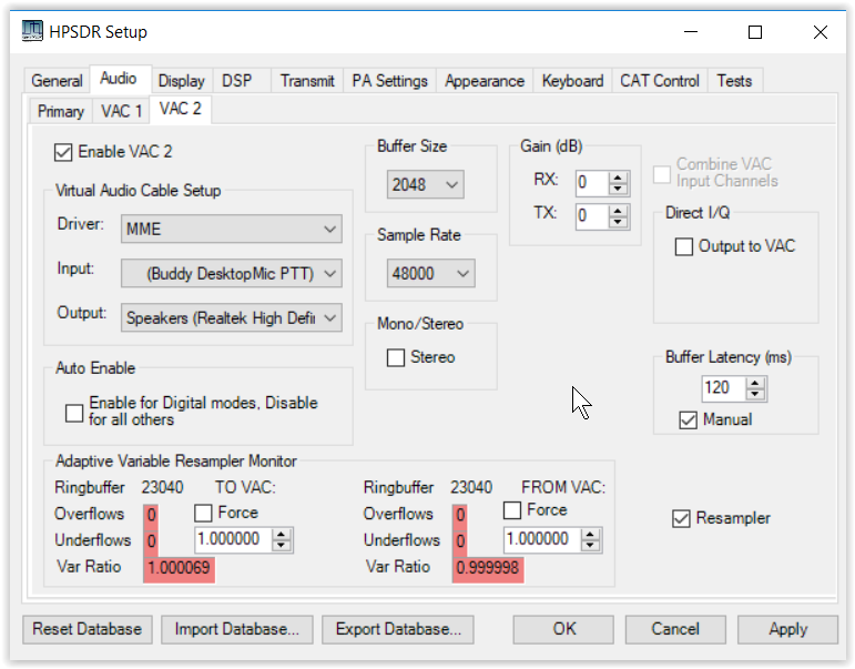

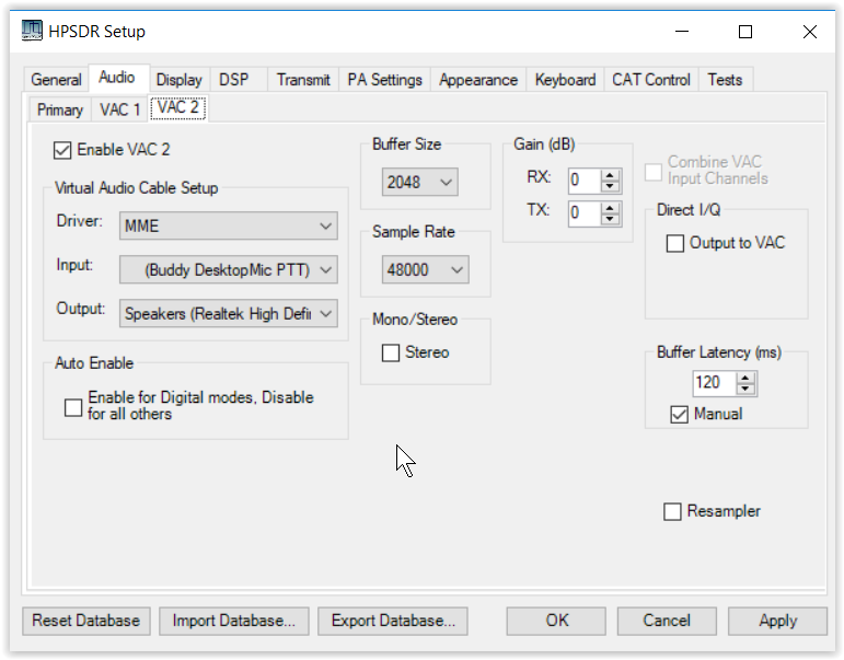

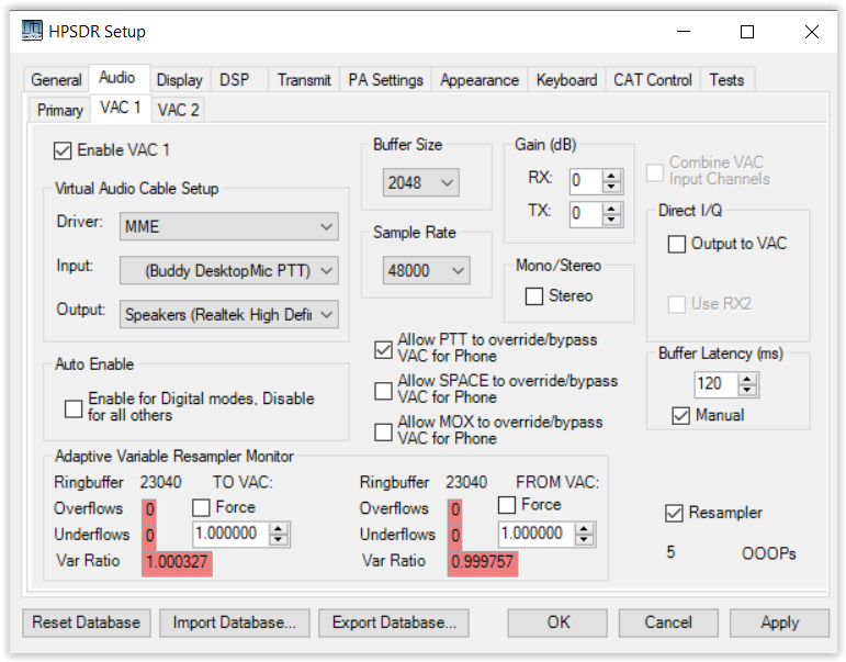

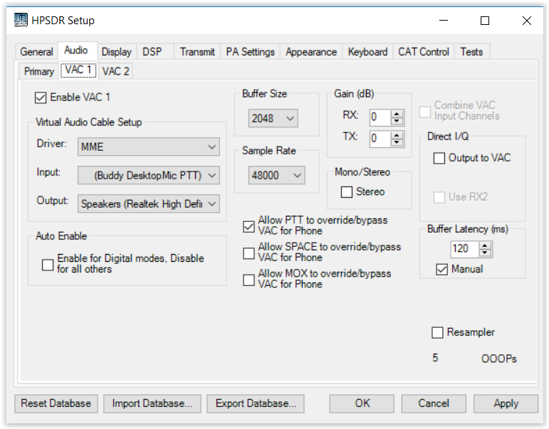

Re: INSTALLING OR RUNING NEWEST THETIS CORRUPTS DATABASE ON POWERSDR ON SAME PC.
Using VAC1 and VAC2 constantly on 2 antennas no problem all last week with resample off. Yesterday I was able to edit the bad database to turn both resample settings off and program restarted fine. I have screen shots of both VAC1 & 2 with and without resample on.
Just now I turned resample on on a new database and ran the radio for a minute. Went to setup and turned off resample. I was then able to restart PowersdrMrx OK. At least that is a workaround. Can not attach 4th file VAC2 resample on. Will send 2nd reply for that.
KA1GXR
VAC2 resample on attached here
Great screenshots, thanks.
First, let me be sure I understand the problem: the resampler works and PowerSDR starts, as long as you start with the resampler OFF, and never quit the program with it ON. Is that correct?
Second, a few minor observations (do these first):
1. Turn on the stereo option.
2. Turn off "Allow PTT to override..." if you do not have a microphone and PTT switch attached directly to the radio hardware.
3. Go into the Windows Sound Control Panel, access the advanced settings for each device you are using with PowerSDR, and make certain that each one (recording and playback) is explicitly set to 48KHz sampling rate.
Question:
- What is your Primary buffer size set to? I suspect it is a fairly large number.
Theory:
The combination of large primary buffer, large VAC buffer, and long manual buffer latency setting is somehow causing a problem with VAC initialization when the resampler is ON when the program starts.
Suggestion:
With the resampler OFF, try setting buffer latency to 0mS, and try reducing the size of both primary and VAC buffers to minimum, then gradually increase the buffer sizes, leaving buffer latency at 0mS, until you get something that works reliably. You will have to experiment with different combinations of primary and VAC buffer size. If you can't find a good combination, increase buffer latency a small amount, say by steps of 10mS. Once you have something much smaller than what you have now, then see if the resampler can be left ON when you quit the program.
