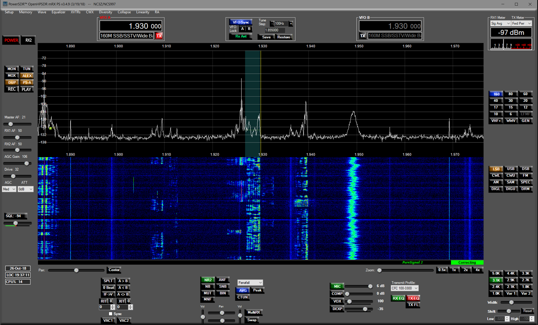

On my 7000 I have noticed for a while a nasty spur on 160M. Even with the antenna in terminated it is there. I do run all unused connections into terminators. Here are some screen shots on alive ant and on a terminated antenna.
BTW, the RX antenna is split to another radio and it does not hear/see this. And RX2 also has this spur.
Spur shorted in.PNG (1.08 MiB) Viewed 57299 times

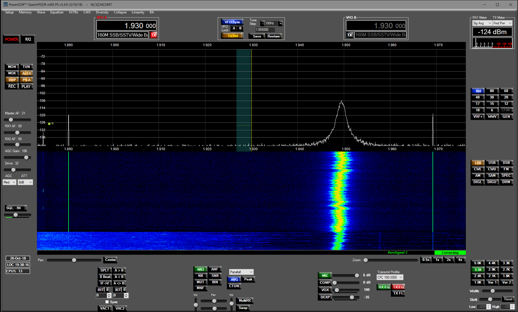

This is my spectrum when operating into a dummy load. The screenshot was taken right now with Thetis/P2 firmware because that's what I have loaded up at the moment, but it is identical to what I see with PowerSDR/P1. I've got a couple of birdies in there. I can't tell you if it's the radio, the power supply (Astron RM50M), or some nasty wall wart in my house. I haven't been sufficiently motivated or annoyed by them to find out because they are almost always below the 160M noise floor when on the antenna.

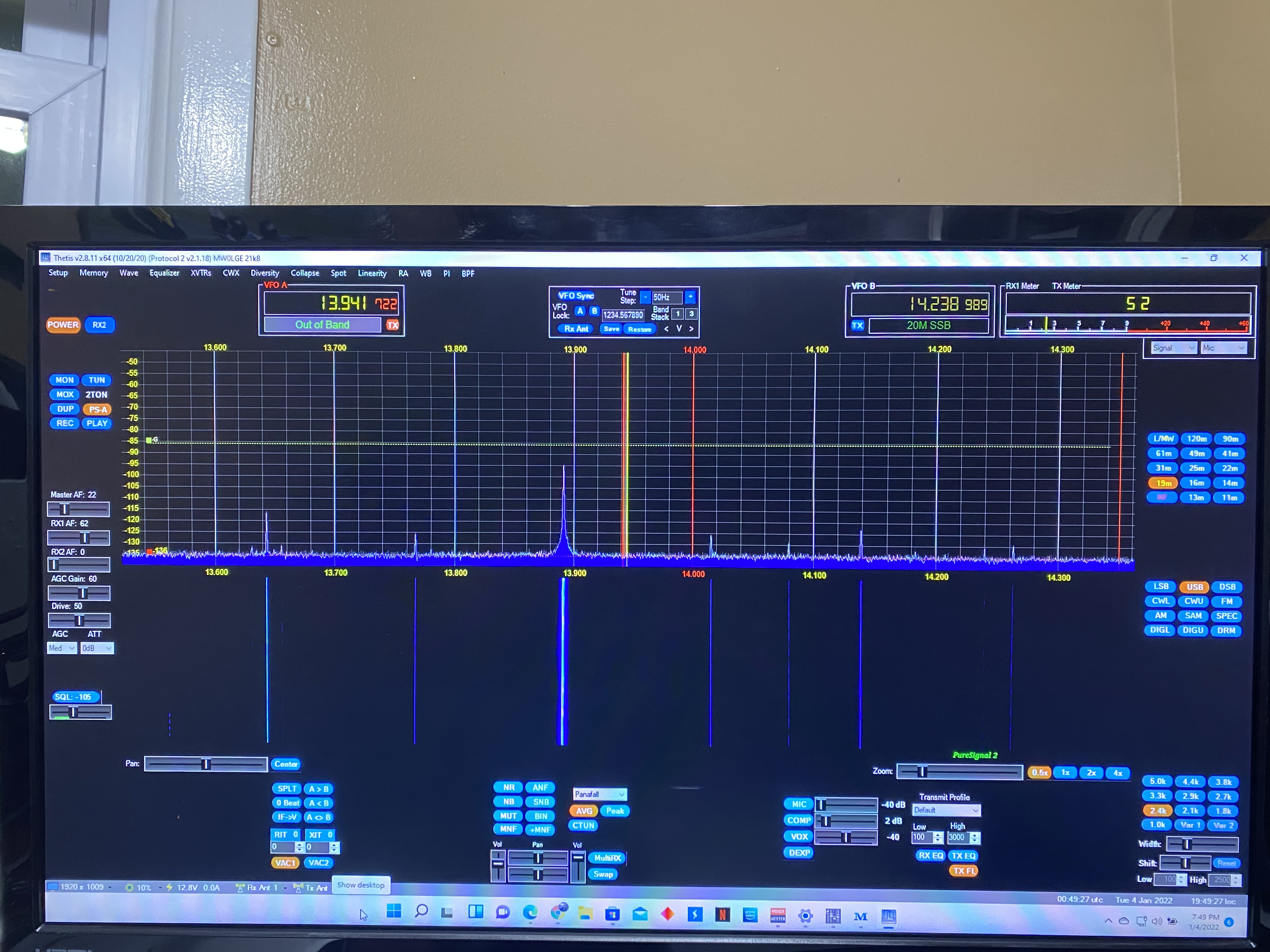

Having the same issue
Re: Unstable, wide, nasty spur
Posted: Thu Jan 06, 2022 1:46 am
Just remember, until you terminate all your inputs on the back of the ANAN, don't be too quick to blame a spur on an internal source.
Posted: Thu Jan 06, 2022 6:05 pm
by wa2cop
w-u-2-o wrote:Just remember, until you terminate all your inputs on the back of the ANAN, don't be too quick to blame a spur on an internal source.
Its on order! Will report back!... Also long ethernet cable to get it away from my other equipment.
Thank you for the support!
