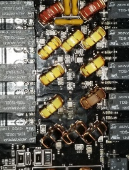

Re: ANAN-100 low 10/12m output with LPF enabled.
Hi Scott Thanks for the advice
There is a post on how to disassemble the ANAN ( 5 pages with pics and explanations )
http://anan-100d.wikidot.com/100d-disass
I did just that and Bingo , ( see picture)
There was a blown capacitor C88 and L15 's toroid color had changed from yellow to brownwith the wire insulation gone !
So I changed the capacitor to a 500 V 180 pF and rewound the toroid after repainting it and reassembled the radio . tests are OK now all bands work full power in their proper range although 12m remains a bit below 100 w which is strange . (probably i should change the L15 toroid but I don't know where to get those ).
Thanks , all your posts have helped me greatly to figure out how the filters work and to take the magic away from " ALEX"
73 ! F6IES

Just a follow up.
I didn't find any obviously over heated parts in the LPF. Testing components in circuit didn't yield reliable results. So I simply replaced all of the capacitors in the 10/12m LPF. That restored power output for 10 meters. Actually 12 meters could be made to function correctly with the 10/12 filter instead of pushing 12 meters down to the 15m filter in the setup. I used 500v capacitors in all locations.
I also found several low value resistors in the amplifier section that were clearly smoked and had changed value. They were replaced as well. Idle bias was then re-aligned.
Proper operation has been restored. I'm happy again.
Thank you all for your assistance,
Ed
WD4ED
Ed
WD4ED
Hello again,
A follow up to my follow up.
Shortly after fixing the 10/12m LPF I was doing some additional testing of the power amplifier. Much like the 10/12m filter previously, the 6m meter LPF appeared to be acting up.
On 6m the amp would only make 100w output where I had been doing most of my testing, 50.125 MHz. I should have been testing in middle of the band. I would have seen this earlier. By 51.000 MHz output was down to 80 watts, 52.000 MHz was 60 watts.
Back in I went. Visual inspection found that all three of the 6m LPF, L22, L17 and L18 were resting against one another. This would normally be a bad thing.
I removed all of the three inductors and checked their values. All indicated they were good. All of the caps were checked. They appeared to be good.
I then re-installed L22, L17 and L18. This time I repositioned their leads so that there was enough play in them to reposition them so the inductors wouldn't be resting on one another. This actually took some time.
I reassembled the radio. Now a gain setting of 42.7 db achieves 100 W output across the 6m band.
Summary: All I essentially did to repair this issue was to clean and reflow all of the inductors solder connections, then ensure none of the inductors were touching each other. Since the solder connections appeared to be fine, I'm going to go with the inductors values were being negatively affected thus detuning the 6m LPF.
Thanks again,
Ed
WD4ED
Thanks again,
Ed
WD4ED
