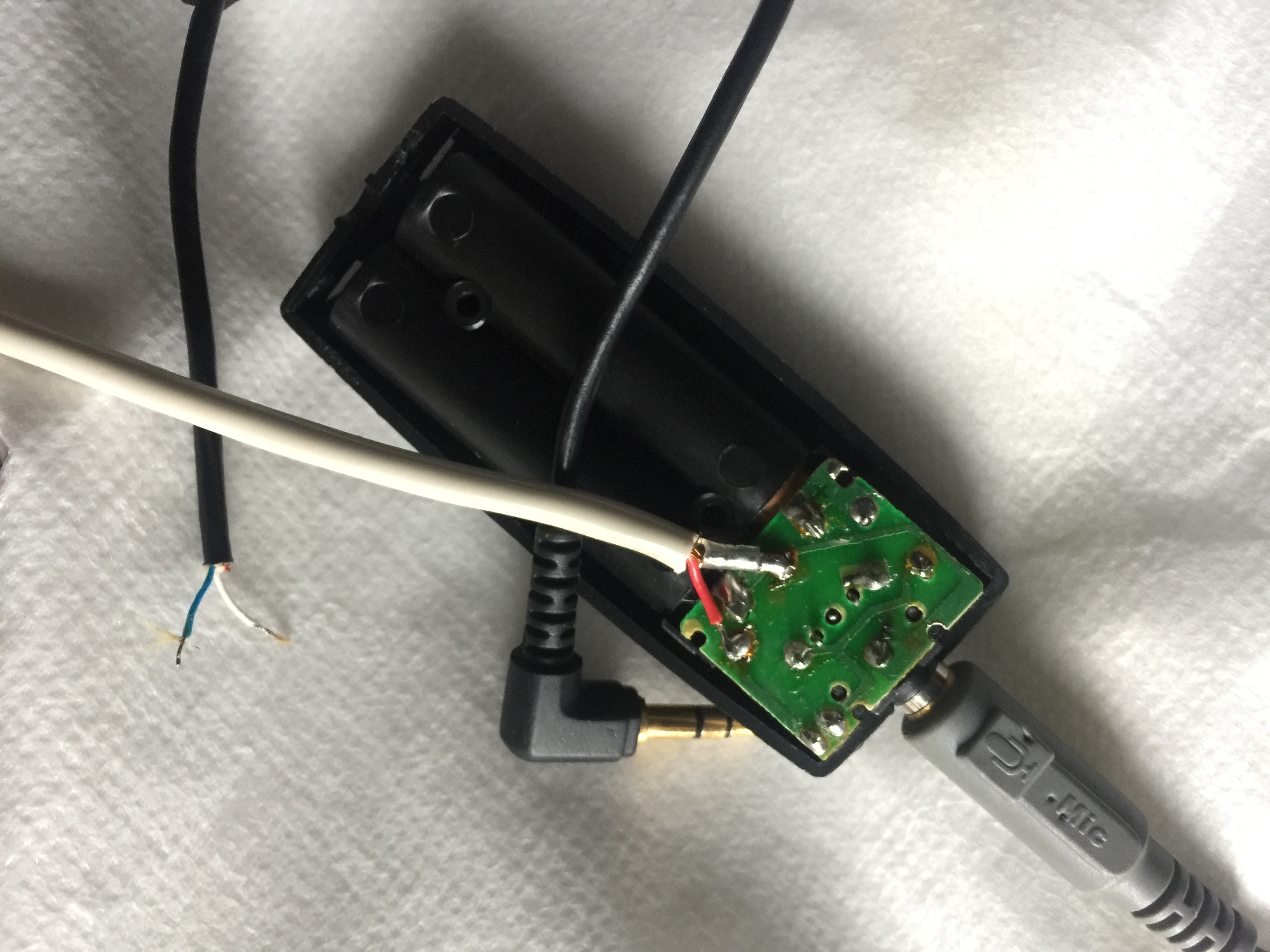

Scott, we did it! It was all in my hands.
I used the little black box that the Yamaha CM500 come with. It contains the necessary capacitor, etc. in a little board. It needs 2 AAA batteries which I will need to replace from time to time. I had tried it before but it still did not work. I opened the box (see pic) and noticed the cable / plug with tiny hair wires. One of the wires did not look well at the solder point. I replaced the cable with bigger ones....whoala!
I can now use the PTT in conjunction with playing the wav files.

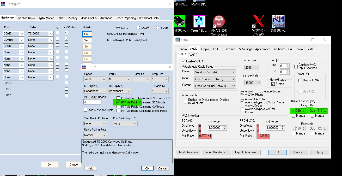

I wanted to report that I play the NAQP SSB contest this weekend using the Anan 7000dle with focus on N1MM+. I have *.wav files prepared via Audacity for the main exchanges; CQ, Name, State. These files I have always used with other rigs. They played superbly well using VAC1, I think, as I did not hear any complainers of my audio. Also, using Yamaha CM500 for the times needing it (Running).
I had to make a few configuration settings on both N1MM+ and 7000 so files will play and VAC be happy. Mainly, checking PTT via Radio Command SSB Mode on N1MM+ Configurer. On Thetis Setup / Audio / VAC1 Buffer Latency in / Out to their max (ms) of 240 as it kept the Overflows/Underflows at its lowest.
Here is a pic showing those settings:

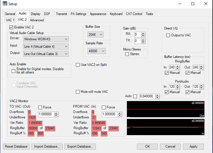

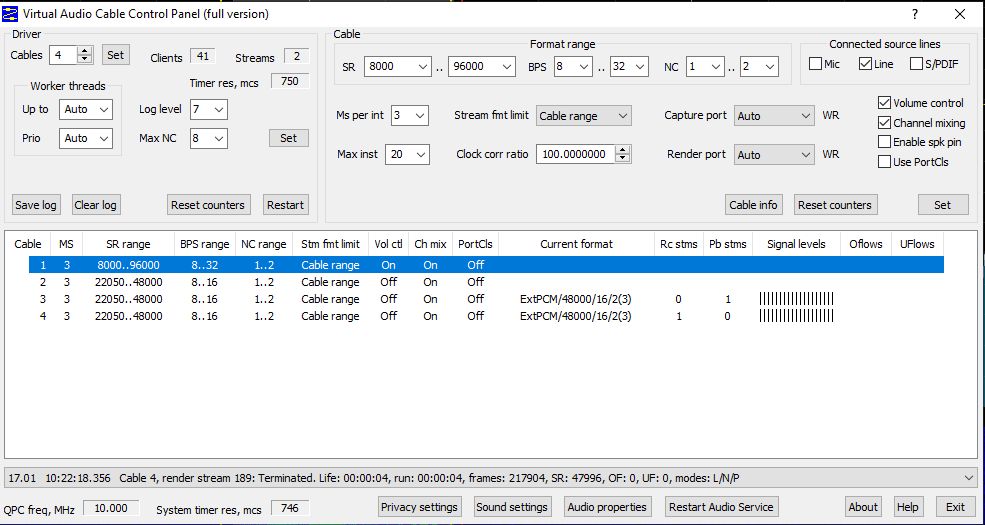

In N1MM I configured a WAV file under F1 (CQ).
When I push F1, PTT on my ANAN-7000DLE MkII black works perfect!
However I don't hear the WAV file...
I use N1MM+ latest version
Thetis v2.8.11 x64 21k8
Virtual Audio Cable 4
Enclosed some of the settings.
Why does Thetis not broadcast the WAV file?
VAC4 settings.jpg (79.34 KiB) Viewed 23267 times
Setup VAC2.jpg (68.44 KiB) Viewed 23267 times

You posted a screenshot of VAC2 settings. That implies you are trying to transmit audio via VAC2. Regardless of the fact that VAC2 allows defining a transmit audio device, transmission via VAC2 is not supported, only VAC1.
OE3JRC
Posts: 58
Location: Pixendorf, Austria
Re: N1MM+, Voicing wav files, 7000dle Mic
Post by OE3JRC »
Great! Now it works.... TNX Scott.
