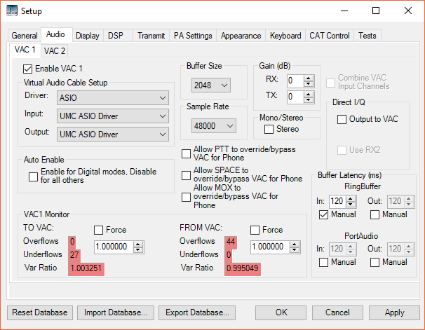

I use VAC on both RX1 and RX2 (see attachments). VAC1 is for voice, using ASIO and the mic and speakers/headphones attached to a UMC202HD. VAC2 is for digital, using MME and a pair of virtual audio cables. This is how it worked in PowerSDR. In Thetis, VAC2 will both receive and transmit properly. VAC1 will receive, but not transmit. Using PTT or MOX places the radio in transmit and mutes RX2, but speaking into the mic does not raise power above 0 watts. Windows sound panel shows output, and mic privacy settings are on. I have tried MME and directsound with the same results. What am I missing here?

As for your VAC settings, I suggest your database needs to be reset, and I do not understand how you were using VAC2 for digital with PowerSDR. Only audio brought in via VAC1 can be transmitted in both PowerSDR and Thetis.

I reset and manually modified the database each time I changed the firmware, and did again just now, but VAC1 still won't transmit. As to VAC2, it does indeed transmit audio, in both SDR and Thetis, over the virtual cable that is referenced only in VAC2. A macro turns off VFO sync, sets VFOB to transmit, and turns on the PTT. Reverse commands are sent after transmission. This works even if VAC1 is turned off.
I will keep trying for a while to get Thetis to recognize my microphone on VAC1.

I have just found that, if VAC2 is turned off, the microphone will transmit, even if RX2 is on. If VAC2 is then enabled, with no other changes, the microphone will not transmit. Any ideas on how that could be?

I've been trying different things all day, and it seems that, on Thetis, VAC 1 and 2 cannot be used simultaneously. VAC 1 will transmit only if VAC 2 is turned off, or set to ASIO (but then it cannot be piped to another program). I would like to hear from anyone who has VACs 1 and 2 working together under Thetis.

Buck--I have confirmed the behavior you describe. This is a fairly significant bug in Thetis, of course, and has nothing to do with Protocol 2 firmware per se.

Afraid so. I've now tried every combination: ASIO, MME, etc. with VMB, M-VAC, and even VMP (potato). If VAC2 is enabled, VAC1 will not modulate the transmission. While hoping for a fix, I will go back to Protocol 1 and PowerSDR, reluctantly as I found much to like about Thetis. I wonder, though, about a different approach.
