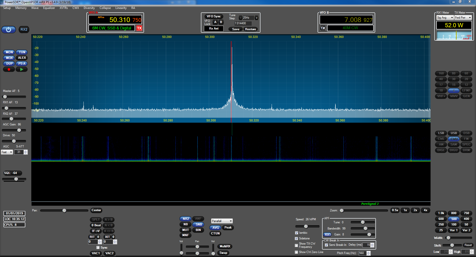

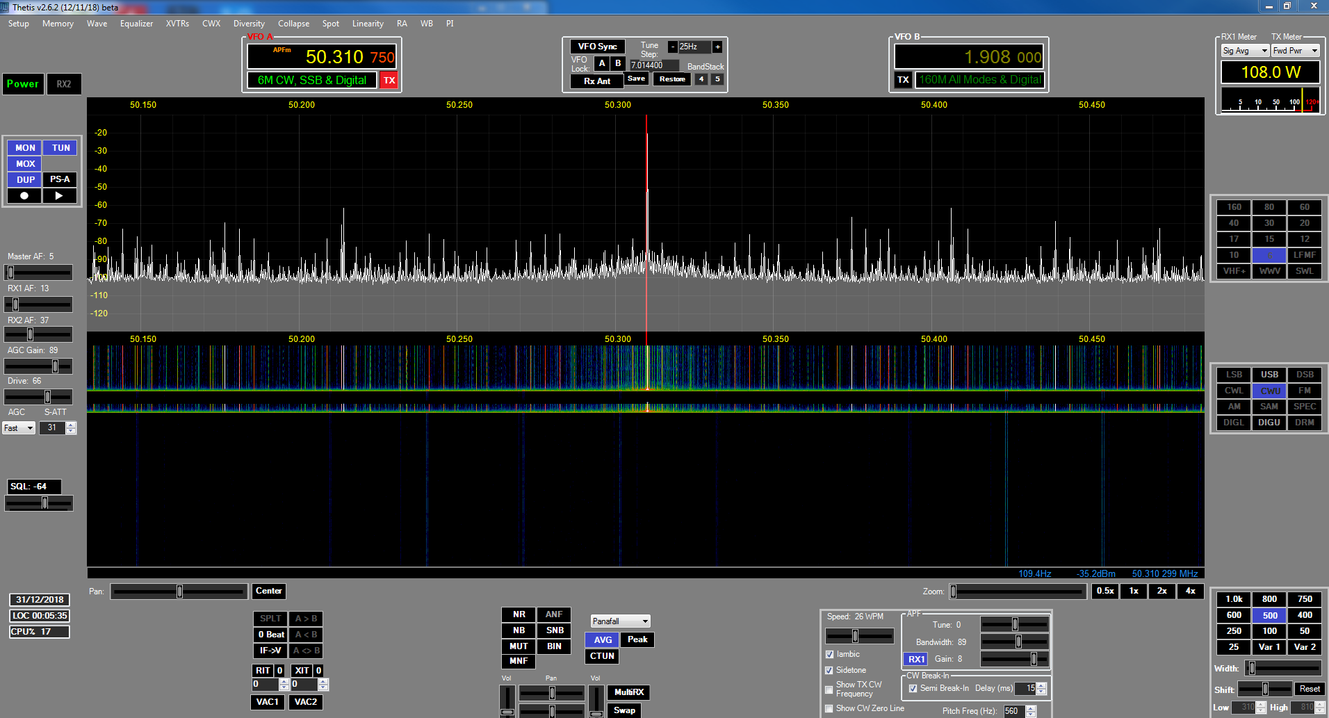

Re: Orion (200D) and Orion MKII (7000 & 8000) users: P2 v1.4 released
Anan 200D, P2 1.5 (pre), 384kHz
Many thanks for working on the problem with P2.
A quick check showed that the TX spurs were still present on 20m- 6m, but not on 160m-30m, so not changed from v 1.4. See attached wide TX spectrum screenshot from 6m (this is the most affected band) - TX is not usable 20m-6m,
Also, I noted a problem with RH audio channel having lower volume than LH audio.
v1.5 is stable- running today for 12 hours with VAC.
Keep up the good work- I feel a stable version is not too far away!
73 Dave G3ZQH
73 Dave G3ZQH
- P2 1.5 Thetis 2.6.2 6m spurs.PNG (262.77 KiB) Viewed 35855 times
Anan 200D, P1 4.9, 192kHz
Hi Rob, Rick
Further feedback on the 6m TX spurs. Attached are Tune/DUP screen shots to confirm the 6m TX problem on my 200D. On 160m with P2 I have a clean TX spectrum. When I change to P1/PSDR on 6m I also have a clean spectrum. The spurs on the P2 6m TX spectrum could be due to a DUP artifact as Rob suggested, but with my linear amp indicating 'out of band' signals on 6m (safety feature kicks in) , I suspect it is a real effect on my Anan 200D. I don't have another RX otherwise I would check independently from DUP.
73 Dave G3ZQH
Hi Rob, Rick
73 Dave G3ZQH
- P2 1.5 Thetis 2.6.2 6m spurs.PNG (262.77 KiB) Viewed 35804 times
- P2 1.5 Thetis 2.6.2 160m TX spectrum.PNG (271.35 KiB) Viewed 35804 times
- P1 4.9 PSDRmrx 3.4.9 6m TX spectrum.PNG (305.75 KiB) Viewed 35804 times

Hi Rick, Rob and others
Some good news!
Despite the P2 v1.5(2) not working as others have described, I now have a clean TX spectrum. I re-loaded v1.5 (1) and ran the same Thetis 2.6.2 set up as before- same database. This time I had a clean TX spectrum on DUP/Panadaptor- just a few spurs at 70-80dB down. Same clean TX spectrum on the other bands 160-10m. I can't really explain this- possibly some quirk of re-loading the firmware?
So, I am beginning to believe what Rob said about it being an artifact of the panadaptor/DUP monitoring. Now, I will buy a small SDR RX- AirSpy HF+, SDRPlay or the new LIme seem good- anyone have any advice on the best choice? Once I have this and can confirm a clean TX signal I'll be much happier.
73 Dave G3ZQH
Hi Dave,
That's an interesting development following your latest firmware flash. I found with OpenHPSDR v3.4.9 that the spectrum looked nice and clean until I adjusted the S-ATT level manually in RX-1 to match the level that my Thetis software was set to. As soon as i adjusted it both RX-1 and RX-2 in OpenHPSDR looked very much like the display in Thetis.
I don't think you can go wrong with pretty much any of the little (relatively) inexpensive USB connected SDR hardware. I like the SDRplay RSP series because they can run a lot of different software including SDRuno, SDR Console, SDR Sharp, SDR Sharper, CloudSDR (don't see any downloads available at this time) and the RSP-SAS Spectrum Analyzer beta release. As I am sure you have seen in Simon's forum, there seem to be a lot of happy (and excited) Lime users, but I don't know how many different software packages it can handle.
It is very nice to have something you can trust to analyze what your signal actually looks like. Good luck with whatever you decide to get!
Rob W1AEX
