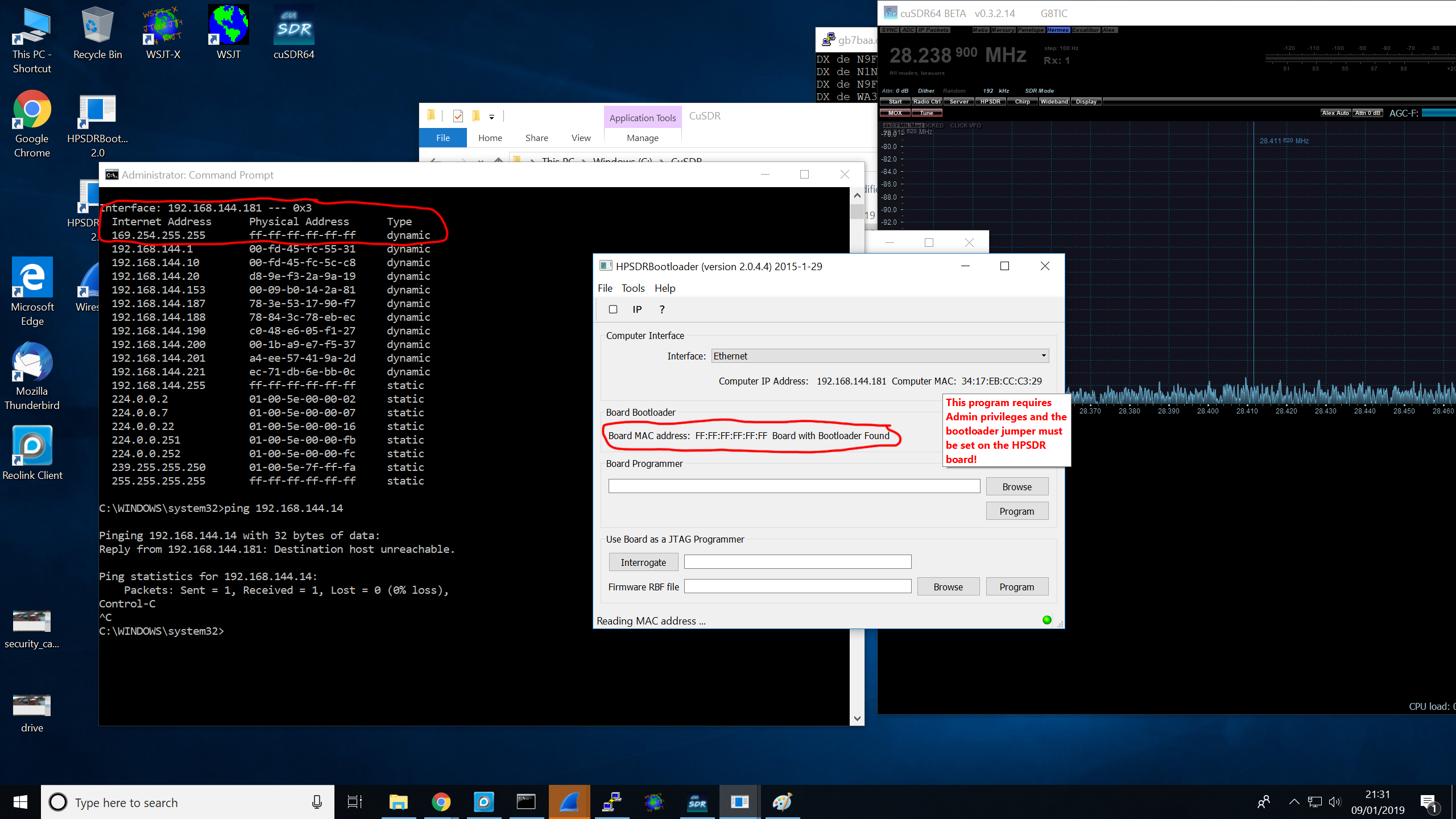

I have attached a sketch of the network as set up currently (Test Scenario 3).
I am not using APIPA - at least not deliberately! There are three Win 10 Pro machines on my network and I haven't configured APIPA, two use static IP and the one local to the Angelia is on DHCP.
My firewall/server in the garage (gate.tubby.org) has ISC-DHCP-Server running on it and this assigns IP addresses correctly to machines on my LAN - including the Windows 10 PC adjacent to the Angelia on the same FS105 dumb switch.
When put J17 on the Angelia, power it up and hit the [Test for BootLoader] button it reports that it finds a board with MAC address FF:FF:FF:FF:FF:FF.
I have re-flashed the Angelia with Protocol 1 firmware 5.9 RBF and with firmware 6.0 RBF using BootLoader and tested with the same issue.
I have used BootLoader to set the IP to 192.168.144.14 which it says it it has done but when I remove J17 and power cycle I cannot ping it.
Going back in to BootLoader and reading the IP address it says 255.255.255.255 ?
If I set the IP address back to 0.0.0.0 it says that DHCP has been enabled.
If I power cycle the Angelia and use BootLoader again, [Test for BootLoader] -> Tools -> Read IP it reports the IP address as 255.255.255.255 and Read MAC says FF:FF:FF:FF:FF:FF
In all cases CuSDR on the PC that is local to the Angelia, i.e. same dumb switch, works (probably not by design) because the PC emits a probe to the IP broadcast address 255.255.255.255 and the Angelia responds using IP address 169.254.255.255. The PC then does an ARP who-is 169.254.255.255 and the Angelia appears to answer ARP 169.254.255.255 is-at FF:FF:FF:FF:FF:FF after which comms comes up but clearly this odd since (a) the MAC address in use is the broadcast address and the IP address in use is an APIPA address related to the broadcast address. In this state it works on a dumb switch but won't pass through my managed switches.
Equally, since the Angelia insists on using FF:FF:FF:FF:FF:FF as it's MAC address it's DHCP Discover doesn't reach ISC-DHCP-Server on gate.tubby.org so it cannot complete a DHCP negotiation and doesn't get a proper IP address.
If I power cycle often enough then once in a blue moon (maybe one time in 50) the Angelia uses MAC address 00:04:A3:6A:67:F1 and then it's DHCP request does reach gate.tubby.org, it gets assigned a proper IP address and works as intended. It can take 15+ mins of power cycling to hit the one time when it works correctly ...
Is there a definitive list of the jumpers that I can check, just in case one is incorrect?
Looking at the schematic, U15 is a 25AA02E48T 2Kb EEPROM, connected to the FPGA - I'm guessing this is used to store the MAC address, IP address and other settings? Is there a way to perform a test on it and/or set it back to factory defaults or otherwise re-program it in case something is corrupt?

Re: Angelia networking weirdness - using Ethernet broadcast address
I've love to try another Angelia, Hermes or Orion but don't know anyone with one locally. That said, the reason that I had multiple test scenarios in my first email was to rule out network related issues - which I believe I did.
I can't see how any external issues, such as my network, would cause the Angelia to insist on using the broadcast MAC address FF:FF:FF:FF:FF:FF when it should be using its real MAC address (stored in its EEPROM).
I have attached a screen grab from the new PC adjacent to the Angelia - you can see that BootLoader says that the board is present but the MAC address is FF:FF:FF:FF:FF:FF ... you can also see that from CMD prompt I performed an 'arp -a' and that showed the IP address 169.254.255.255 mapped to the broadcast address.
I believe that the Angelia using the broadcast MAC address to be the root cause of my problems and this has to be internal to the Angelia ... possible causes might be:
* power supply power up sequence issue
* corrupt data in the EEPROM (U15)
* bad connection between the EEPROM and the FPGA
* faulty FPGA
Is there a way to read/write the EEPROM (U15) ? i.e. a programming/verification tool for it? I'm guessing that U15 stores the MAC address and other settings? Is the data in U15 stored with a checksum? Is the EEPROM copied to to the FPGA at power up? If there is a checksum on the data in the EEPROM? If there is a checksum and it fails does the RAM in the FGPA default back to all 0xFFs?
I'm asking because we used to make a vehicle based product that used a 2Kb I2C EEPROM and we had issues with reading out the data reliably during engine cranking and ended up having to read the EEPROM multiple times in a for() loop and exit if it was read correctly ...
Any way I look at this I don't think the Angelia is going to work as expected until it reliably uses its proper MAC address.
Mike G8TIC
* faulty FPGA
Mike G8TIC
- Angelia using MAC Broadcast Address.png (551.54 KiB) Viewed 18143 times
