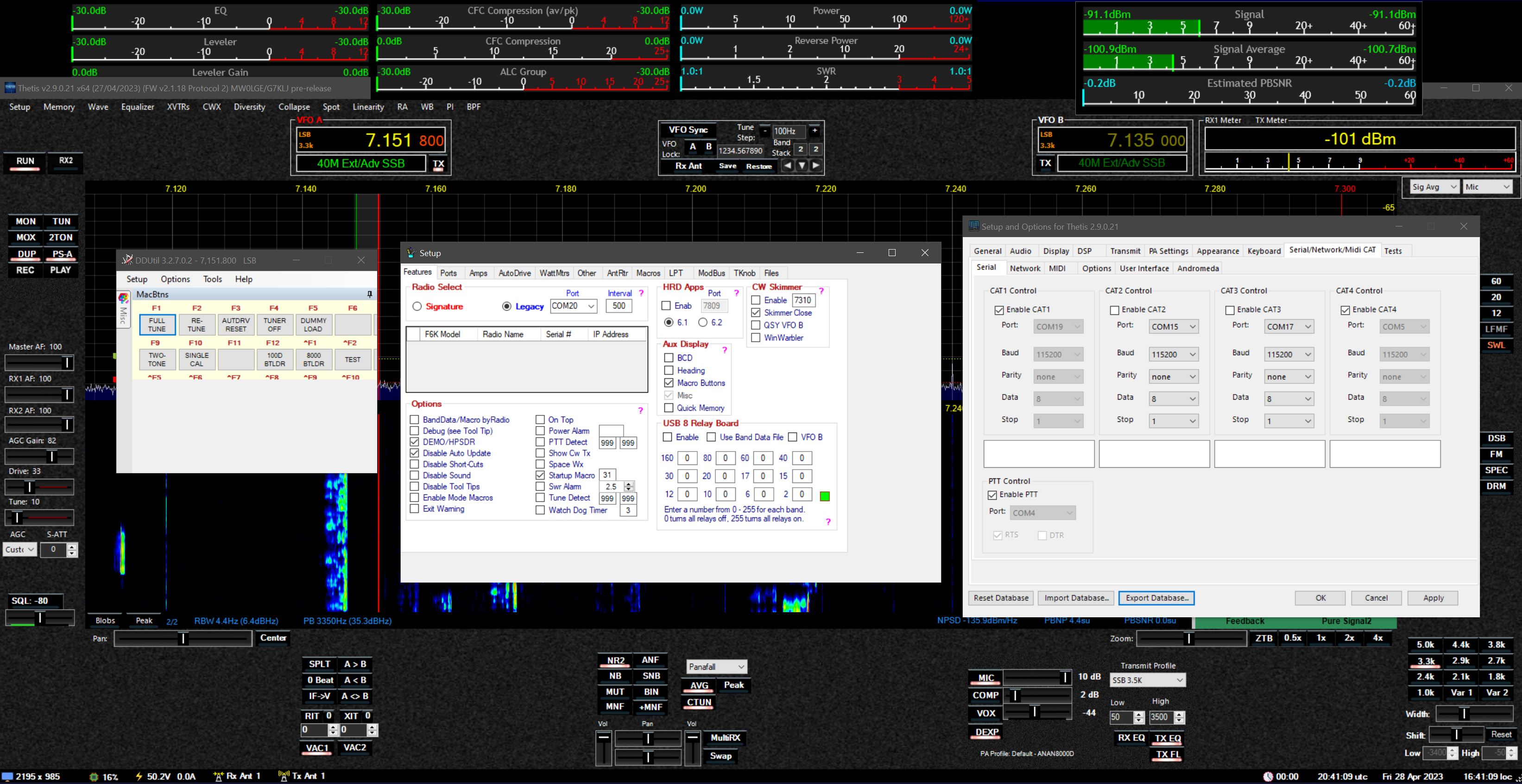

Why when I look at your picture posted does DDutil NOT show a radio>? And are you using LEGACY mode?
Look at the picture again. And you MUST have DEMO/HPSDR mode checked.

Your JPG was pretty small. I did miss some of the checkmarks and I will have another look. But you are probably right about the VM part with BootCamp. There are so many variables with what I am trying.

You can view the image full size by either downloading it or doing the right click open in new tab thing if your browser supports that.

Posts: 6103
Re: DDUtil support for PowerSDR and Thetis has ended (but 3.2.6.22 works OK)
Post screen shots of your Thetis CAT setup page, DDUtil setup page and VSPM virtual port pair setup page.
w4cm
Posts: 66
Post by w4cm »
Screenshot 2023-10-22 142553.png (1.02 MiB) Viewed 49691 times
Posts: 6103
That all looks fine with one exception: in DDUtil "DEMO/HPSDR" needs to be checked.
