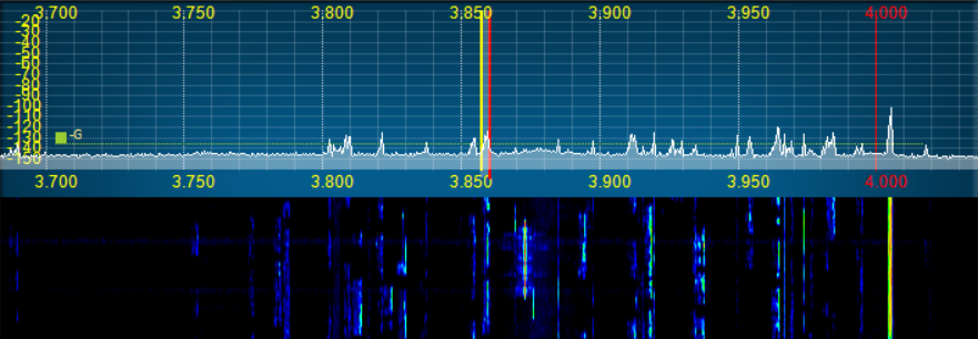

Re: Angelia (ANAN-100D) Protocol 2 test pilots: please check in
Hi Rick,
I finally broke down and loaded Protocol 2 into my 100D today. The released version 12 file was a mess. The 12.1_pre2 file kept me from rolling back to Protocol 1. And the 12.1_pre2_5550 convinced me to continue running Thetis.
With version 12 the noise floor was bouncing around and hovering around -60 on the spectrum display.
With version 12.1_pre2 the floor dropped to around -90 and stabilized.
With version 12.1_pre2_5550 the floor is sitting at around -150 and quiet as a lamb.
He attached screen shot is 80M a minute or 2 ago.
Bob
KO2F
Bob
KO2F
- 2019-05-13_21-26-10.png (147.57 KiB) Viewed 41186 times
