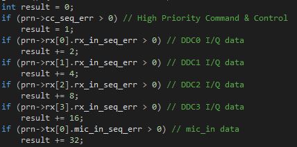

Right out of the source code, here is the Seq error "decoder ring":
The error codes are additive. For example, if there are Seq errors the DDC1 and DDC2 streams then you will see a Seq error code of 12.

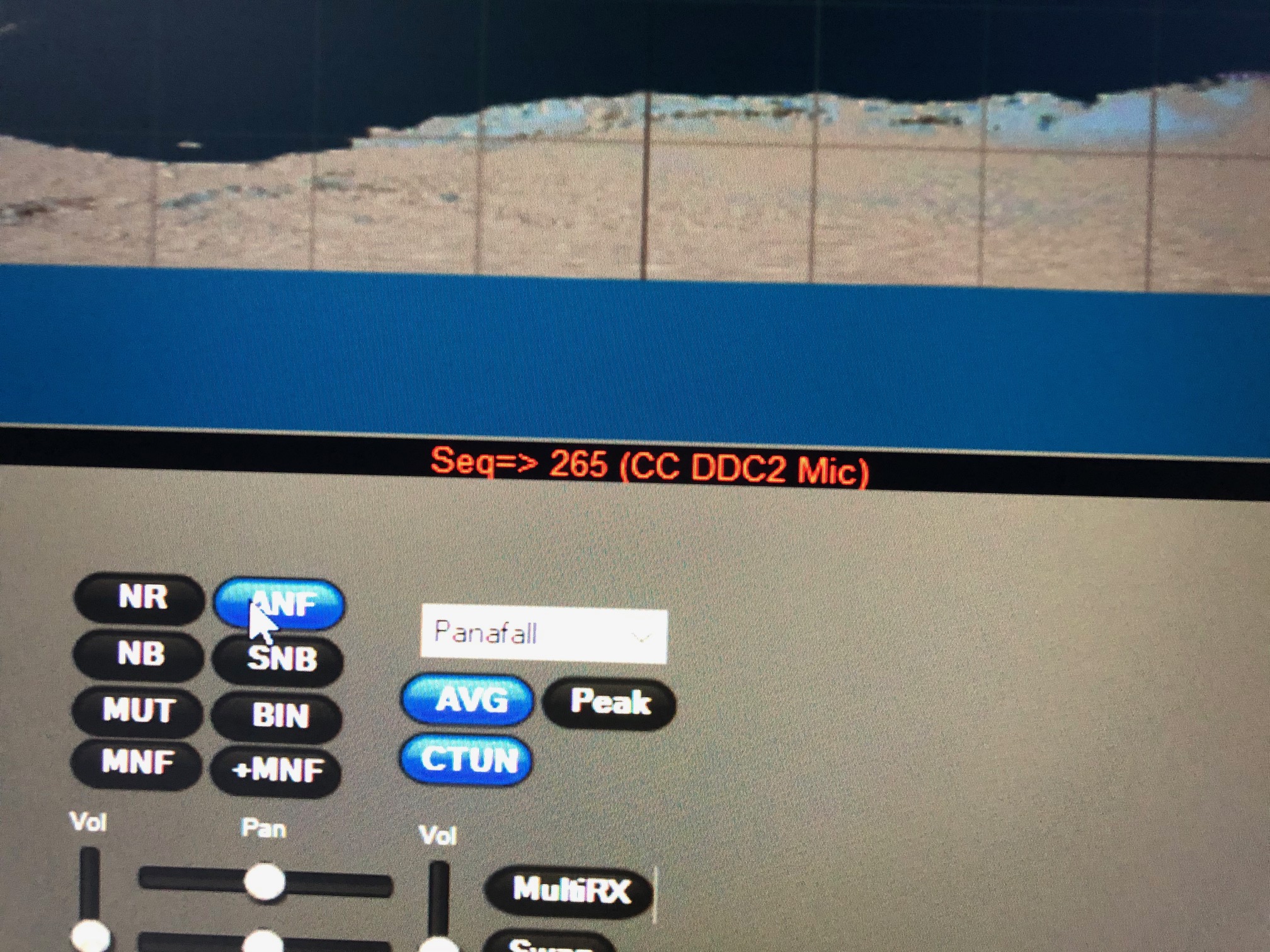

I'd like to jump into this thread if it's okay.
I just started getting these seq=>256 (CC DDC2 Mic)
I have almost a lock up situation, glitchy audio and video.
I've had no problems with Thetis v2.7.0 (3/1/20) till now.
Is this an indication I need to change firmware and reload?
It's pretty unusable at this time.
I have the 7000DLE MKII I7
Jerry K9GAS
Posts: 6002
Re: Seq Errors Explained
If you had no problems with your current firmware then there is no reason to change it as the problem must be somewhere else.
If you are worried that the firmware somehow became corrupted you can try reloading the same version again.
