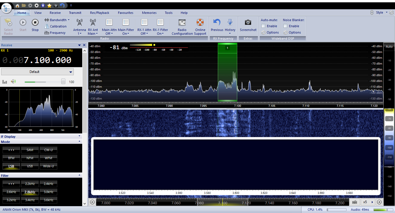

I am looking for assistance about how to remove the windows above the waterfall? (Blue windows marked with 3.520-3.680) I walked around the SDR console configuration but I don't find the option to do that. Please see attached screenshot.
Thank you.
Al

I am not in front of my radio at the moment Al but I ran into the same thing. As I recall, up at the top of the display, along the menu bar click on View. There is an option called "Extra Bands" that you should be able to disable, although at the moment I don't recall exactly what that involves. If you can figure that out, it does close that window!

I don't have SDR Console installed, but I believe that Simon follows the standard Windows ribbon bar UI paradigm. If he does, then merely double clicking on a menu item at the top will alternately show and hide the menu bar.

Rob and Scott,
Thank you for instructions, I knew it was something simple but I had not found how to do it.
Again, thank you for your assistance.
Al
