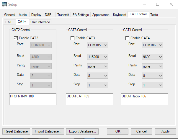

I am having problems getting N1MM+ connected to my 7000DLE, running Thetis 2.6.7 for some reason.

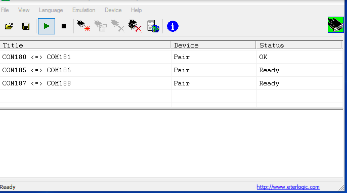

My normal logger is HRD, which connects fine. I decided to use the same port, as I am not going to run HRD and N1MM at the same time, CAT2 on port 180, which is paired to port 181 using the Eterlogic VSPE. HRD is set to port 181 and works fine, using a Kenwood TS-480 profile.

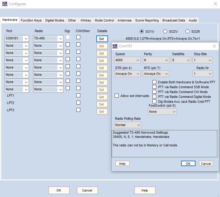

I can't get N1MM to connect using port 181. I have tried other port pairs and still can't get it working ...

I just tested using the TS-2000 and TS-480 entry from N1MM and they worked just fine.
You need to double-check the serial port parameters in both.
I run 115,200 None,8,1 in Thetis and N1MM shows SO1V 115200,N,8,1,DTR=Always On, RTS=Alyways On, TX=2

I wonder if N1MM or Thetis doesn't like the 3-digit port number. I know that's been a problem in some other software.
Can you try a lower port#? Especially in the 1-9 region ?

Yes, good thinking!
I changed the N1MM side to port 6 and it works, looks like N1MM does not like higher port numbers, which is a shame.
