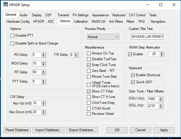

can't access the video either, but what are your PTT Delays set to under General > Options?

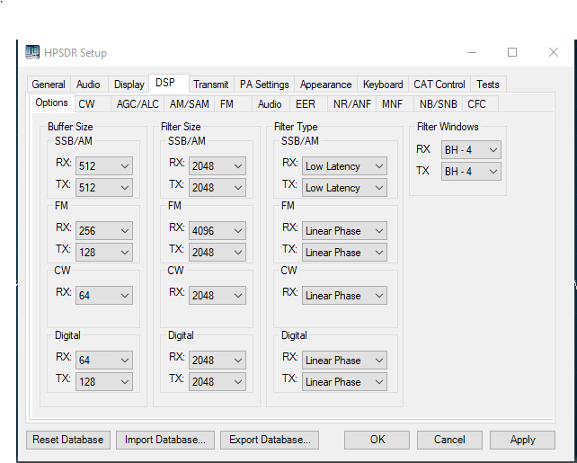

Post screenshots of the following settings tabs so we can see what your current settings are: Setup > General > Options and Setup > DSP > Options.
P.S. You should upgrade to PowerSDR 3.4.9, and use the built in audio processing features instead of that IHY box.

Post by WA3GIN-Dave »
This is a temporary ops position. There is construction is taking place where the primary ops position is located. The mic cord of the Shure 55S is too short to reach PC so used the W2IHY box for RCA jack and output to PC with compatible 1/8" stereo jack.

Re: Odd XMIT Artifact after PTT released
Well, you can't do any better than the low latency filter setting on phone. That exhibits approx. 20mS of delay at any length setting (because it is a minimum phase FIR filter, not a linear phase FIR filter).
The defaults for RX, MOX, RF and PTT delay are 0, 10, 30 and 0, in that order. Although there doesn't seem to be anything wrong with your values you might try going back to defaults and see if that removes the burp.
