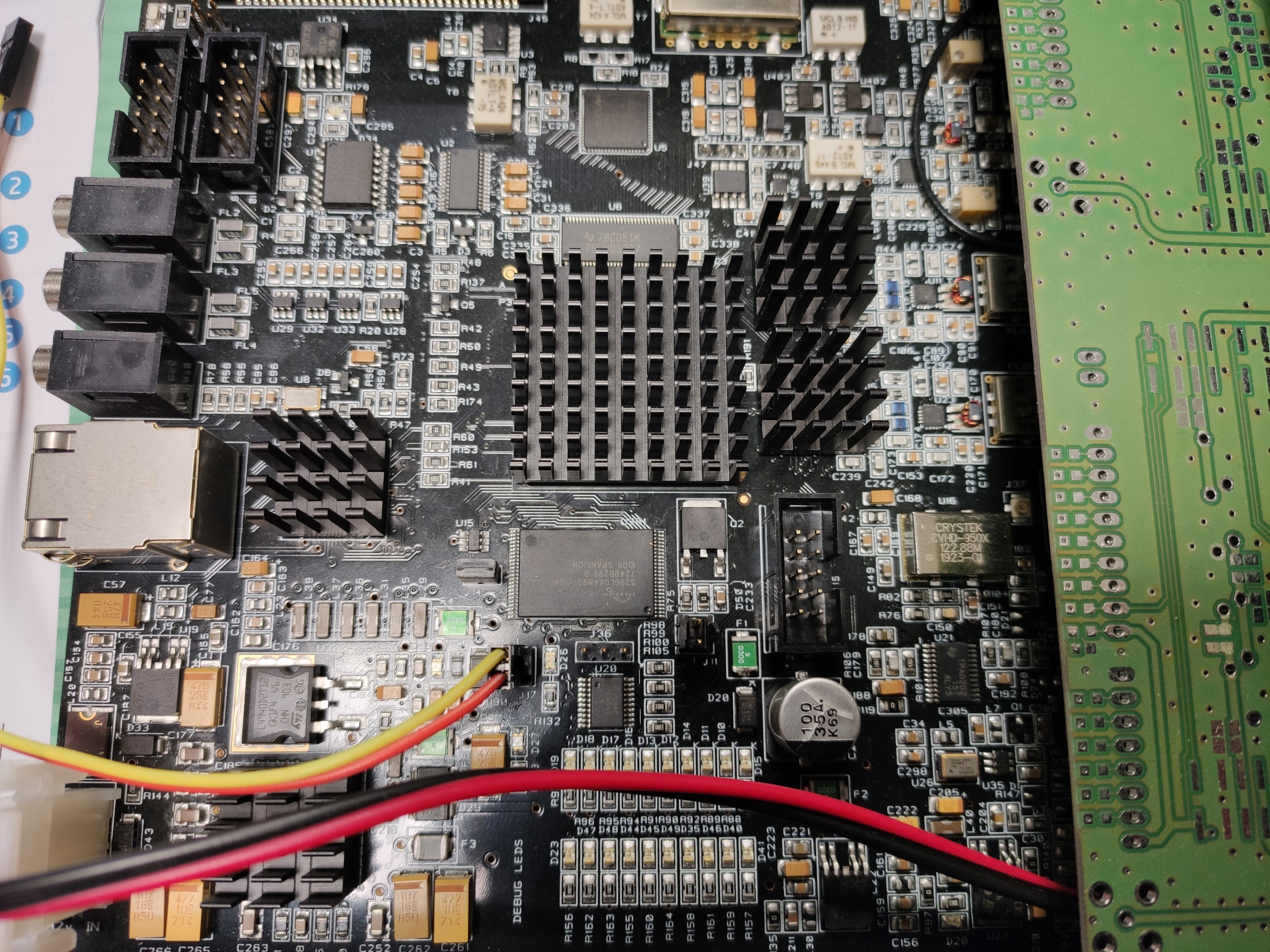

Hi there,
I had a similar problem with my Orion MKII card, the Micrel ksz9021rl ethernet controller was broken.
Excessive heat exposure over a long period of time is suspected.
There was a broken TX channel on my board, but it still worked when it was extremely cooling.
After the replacement, I installed heat sinks.
best regards René
best regards René
- Orion MKII.jpg (2.74 MiB) Viewed 12043 times
