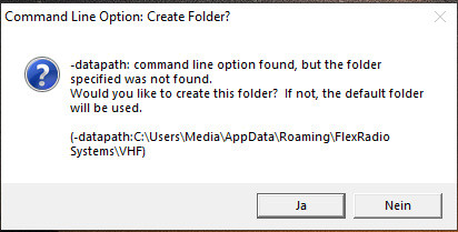

If the target folder /VHF or HF) does not exist, you will get a warning like this.

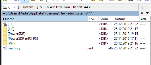

If you did everything right, you will end up like this.

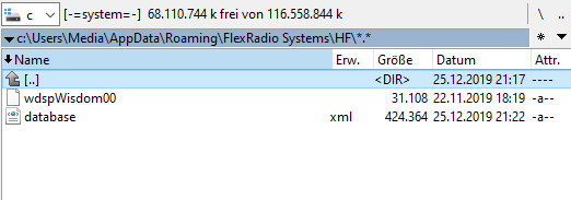

In each new folder you will find a wisdom and database file.
You can save the time to create the wisdom file by creating the directories (VHF and HF) beforehand,
copying the corresponding VHF / HF database and wisdom file from your initial PowerSDR mrx PS folder there.
Now you create the shortcuts with the different targets as described above.
Now you are ready to go.

In my case the shortcut target field looks like this.
Code: Select all
"D:\HAM Radio\SDR\OpenHPSDR\PowerSDR mRX PS 3.4.9\PowerSDR.exe" -datapath:"%appdata%\FlexRadio Systems\HF"Code: Select all
"D:\HAM Radio\SDR\OpenHPSDR\PowerSDR mRX PS 3.4.9\PowerSDR.exe" -datapath:"%appdata%\FlexRadio Systems\VHF"If you did everything right, you will end up like this.
