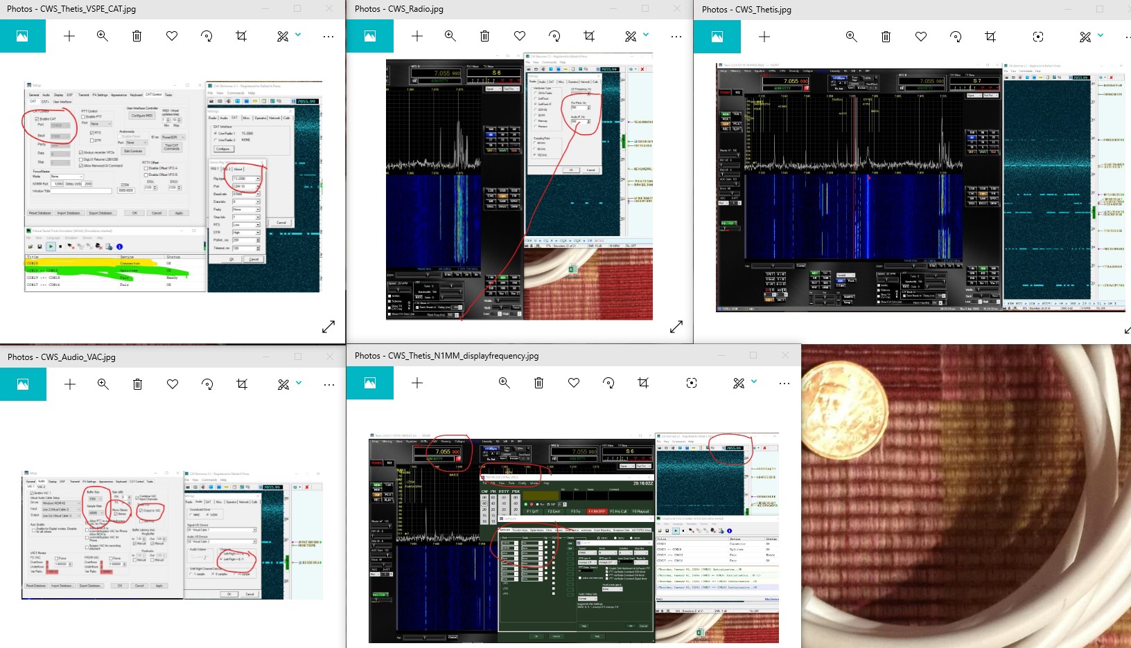

I have figured out why OmnyRig's CAT cannot connect to CWSkimmer so that it displays Thetis frequency read out. All it takes is the creation of a Connector and a Splitter. Additional Pairs can be added if needed for TX, i.e., PTT or CW. I used the VSPE eulation software.
In the sample picture attached, I set COM20 as the Connector. This port is set in Thetis / Setup / CAT. I also created a Split set COM20 <=> COM10. COM10 is the set that is used in all of the software, i.e., CWSkimmer, N1MM, etc.
The following picture will demonstrated all of the settings. I hope this can assist others in getting CWS to display the Thetis frequency and be dead-on spot when clicking either waterfall.

Hi, Gary and good morning all!
The system does not allow but only three (3) pics in one shot? So I took a snapshot of all of the snapshots and the penny and cable is part of the desktop...hihi.
I will try and see if I can post pics in several posts....or link to a Word document that I've created...stay tuned!
Rafael / NN3RP
Re: Thetis and CW Skimmer
Posted: Fri Jan 03, 2020 3:10 pm
by NN3RP
As promise, here is a Word document with the main pics and notations:
Thetis Setup with Skimmer.docx
(462.8 KiB) Downloaded 1404 times
or...here is a OneDrive link showing all of the snapshots taken in the production.
https://1drv.ms/u/s!Al_5NCnHQyKatBsSWk_ ... R?e=OryL47

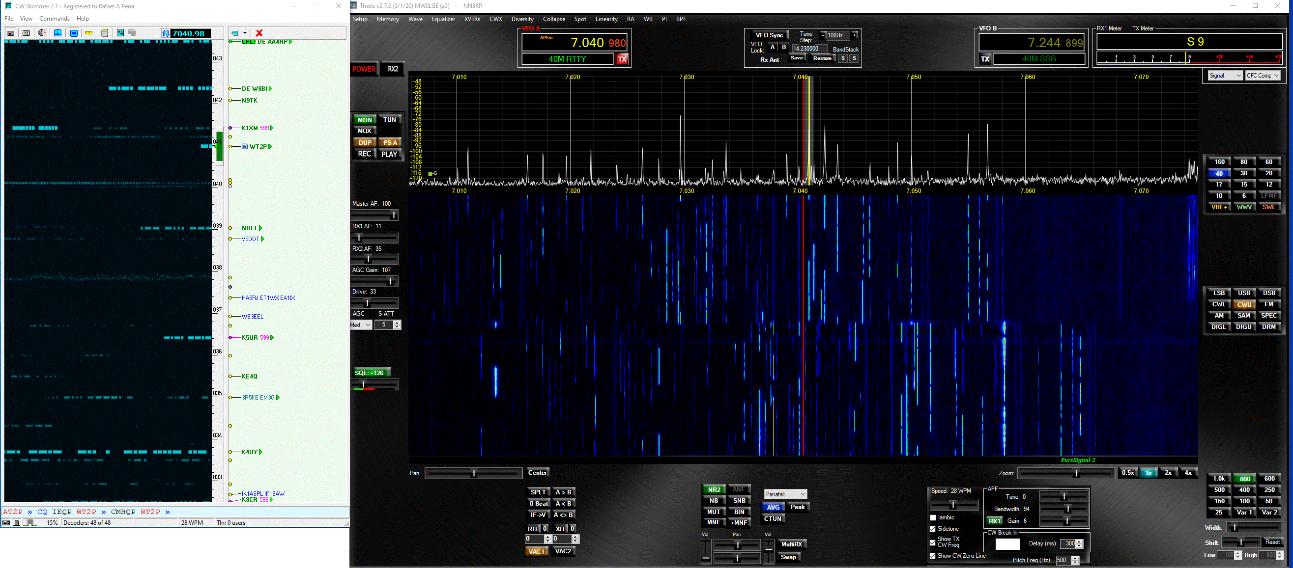

Hi Helmut 40M is busy for sure today:
Here is a pic:

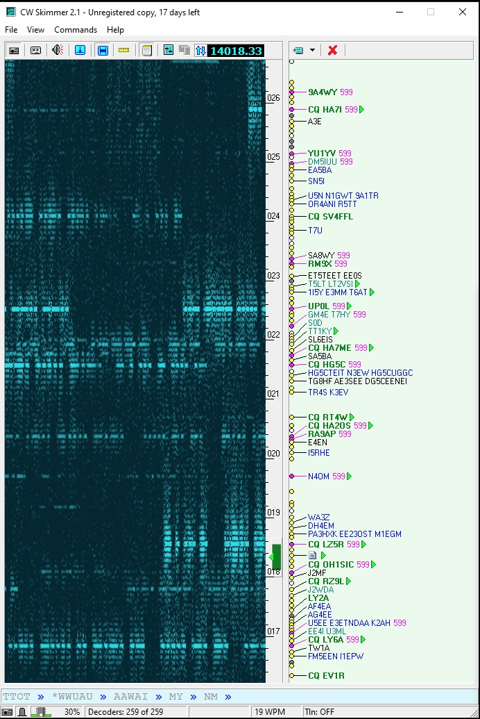

Posted: Sun Jan 16, 2022 12:13 pm
by OE3JRC
What could be the reason of these overshoots in CW Skimmer? It looks like IMD.
TNX and 73, Hans.
ANAN-7000DLE MkII black
Thetis 2.8.11
VAC4
