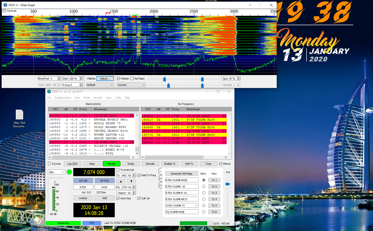

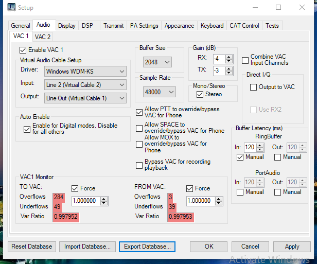

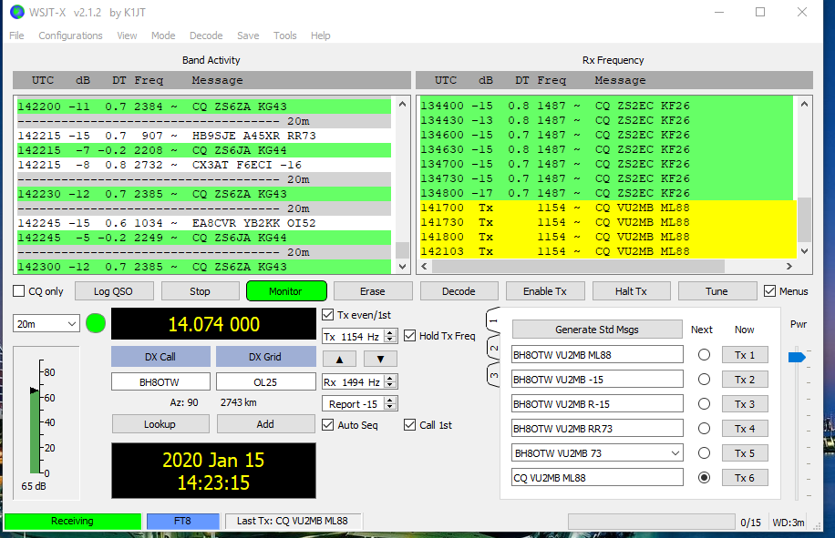

Hi
I am trying to work on JT-8 and I can receive the signals in 3Khz filter bandwidth.
I can call CQ and also double click on a cq calling ham and initiates a hand shake but..
No contact is made. I have attached the screenshots of Thetis Audio setup and also

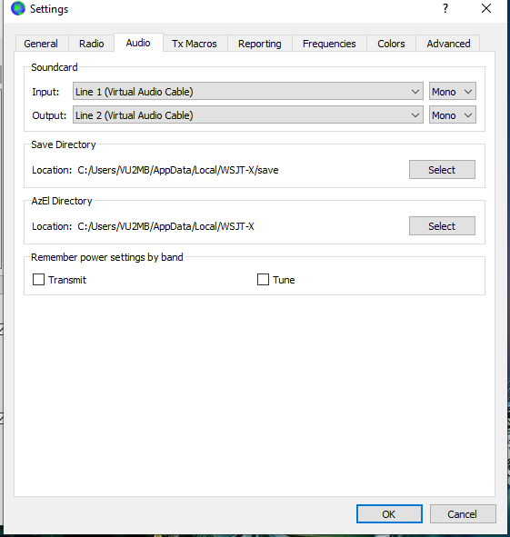

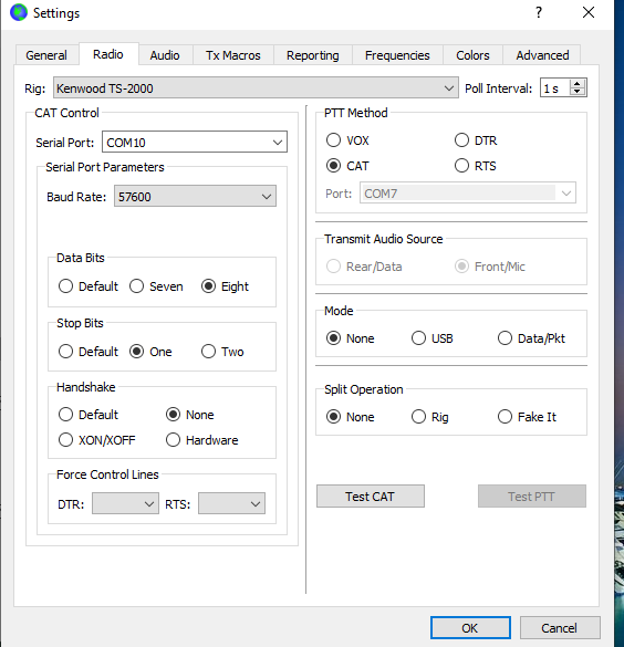

WSJT's settings. Only 3 attachments were allowed so remaining settings are as follows
WSJT-W Settings Audio
Input Line 1 VAC
Output Line 2 VAC
Please suggest what I am missing that QSO is not made on JT-8[attachment=0]WSJT Settings Radio.PNG
Thank you.
Bhanu
VU2MB

- WSJT Settings Radio.PNG (36.21 KiB) Viewed 21229 times
- WSJT Main window.PNG (1.38 MiB) Viewed 21229 times

Re: WSJT-W and Thetis 2.6.9 & DLE-8000
You can always post more attachments in a follow up post, however I have increased the maximum number of attachments to 10.
Change the buffer latency ringbuffer in setting back to automatic and tell us if that makes a difference.
RF is being transmitted, correct?

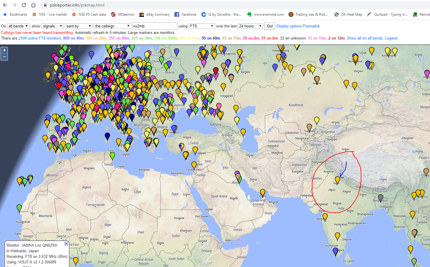

Hi
today I found a website that report status of users of various digital modes.
It is
https://pskreporter.info/pskmap.html
It say regarding my call sign the following
"Callsign has never been heard transmitting"
this website shows that I have been reporting 100's of station
heard at my end but no one is listening meeeee
There seems to be some error in the format otherwise
RF is going out for sure not only reported by power meters but
RSP1A's SDRUNO software as the received signal is visible on the panadapter.
My CQ is not decoded by WSJT-X running on that PC with RSP1A while it is decoding
other stations well.
My station is wihing the red circle on the attached screen shot.
How to get out of this and start using the mode?
Bhanu
VU2MB
Thanks Scott ...
Bhanu, Sorry for the issue. Interesting that your signal is not getting decoded. When you are transmitting do you see the TX display on Thetis? It should show a very tall rather thin profile and it should be shifting slightly left and right... its peak should be 0 db. Are you seeing this and is it 'acting' in this manner?
Also if you are using the Eugene M. VAC software pull up his 'help' panel - and confirm you are seeing a red TX line when transmitting... make sure that is the same 'cable' that you've assigned. I have seen a number of times when for some reason it gets out of sorts and although I have VAC cable 2 as my input to PSDR it shows on his panel as 5 or 6! I have to change it in PSDR to another one and then back again to get it to 'reset'.
I am interested in how this gets resolved - there are times when I swear my signal is at the intended station end and strong enough but for some reason is not being decoded...

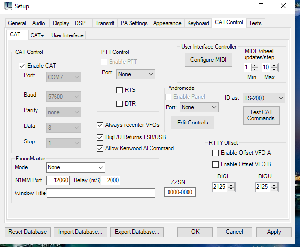

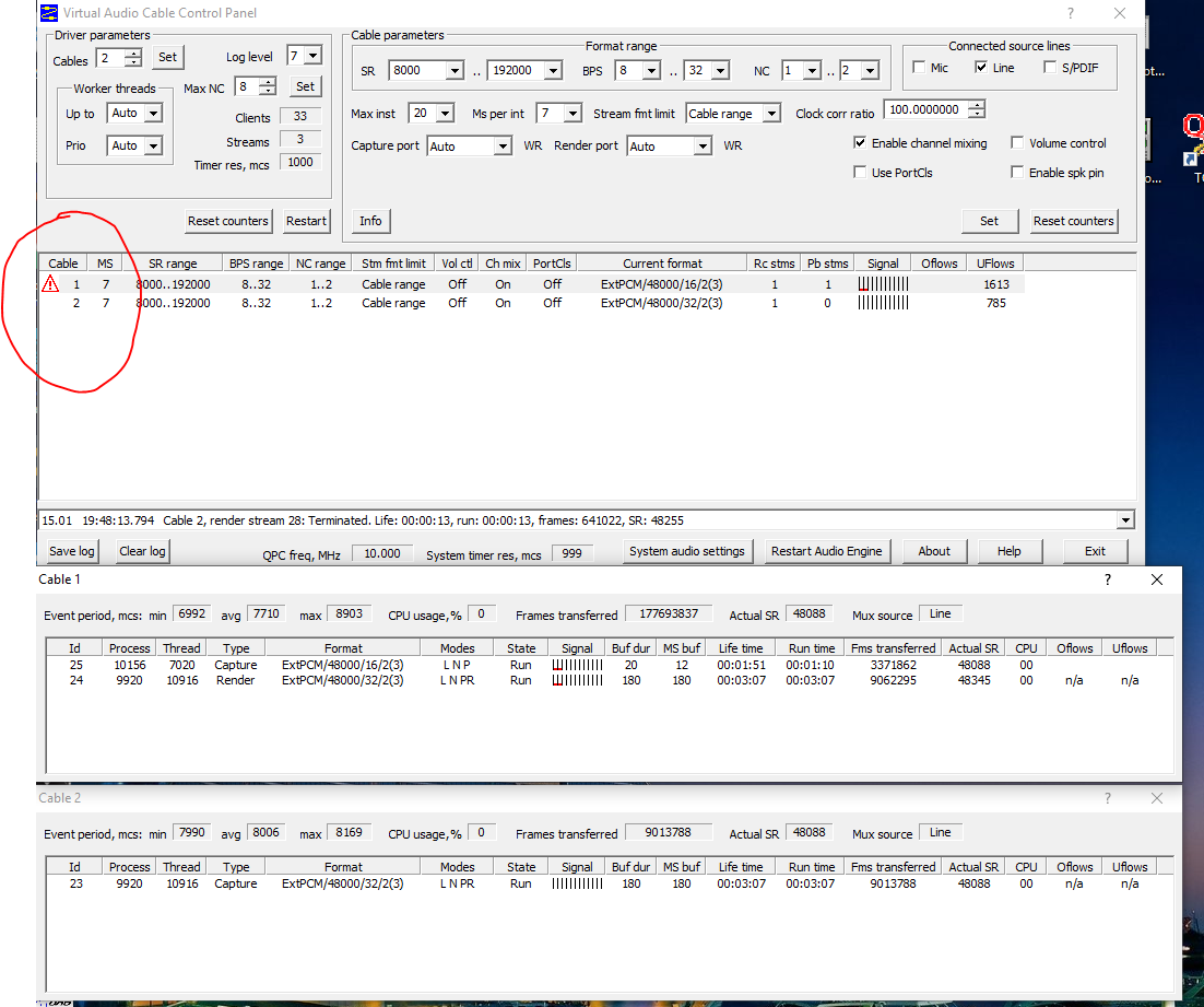

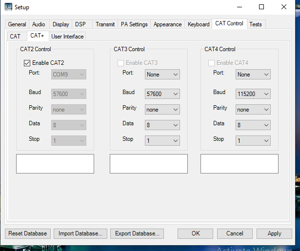

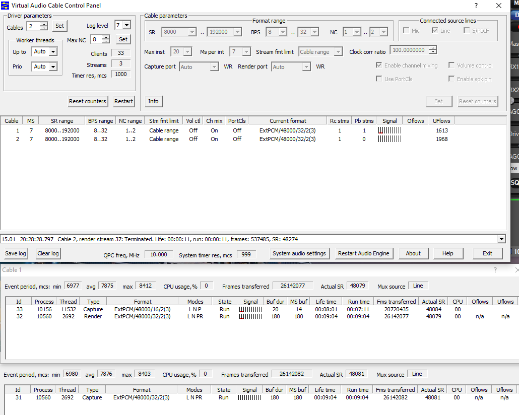

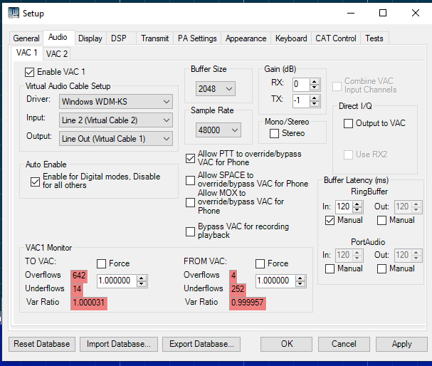

I feel this is something to do with VAC settings.
for Receiving its working but for transmitting it in not.
I just noticed that there is a red exclamation mark in a triangle in Cable 1
Screen shot attached
Other screen shots are attached too from Thetis and WSJT setups
K9RX wrote:How do you know its not just propagation? Or the station chose not to call you? Have you had zero success after many tries?
Also your TX power slider seems down a good bit - set the TX meter on Thetis to ALC and confirm the level is -1 (set it to this).Yes Sir, Zero Success
Now Vac red exclamation mark is gone but no hand shake yet between me and a dx. station
- VAC settings new.PNG (79.5 KiB) Viewed 21080 times
Finally cleared the mess.
and now I can do QSO's.
It was probably VAC induced noise in the transmitted signal
that was preventing me from enjoying the digi modes.
I sincerely thanks everyone for helping me out.
looking forward to meeting you on the air.
de vu2mb
Bhanu
