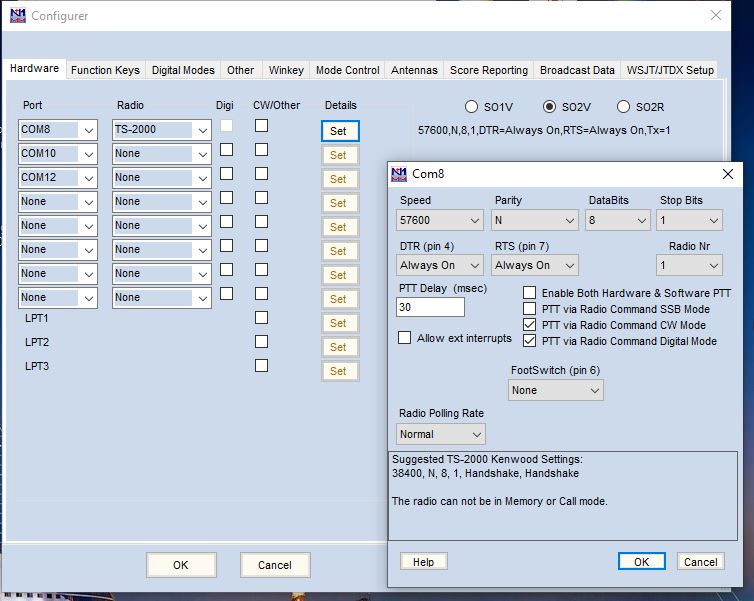

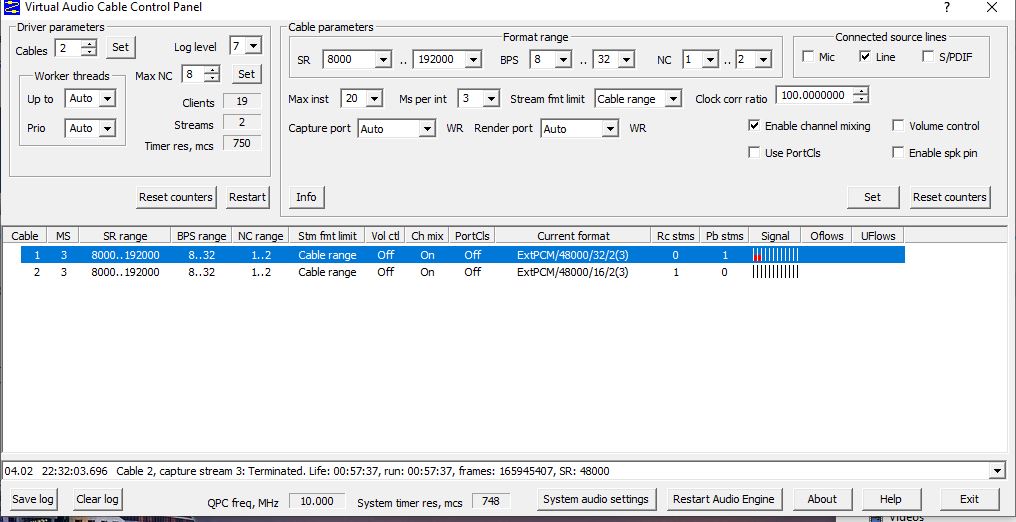

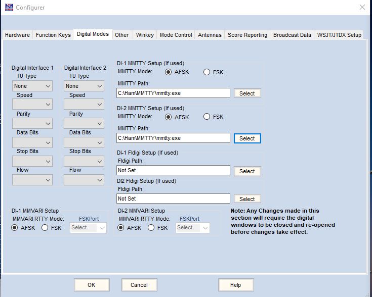

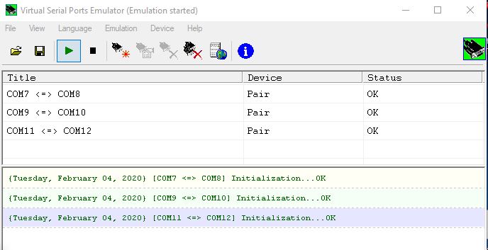

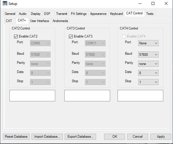

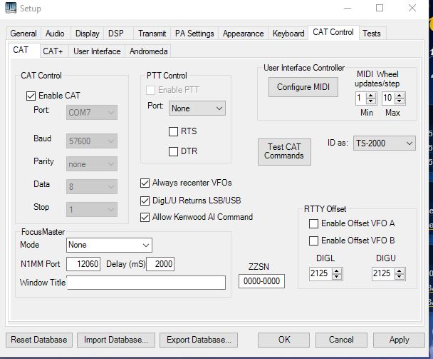

Hello friends,
I am running WSJT-X for FT8 successfully for last almost 3 weeks and made 2000 QSO's and 90 countries confirmed while worked 105.
I would like to work on RTTY which I used to play during 90's using PK232MBX. Would love to take part in the upcoming CQ WW RTTY WPX Contest on Feb 8th and 9th to begin with.
Can Scot or some one guide me please setting up N1MM / Thetis and MMTTY.
I was earlier using N1MM plus for ssb logging so port are setup for that.
VSP and VAC are configured as pictured.
Any help is much appreciated.
Bhanu
VU2MB

Re: Thetis, N1mm plus and MMTTY for RTTY setup
All Done .
It took me some time as I was stuck with some unnecessary settings in MMTTY
CU in the contest.
Bhanu
VU2MB
CU in the contest.
Bhanu
VU2MB
What does the RTTY Offset supposed to do? I can't seem to get it to make any difference at all.
It looks like it should offset the VFO so that I could set the VFO to a spot frequency and be where the spotted station
is.
I set VFO Offset A to on.
and put 2125 in DIGL. Nothing changes in RTTY mode.
Using N1MM+ and MMTTY and Thetis 2.7.0
Tom AA4VV
is.
Tom AA4VV
