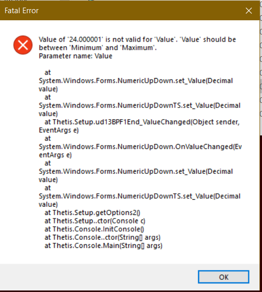

Dear All , I'm using ANAN200D with NP protocol V 1.8 my system is WIN 10 w 32GB memory
Thetis 2.6.8 works really fine without any significant bugs
Tried to load Thetis_v2.6.9_setup_25jan20.msi
The software once installed crashes after loading the configuration with the message
FATAL ERROR X Value of '24.00001' is not valid for 'Value' should be between 'Minimum' and 'Maximum'
see attachment png file
Tried three times with rebooting system etc.. getting same reults every time
only thing I did not try is to erase all my settings
Then I uninstalled using Win10 settings / apps /uninstall and reinstalled Thetis Ver 2.6.8 and all worked as before with my settings automaticlally restored
Any solution in sight ?
Thanks for the advice
Pierre F6IES

have you ever removed the entire database folder?
If not, I would do that first.
