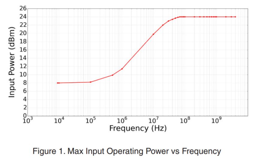

After some research and correspondence with Mini-Circuits engineers, Figure 1 in the latest step attenuator (Mini-Circuits DAT-31A-SP+) data sheet was identified as showing both the 0.2dB compression point vs. frequency as well as being the maximum safe input level vs. frequency for the step attenuator. Mini-Circuits further advised that this data is valid for both the older and now obsolete DAT-31-SP+. Figure 1 is attached.
As the figure shows, the curve at 1.85MHz gives approx. +13dBm as the max. allowable, 0.2dB compression point input signal level to the step attenuator.
Under Paul's test conditions, at 1KW the output of the coupler would be 60dBm - 50dB, i.e. 10dBm. This is 3dB less than the equivalent point on Figure 1, therefore it does not seem reasonable that there should be a problem at this input power level.

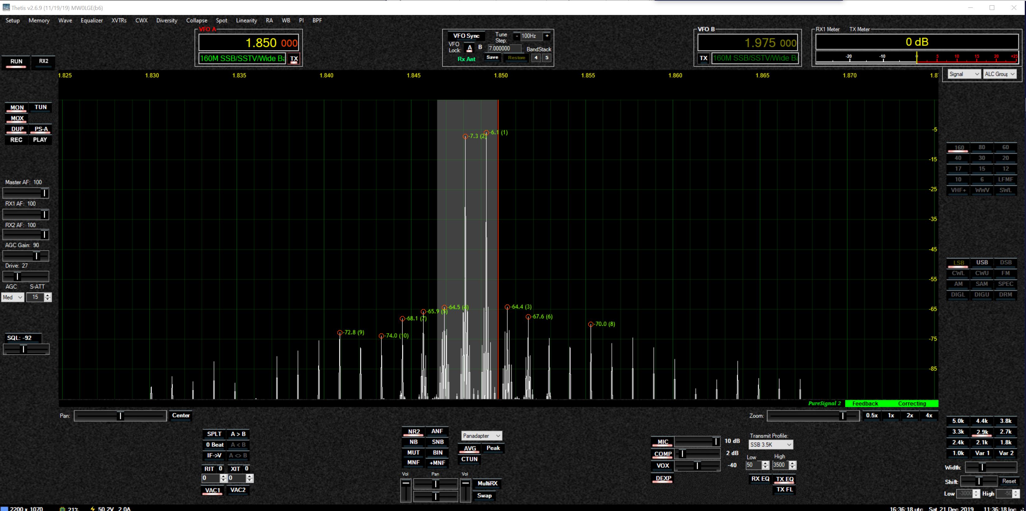

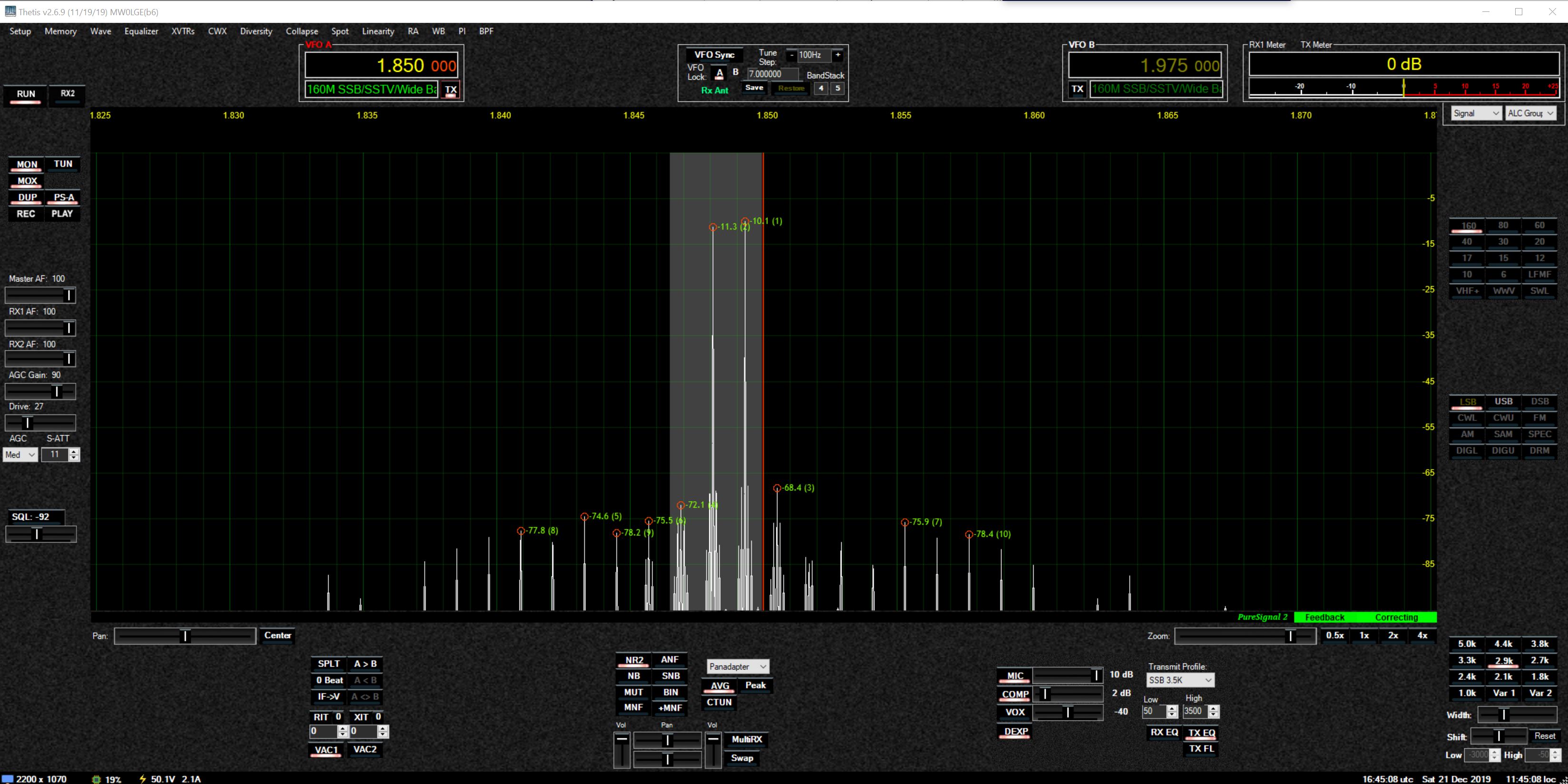

At 500W, i.e. 57dBm, the output of the coupler is 57dBm - 47dB, i.e. 10dBm, which is exactly commensurate with the level Paul was achieving. And, as with Paul's example, the step attenuator value arrived at via the auto attenuation algorithm confirmed the 47dB coupling factor.

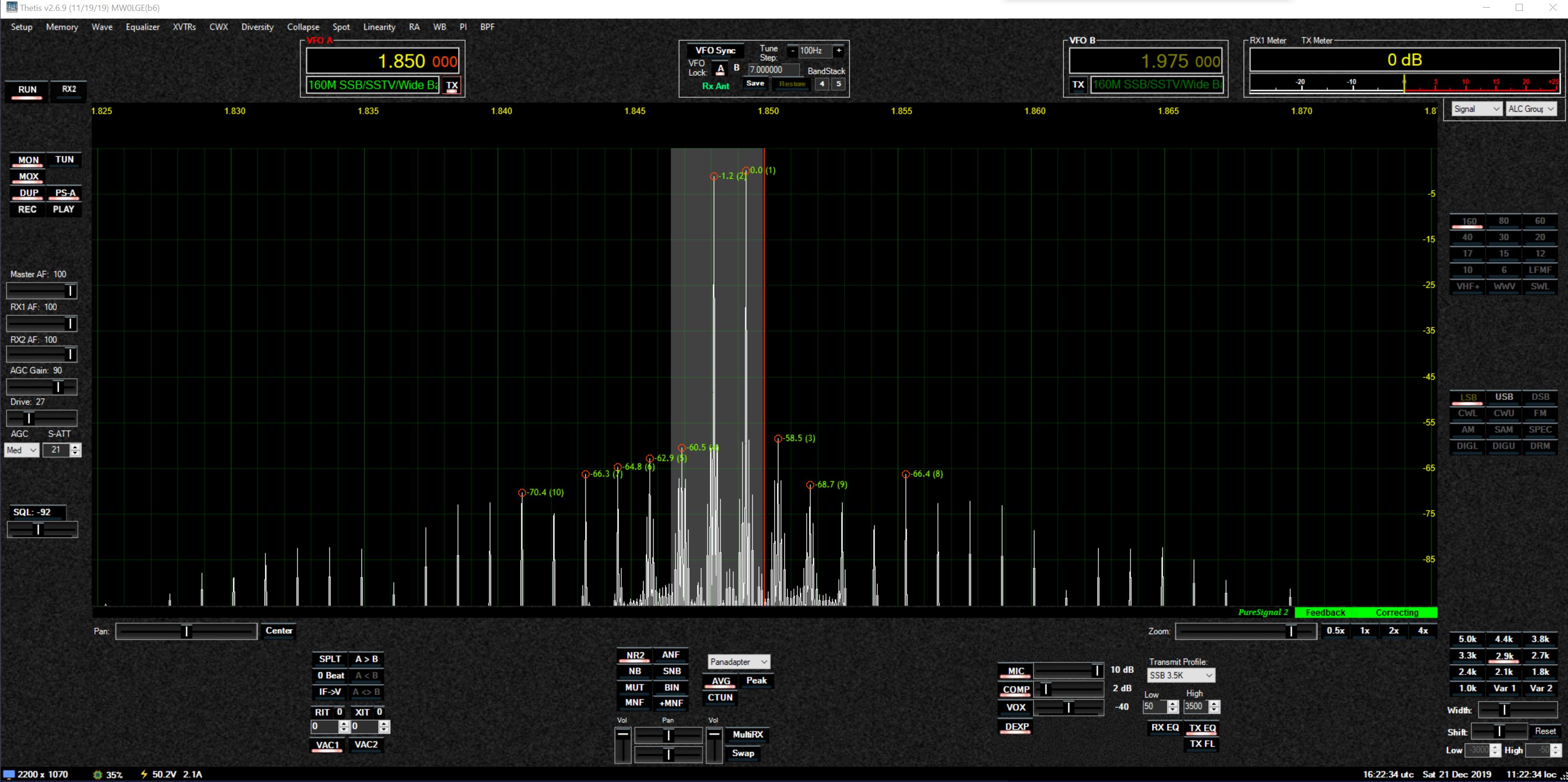

However, under these conditions the achieved PureSignal linearization performance was quite good, as shown in the attached file "0dB atten warm.JPG". I repeated these measurements with an additional 6 and 10dB of attenuation (results attached) provided by inserting a JFW rotary adjustable attenuator inline. Step attenuation values changed by the proper amount of dB each time. There was no significant difference in performance at any of the three feedback signal levels as measured by the "DUP" display mode on the radio.
Note that the word "warm" appears in the filenames as it was necessary to allow the amplifier to warm for 20 to 30 seconds in order to remove thermally related memory effects. I.e. the FETs in the KPA-500 need to obtain a reasonably stable thermal state to get good, consistent results. This issue should not be overlooked with other amplifiers or other testing. It is important to have a good dummy load that can absorb the necessary power for the necessary amount of time!

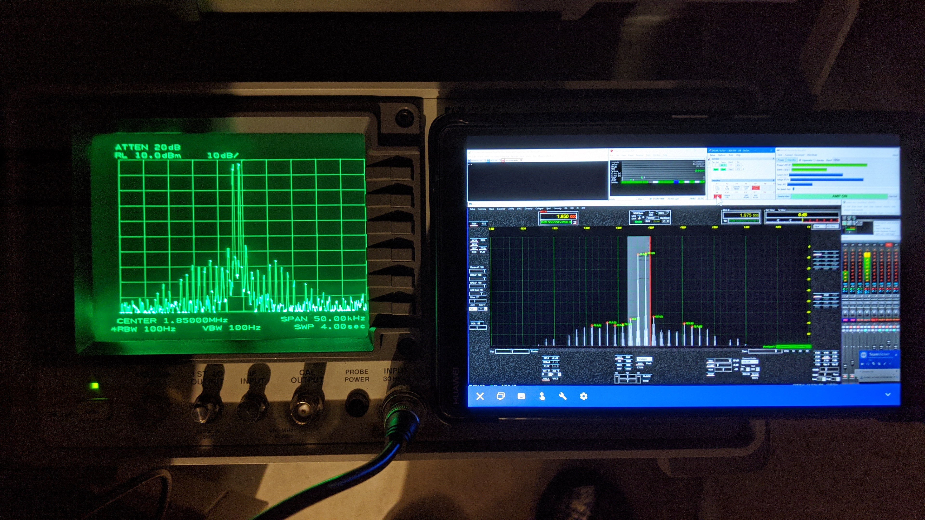

Paul further proposed that the DUP display of the radio could not be trusted to provide proper results. This assertion is also not consistent with my results. Using an HP 8560 spectrum analyzer on the second forward output port of the AC2IQ coupler, and a tablet mirroring my main station computer display, one can see the results are quite comparable (photo attached). Note that the 8560 is using an un-attenuated output with levels exactly as you would expect (each tone 3dB down from the 10dBm total power output level) while the radio was still seeing an additional 10dB of attenuation. Also, I did not bother to match up the resolution bandwidths of the two measurement systems. No doubt had I bothered to match levels and match measurement settings the two displays would most likely match almost exactly. Regardless, there are no gross differences between the measurements, and no reason to distrust the DUP display mode of the radio. Indeed, the radio is probably a superior instrument compared to a nearly 25 year old spectrum analyzer!

My DUP display does track with the S/A until the non-linearity occurs and PureSignal can no longer linearize. You have not yet reached a point of non-linearity with the HP measurement. As such, I would expect your result.

Concerning the MCL DAT-31A-SP+ datasheet and the "Figure 1" graph, what I believe is shown (and suggested by Don Jackson, W5QN) is the maximum safe input level. It does not mean that the device isn't going non-linear to some small degree at levels below the curve.
It would be interesting to conduct some out of circuit testing of the DAT-31A-SP+. I'm not motivated to do that level of testing at this time. Frankly, MCL should provide more detailed analysis of input power by frequency vs. IMD products on their datasheet.

"As the figure shows, the curve at 1.85MHz gives approx. +13dBm as the max. allowable, 0.2dB compression point input signal level to the step attenuator...Under Paul's test conditions, at 1KW the output of the coupler would be 60dBm - 50dB, i.e. 10dBm. This is 3dB less than the equivalent point on Figure 1, therefore it does not seem reasonable that there should be a problem at this input power level."

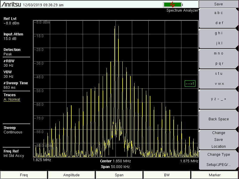

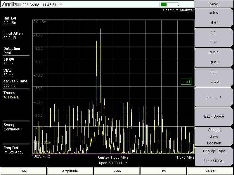

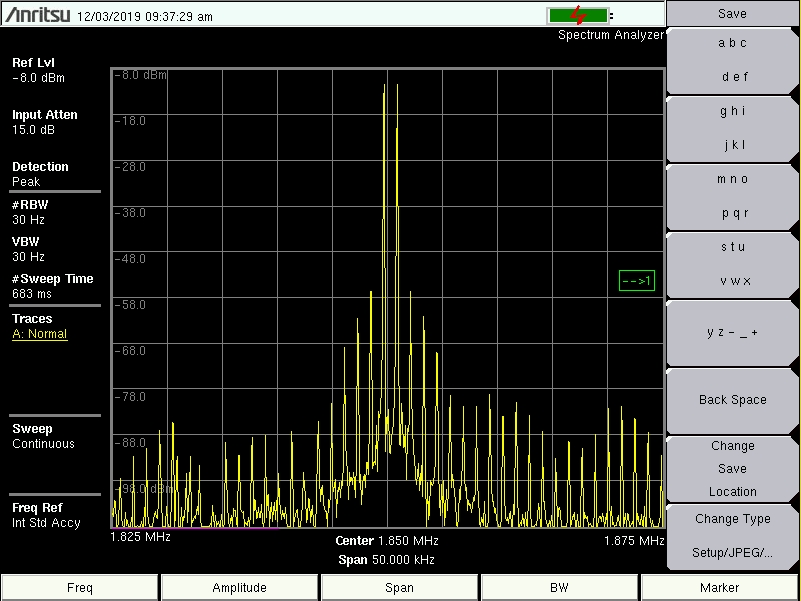

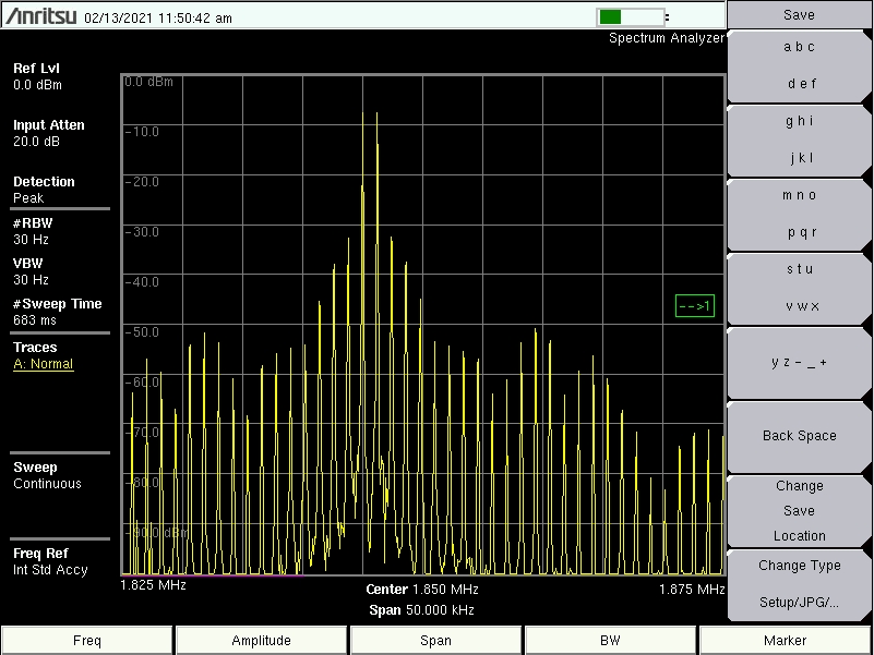

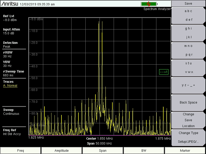

While making some station wiring changes, I ran across the root cause of the 160m IMD disparity. Have a look at the attached screen captures from my Anritsu S/A. As before, the measurement is taken from a Bird inductive coupling loop at the input of a Bird TermaLine load.

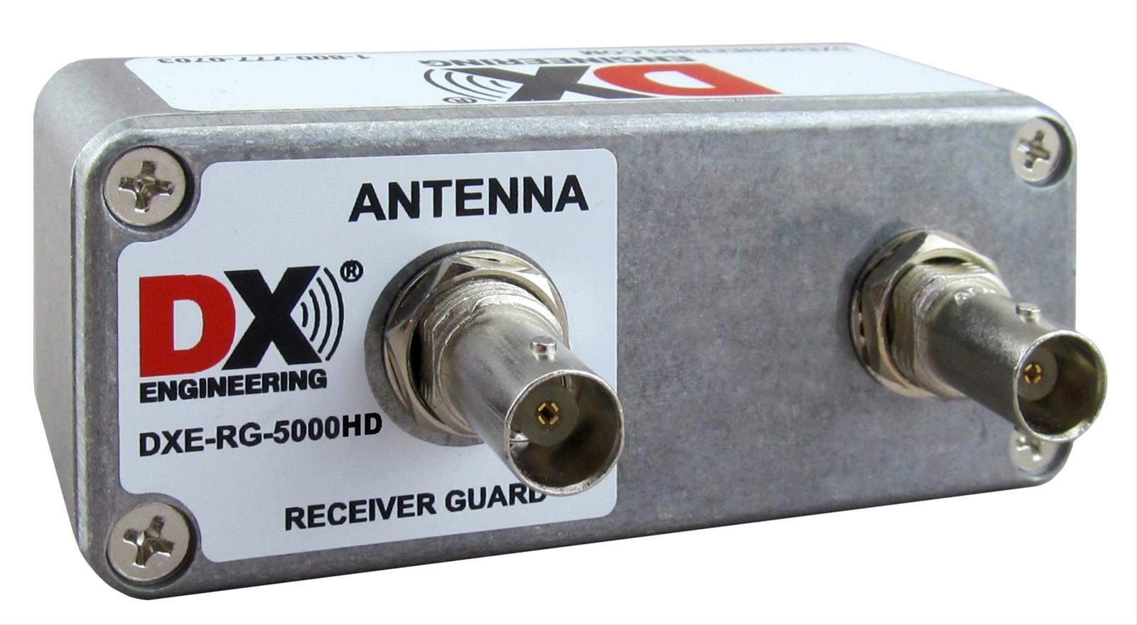

I don't know when, but at some point I purchased a DX Engineering RG5000HD receiver guard and placed it in-line with the PS RF sample. When I began pulling cables today, I discovered it under the desktop. I don't even recall purchasing it or installing it but there it is.
Note that in my earlier measurements, I used a Weinschel programmable step attenuator with 1.0 dB steps to verify sample line insertion loss (IL). Well, the loss of the RG goes undetected because it's spec'ed at 0.15 dB (50 MHz). ARRL measured IL of only 0.01 dB at 1.8 MHz.
But DXE further states:
"The Receiver Guard is an advanced multi-stage receive signal limiting device that is virtually RF transparent at normal receiving levels, all the way up to -10 dBm,..With the Receiver Guard installed, when RF signal levels on the receive antenna line rise above the -10 dBm level, the specially designed circuit limits the output signal..."
However, have a look at the power limit chart in the QST review. The -10 dBm threshold is for the standard, non HD version. The same chart shows a soft knee with the onset of nonlinearity at about +5 dBm for the HD version I have. The chart is not frequency specific but the ARRL Lab does show additional limiting detail by frequency in Table 10.
The screen captures below show my Alpha 77Dx tube amp, tuned to 160m at 1500W output but I didn't optimize linearity. I simply adjusted plate loading for a typical condition where peak power is found then loading is advanced slightly with a reduction of grid current. I wanted to conduct the test in a way that I normally use the amp after a quick band change -- not where I am extracting the "nth degree" of linearity from the PA tuning adjustments.
A 50 DB coupling coefficient is used for both measurements. The only change between the two screen captures is that I bypassed the RG with a BNC barrel. I verified identical results with my capacitive divider and toroid samplers.
So, what does this mean? It means that I am revising my claim that a coupling coefficient of 50 dB is adequate when NOT using a receiver guard or any other device that may affect linearity in the sampled signal path. It also brings into question whether DXE's standard RG device (i.e, non HD version) should even be used with PS.
My measurements do show that with a coupling coefficient of 56 dB, the RG HD is transparent at 1500W from 160m through 6m. I suggest this level of coupling when used with the RG HD device.
I do apologize to Scott and others for not taking a deeper look into the sample line. I should have eye-witnessed the entire sample cable from end-to-end. It got missed due to the very low IL of the RG.
