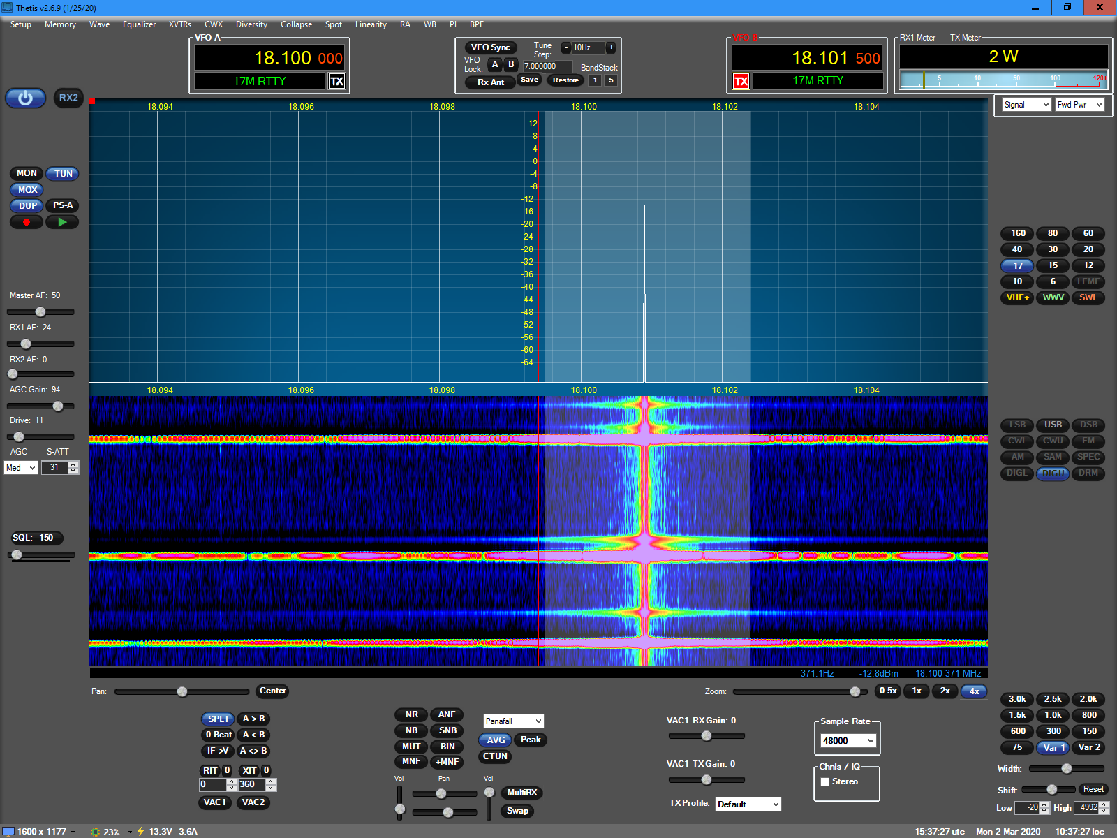

Glitches in TUNE signal viewed with Duplex on
Have a 7000DLE MKII with 2.0b Protocol 2 firmware and 2.6.9 Thetis.
Making contacts with WSJT-X using VAC and seeing horizontal wide glitches in my transmitted signal (Duplex ON). I thought it was a VAC problem but it persisted with VAC (Eugene) and VB-Cables.
I assumed it was a VAC cable problem but to my surprise when I turn off VAC and use the TUNE button in Thetis I see the same thing:
What might be the cause of this?

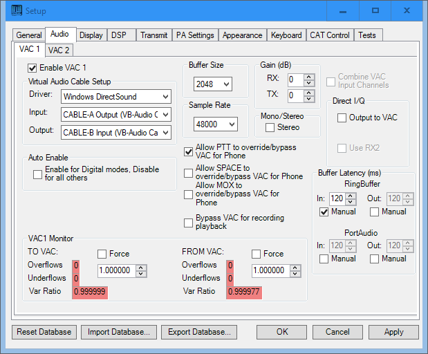

Re: Glitches in TUNE signal viewed with Duplex on
Mike,
At this very moment, I am using WSJT-X and so I have the VAC turned back on again. SO:
What is the significance of these audio settings when the VAC audio is OFF and the problem still occurs. There must be something I don't understand if the disabled audio settings make a difference.
Thanks for persevering,
Jamie, W2QO
Jamie, W2QO
The buffer latency could have some effect.
Two things....turn on the "Force" boxes and try Manual for the latency boxes.

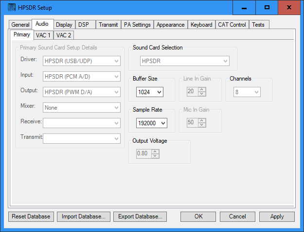

Hi Mike
In Protocol 1, under the Audio Tab, there was Primary, VAC 1 and VAC 2. Primary looked to be some kind of sound card equivalent:
I'm guessing the Protocol 2 equivalent of the Primary Audio is what the TUNE signal travels over and that if there's an audio problem as you are suggesting then the Primary Audio is where the problem would be and not the disabled Vac 1 settings. But I am only guessing.
Thanks again,
Jamie, W2QO
