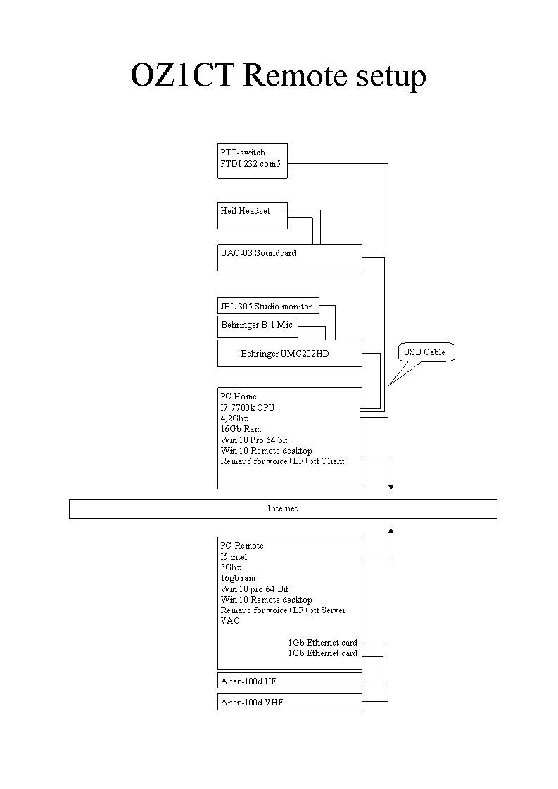

here is a picture how my setup is made:

as I write the setup run ok whit the 5$ soundcard UAC-3 no problem but when I use Bheringer UMC202HD + B-1 mic I can start a qso and afeter 2-3 tx periode it sound "cracking" and then I can transmit 1 more time and it is bad agn....

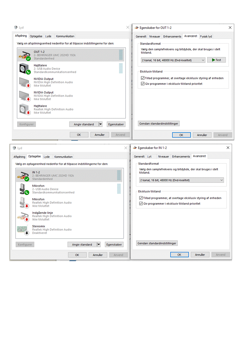

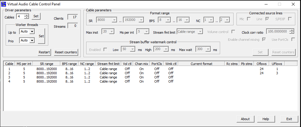

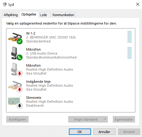

ok here is some screen shot:

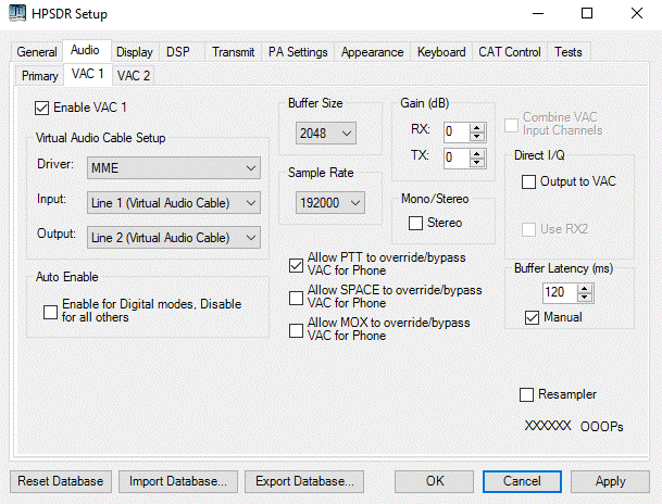

HPSDR VAC1:

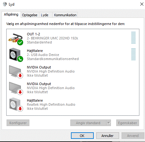

win10 sound settings at my home pc:

Re: Behringer umc202hd mono microphone ???
Sorry Ben, but you did not show the Windows Sound Control Panel advanced settings, the tab that shows the channels and sample rates on each VAC and UMC device.
Also need to see your remaud settings.
I'm assuming that PowerSDR is running on the PC that is local to the ANAN hardware.
Where I'm going with this is that you want to set ALL audio devices EVERYWHERE in the chain to 16 bit, 48KHz. Number of channels doesn't matter so much.

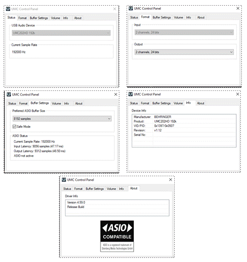

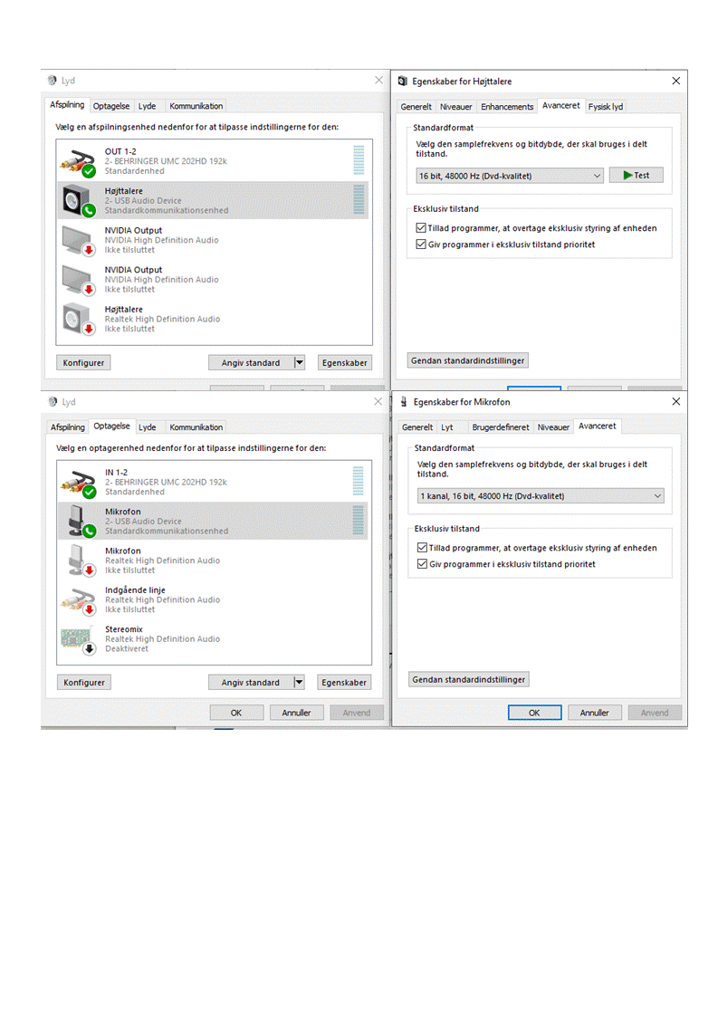

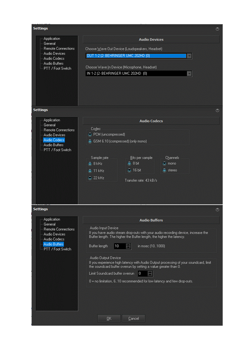

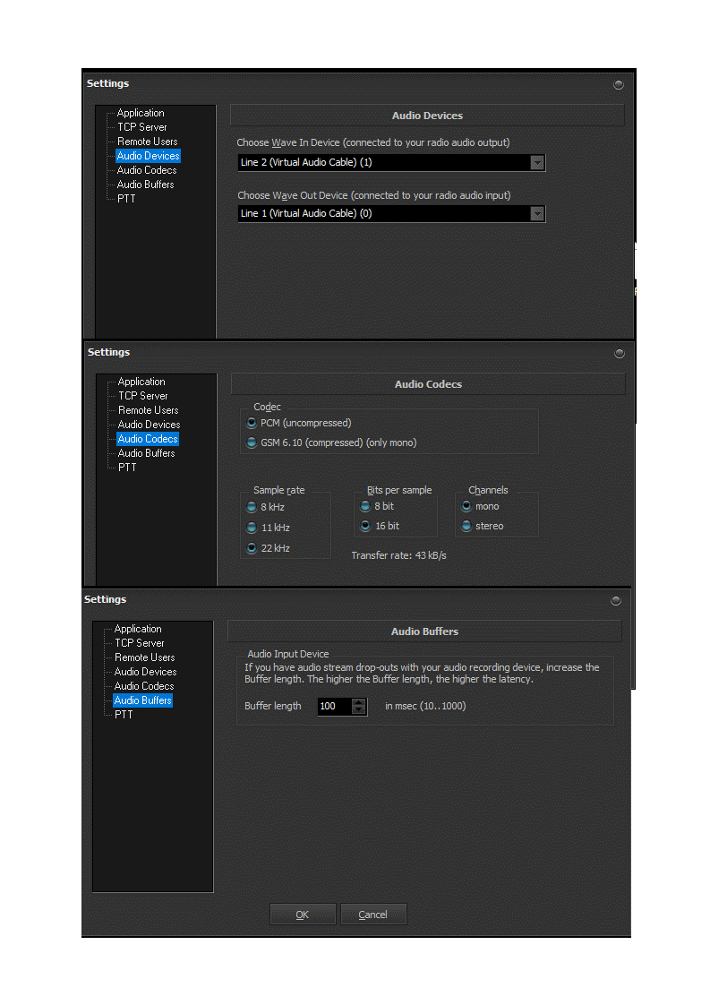

here som more screendumps
the UAC-03 setup
Behringer setup
Reamaud settings Server & Client

Posts: 6109
Most but not all of that looks to be at 16 bit, 48KHz. Get it ALL running at that rate. Set everything to stereo (don't worry that you don't have more than one channel coming out of the Behringer). And try 8KHz on RemAud because it is a nice multiple of 48KHz.
That should help. After that it's just going to be experimenting with buffer sizes.

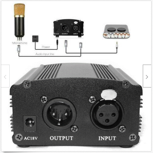

Today I got from ebay a 48v Phantom PSU and I connected my Behringer B-1 to the PSU and then a cable in to the MIC input at my PC'motherboard....now it is running whit no error
