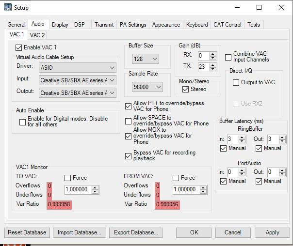

I've used for several months a SoundBaster Z and right now I'm using a SoundBlaster AE-5.
With Creative's ASIO drivers I can achieve very low latencies and just a few over/underflows from and to VAC (not audible).
My settings are as follows:
I've never tried an USB sound interface, but my experience with SoundBlasters is great!
EDIT: Using a PC with an AMD 3700X 8 cores/16 threads processor and 16Gb of RAM at 3600MHz (powerfull enough to run Thetis at just 4-5% CPU use).

And that's a nice demonstration of the kind of settings you can get down to with high performance audio hardware (USB or PCIE), ASIO drivers, and careful tuning. A buffer of 128 samples at 96KHz is only 1.3ms long. And the ringbuffers at 3ms is very good.

I received my Sound Blaster AE-9 card in record time from the seller. I'm still working with the settings and this is what I have presently. Image
I'm hoping I can find something that I can do that will give me the ability to get the RingBuffer timings lower. You have to love Windows 10. Before I lost the SSD Drive I was able to get these same settings with the RingBuffer down to the 3ms range. This was using a Behringer UMC202HD. I had to do a clean install on a new drive. I loaded all the drivers as I had previously. I'm sure I had the new install set the same because I kept detailed notes from the previous install. I can't remember everything so good notes is a plus. With the new install of Windows 10, Thetis 2.7.0 a3, and all the relevant drivers I have had a difficult time even getting close to my previous Sample rates and Buffer settings. I'm not sure what the difference is. These settings now are not too bad at all with the new sound card. It is a challenge to squeeze the few more milli-seconds out of the setup. I'm still reading and working with it and I will update this post if I gain any improvements. :D

That's not bad performance. I'm also running a buffer of 128 at 96KHz, and the best I could do for Buffer Latency is 5 in and 8 out for a completely stable setup.
