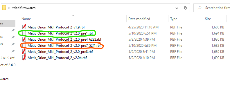

OK it looks like we found one that works.
Pre 1 appears to be working
Pre 7 worked but every time I would key there would be a errors
All the others did not work.
Is it normal for everyone to be running different version of firmware? If this old version works ok for me at this time--when if ever, do I upgrade to something newer?

Re: Problems With PS in Thetis (Attched Video)
Larry,
At this time it is pretty much the way it is across the board with all the different ANAN hardware using the P2 platform. It's my understanding that the assortment of firmware versions you see out there for your 7000 are compiled with slightly different thermal compensation and timing settings to address the slight variations in all the FPGAs that are out there. What works optimally with one rig might not work optimally with another. I believe that most people with the 7000/8000 series are using either pre-1 or pre-2 with good success.
I have heard that this is largely due to the opensource commitment that the firmware developers use Quartus Lite, the somewhat limited free version of the firmware development software, rather than the expensive Pro or Standard versions that are used commercially.
The shotgun approach seems to be working for pretty much everyone out there but it's a lot of work for the firmware guys! Glad you are up and running well.
