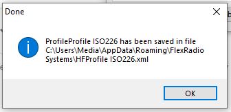

The profiles do not necessarily have to be visible in the program directory or in "\Roaming\FlexRadio Systems" folder.
The TX profiles are always saved in the database. They are only visible in the "\Roaming\FlexRadio Systems" folder after they have been exported.
tx profile export.JPG (17.35 KiB) Viewed 5571 times
Have you tried to export one of those "missing" profiles?
I always export my TX profiles, and copy them from \Roaming\Flexradio Systems to a safe place, just in case the database gets corrupted.
