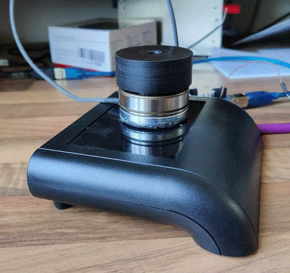

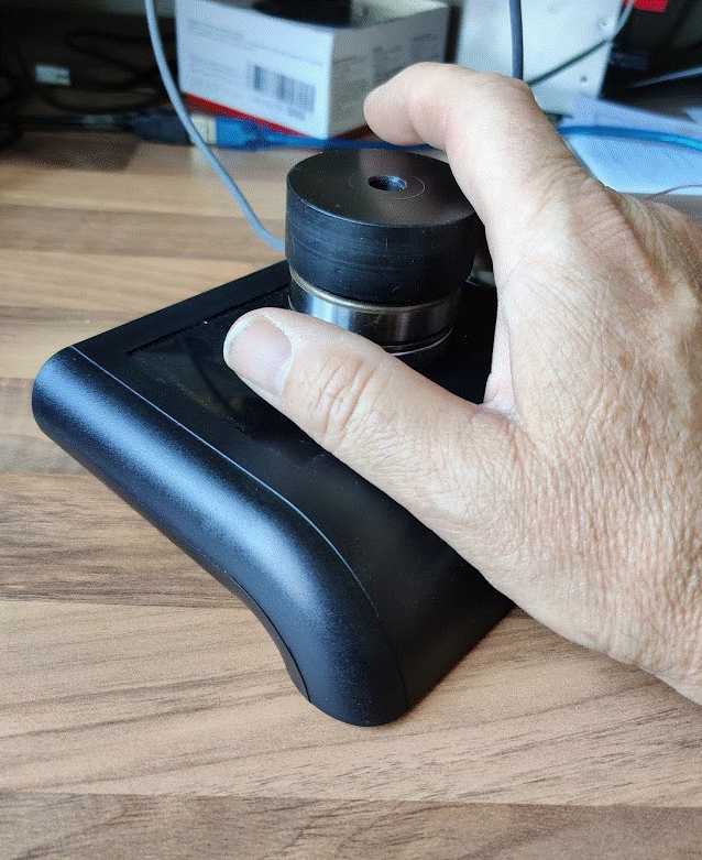

Re: RX1 AF: CAT command????
Hi All
Just what I need for my Cat-controller.... I am runnig it on a small Arduino Micro board....
hare is a picture where the SKF-ball bering encoder and enclosure will be put together
- in the mittel of wheel a switch to press when AF is adjust.
- cat2.gif (197.15 KiB) Viewed 6477 times
- have to cut a hole in topcover, so only knop is out.
- cat1.gif (288.59 KiB) Viewed 6477 times
