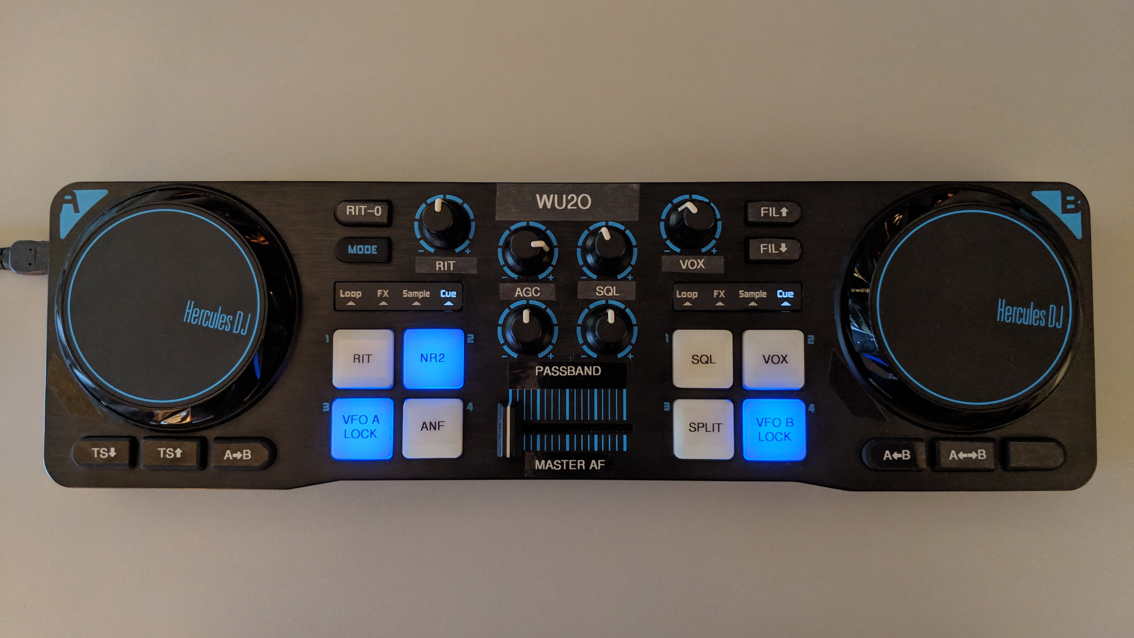

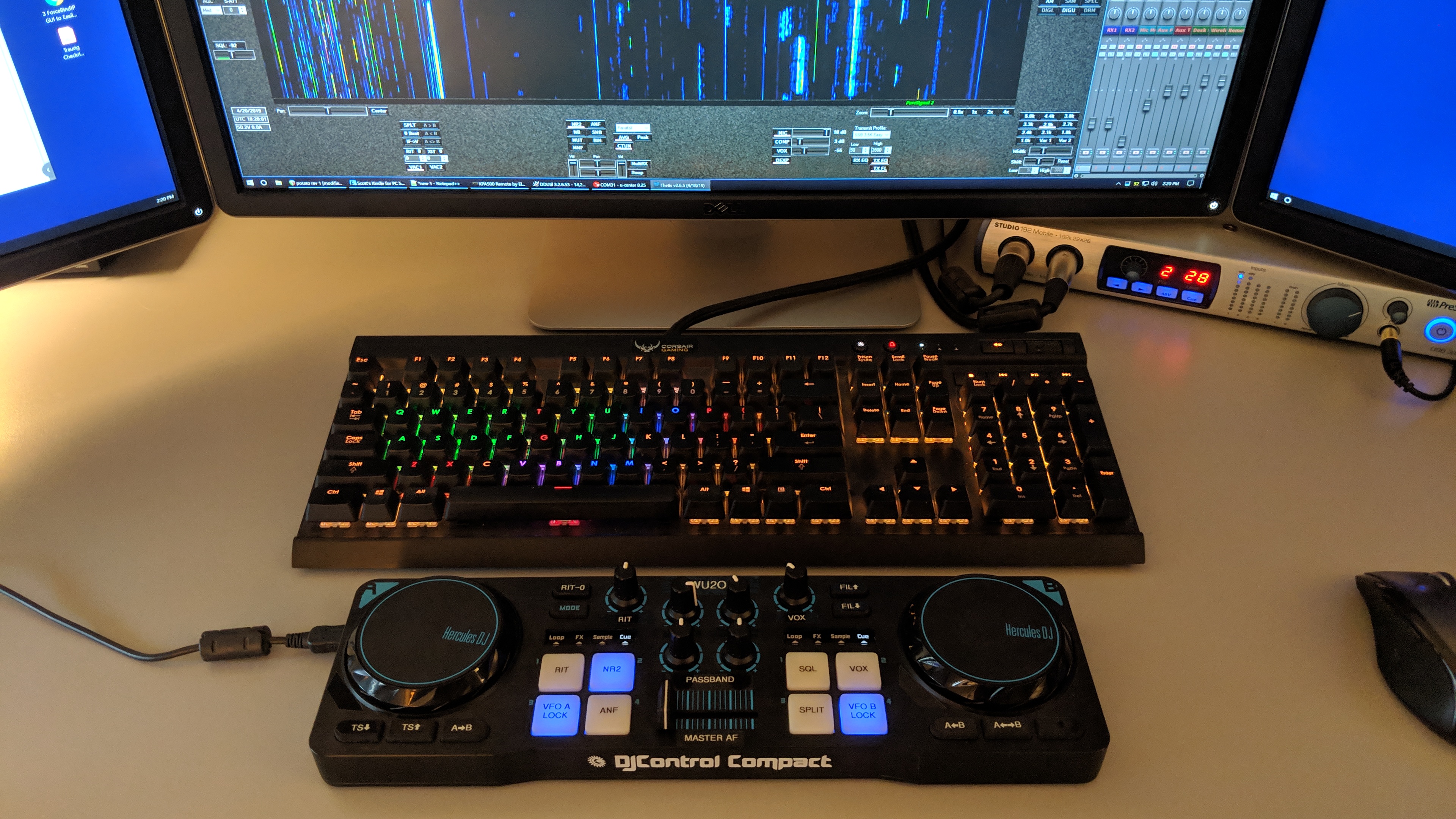

It's really a very personal choice. The Hercules don't have multi-speed jog wheels AFAIK (neither of the ones I had/have do). What I did was sit down with a printed image of the controllers I was thinking about and penciled in the controls I wanted to support, playing with the layout until I thought I had something that would work for me. Ultimately I realized I did not need/want very many MIDI-fied controls and went with the relatively small and simple Hercules DJ Control Compact. It did everything I wanted and is small enough to push underneath my monitors when I'm not using it (most of the time I just use the mouse).

Thanks. So mapping the functions is a wash between the models really, they’ll just work.

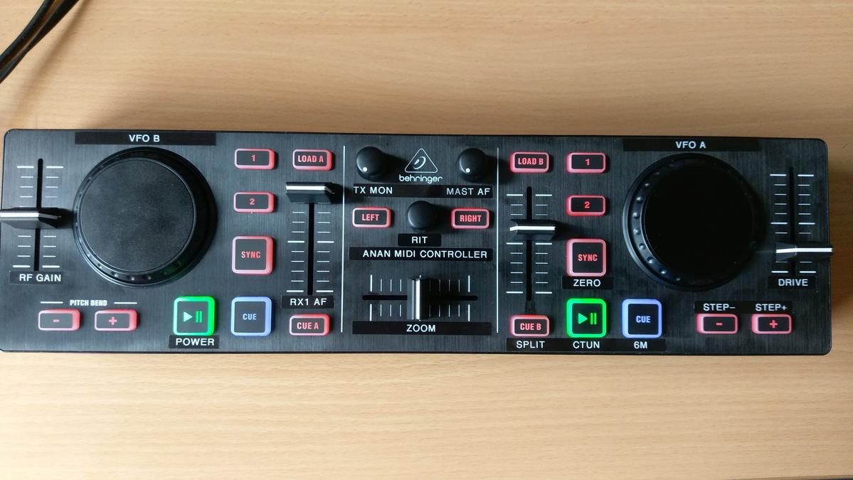

Here's mine with more knobs and sliders
HI Scott, good afternoon - Does this controller work with Thetis 2.6.9?

The controllers work with both PowerSDR and Thetis, and support for them goes back many versions so 2.6.9 is perfectly fine.

Has Hercules Starlight Compact which seems very similar to your controler been successfully used for this task ?
I can get one for a good price and would like to test it.
Which labeling system did you use ?

Phil,
I'm not aware of anyone having tried that one, but it sure looks promising.
I used a Brother P-Touch with a combination of white-on-black and black-on-clear tapes. I used leftover black tape to cover original markings that I didn't want to show.
