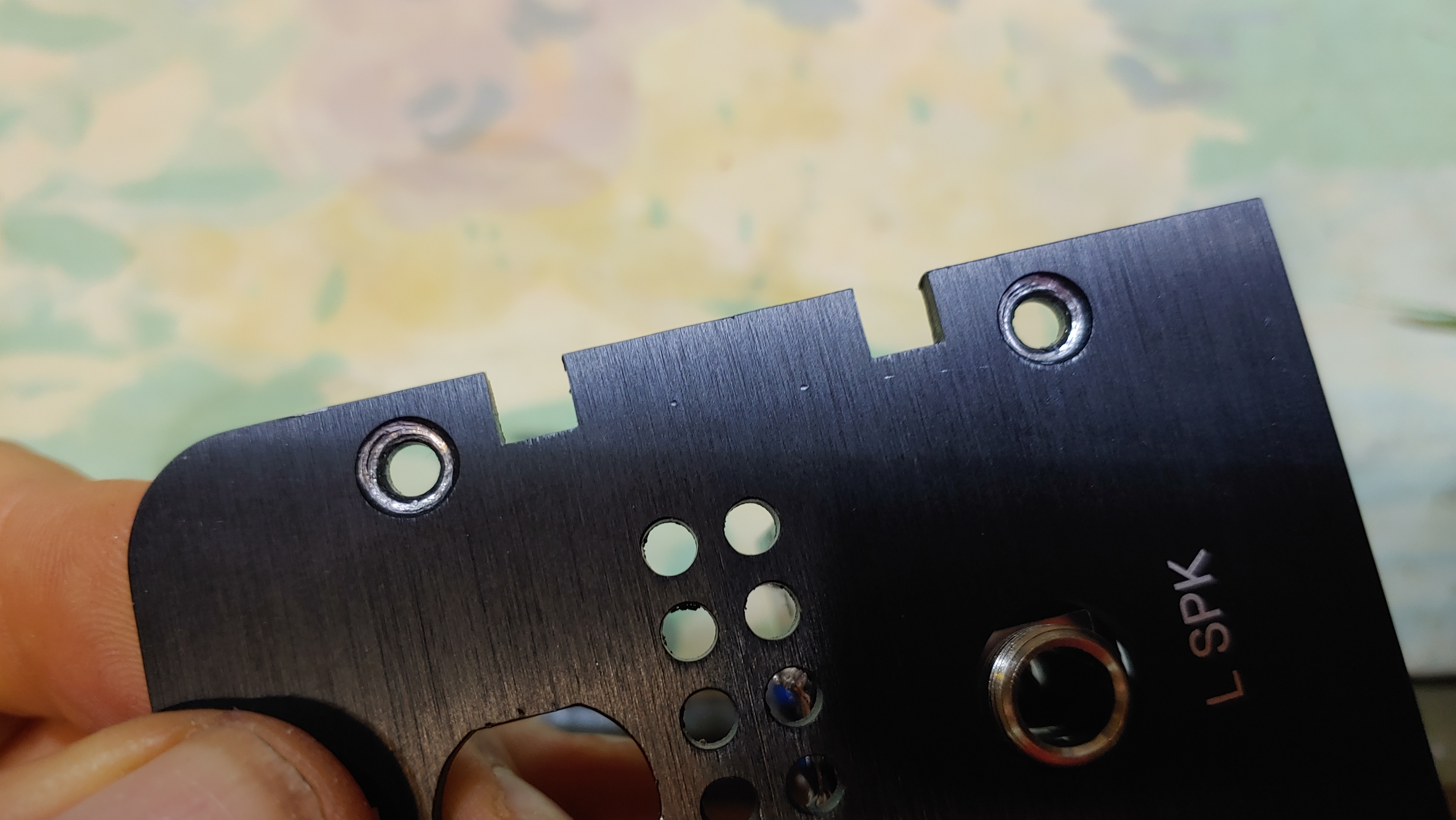

1. First, remove all the case screws front and back. Take a drill bit that is slightly smaller than the conical countersink hole and
with your hand rotate the bit to take off the black paint in the hole. Some aluminum may come off too..it's OK. Go slow.

6. Speaker out treatment: See the picture below. I added two .01uf caps as RF bypasses . One from each hot lead of the balanced audio output to ground. then I took the connector shell lead from both outputs and bonded them together. That lead then went into the radio and I connected it under the closest nut on one of the fan mounts. I used a lug on the fan side wire connection. This picture was before I added the connection wire that goes to the fan nut. Make it 4-5 " so you can get the panel off easily later. Solder it to either green wire.
[img][/img]
That's it! Now you can use two conductor shielded speaker wire with the two hot pins (Ring & Tip) going to the speaker and the outer ground connection from the sleeve protecting the leads from RF intrusion. And RF that does get in will be grounded by the Bypass caps.

I received my 7000DLE MKII Black back in April. When I checked the connectors in the rear I found all of them finger tight, at best. One was really loose. I tightened all of them and checked all to ground and found that they all were showing good ground except the two speaker nuts. I don't use them so didn't look any further into that and have not had any RF issues with anything related to the new unit.
Today, based on the this topic, I decided to look again. I found all connectors still showing zero ohms to ground, including all case parts and all front connectors too including the Ethernet shell, MIC, Headphone and key and front panel screws. I tested all of this to the rear ground lug so I don't seem to have the problems reported above other than the speaker jacks. Speaking of them, I get NO reading at all; not even a few megohms from them which makes me believe they were designed to be floating. Not sure about that but if they weren't, I should read something from them to ground but don't. Balanced outputs don't need ground so this assumption sounds reasonable to me.
Joe W4WT
Joe W4WT

I think Abhi confirmed in a post on a different thread that the connector shells for the speaker outputs are "no connect" ie by design they are floating. It is only the other two connections on the 3.5mm jack that have connections. And I like the solution that decouples the "balanced" signals to ground using the capacitors.
