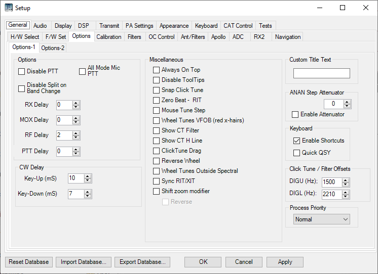

On the General > Options > Options-1 tab, what should the delays be set at? I have them at 10.
On the Audio > VAC 1 tab, what should the Buffer Latency be set at? I have them at 50.
John
Posts: 6135
Re: Packet Radio ?
Check and check. Except no on the Port Audio because this is on a Windows 10 machine.
Win10 has nothing to do with it. PortAudio is used in building the VAC portion of the Thetis interface. PortAudio settings in Setup > Audio > VAC should not be grayed out. You should be able to set them to manual and 0ms as previously described.
On the 8000 I have here, RX Delay, MOX Delay and PTT Delay are all set to 0. RF Delay is set to 2. You may find that these need to be different if you are on older hardware.

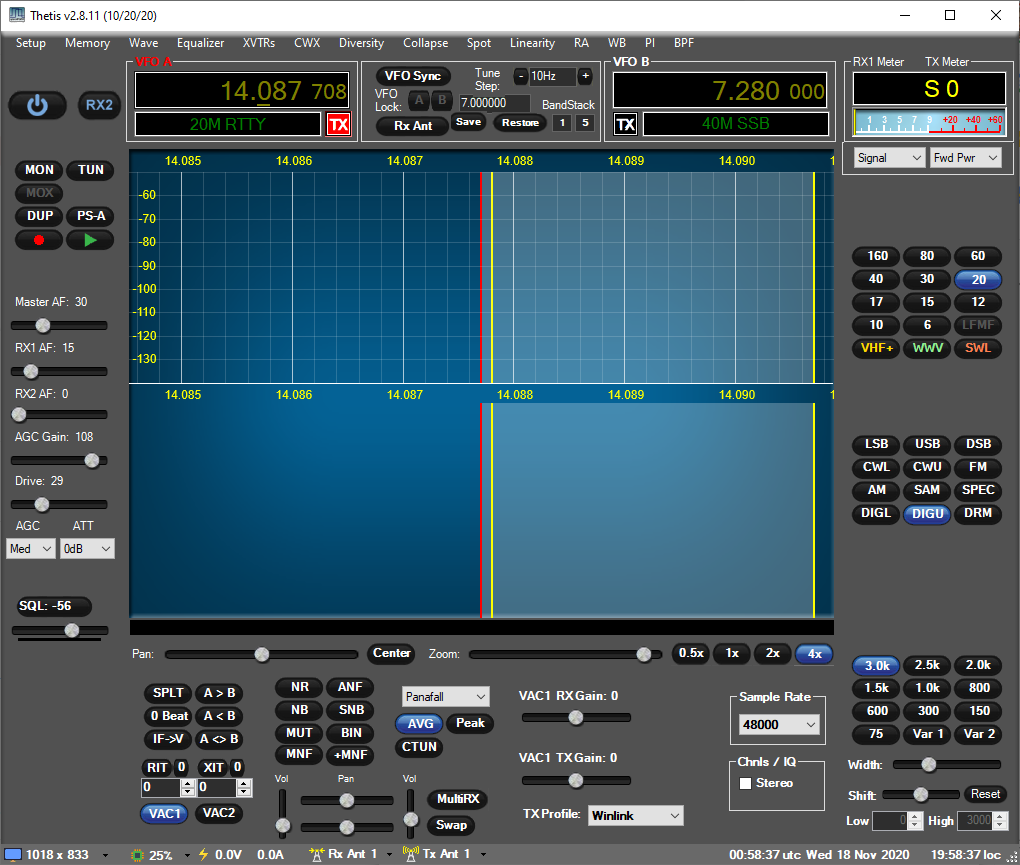

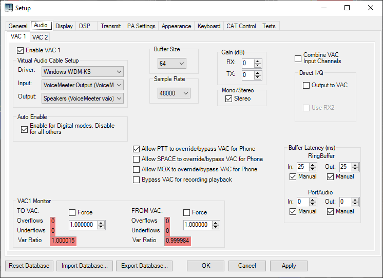

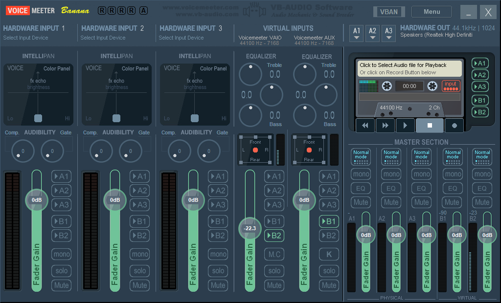

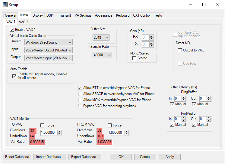

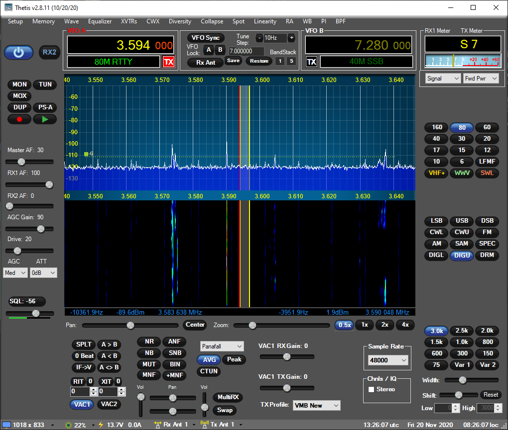

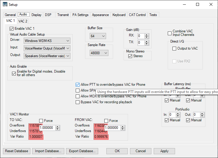

I can see now, there is something I've made amiss because from what you described earlier, I can tell you, that Voicemeeter isn't set up right. What I'm not understanding though is, how are the other two programs working because I literally did nothing to Voicemeeter Banana other than set the input and output sampling rates. The virtual com port program is com0com.
image (1).png (43.85 KiB) Viewed 26436 times
image (2).png (54.55 KiB) Viewed 26436 times
image (3).png (154.27 KiB) Viewed 26436 times
Standing by for further instruction.
John
Posts: 6135
Re: Packet Radio ?

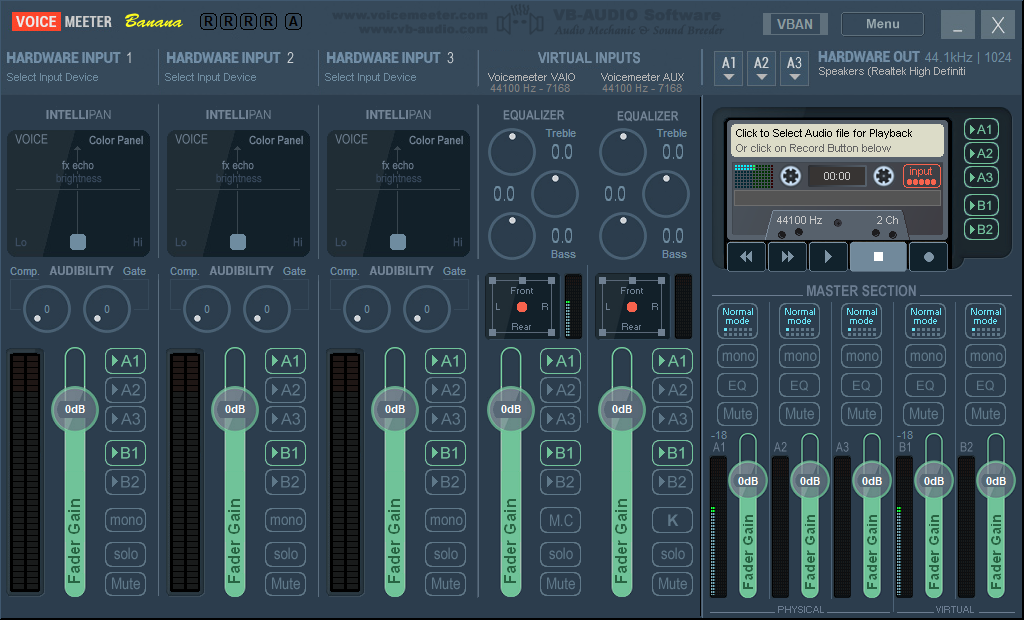

Yes, John, that is, unfortunately, a total train wreck. I do recommend you read my older tutorial.
First, in Thetis, you need to have RX1 AF turned up to 100. This will cause the VAC audio output to be referenced to 0dB (100%). If you want to turn it down a little you can do that in Voicemeeter. You probably will have to set to -10dB in Voicemeeter for VARA (move the B1 channel slider to -10).
Second, you need to go into the Windows Sound Control Panel, the legacy one, not the new Win10 one, and change the sampling rates of all of the devices your are using, both record and playback, to 48KHz.
Third, in VAC setup, you did NOT follow my directions to use the WDM-KS driver, so make that change. And turn on the stereo checkbox.
Finally, it would appear that all you did in Voicemeeter was hit buttons randomly. Channel assignments in Voicemeeter are labeled A1, A2 and A3 for the hardware inputs, and B1 and B2 for the virtual inputs, left to right.
You are not using any of the hardware inputs for this so why do you have any of the send buttons turned on? Turn them all off.
Thetis is assigned to B1 (because you chose the device that had "Voicemeeter VAIO" in the name--yes the naming of the devices with Voicemeeter is TERRIBLE and therefore confusing).
VARA (or any digi mode software) will need to be assigned to channel B2, so in those app's choose the device that has "Voicemeeter AUX" in the name. In fact, please post a screen shot of your VARA audio setup so we can check it.
With that all done, you need to SEND audio from B1 to B2, and from B2 to B1. So on channel B1, assigned to Thetis, turn on the B2 send button. On channel B2, assigned to VARA (or whatever) turn on the B1 send button.
Having the A1 send button turned on on channel B1 (Thetis) will allow you to hear receiver audio on hardware output A1 (which it appears you have assigned properly) and judge whether or not your VAC buffer settings are any good--if it sounds bad it is bad, if it sounds good it is good. You don't need the A1 send turned on for VARA (or whatever digi app is on channel B2).
That's a lot of work, I know, and perhaps a steep learning curve, but there you are.

w-u-2-o wrote:First, in Thetis, you need to have RX1 AF turned up to 100. This will cause the VAC audio output to be referenced to 0dB (100%). If you want to turn it down a little you can do that in Voicemeeter. You probably will have to set to -10dB in Voicemeeter for VARA (move the B1 channel slider to -10).
Done
image (3).png (252.97 KiB) Viewed 26387 times
w-u-2-o wrote:Second, you need to go into the Windows Sound Control Panel, the legacy one, not the new Win10 one, and change the sampling rates of all of the devices your are using, both record and playback, to 48KHz.
Done but Voicemeeter still says 44100 at the top.

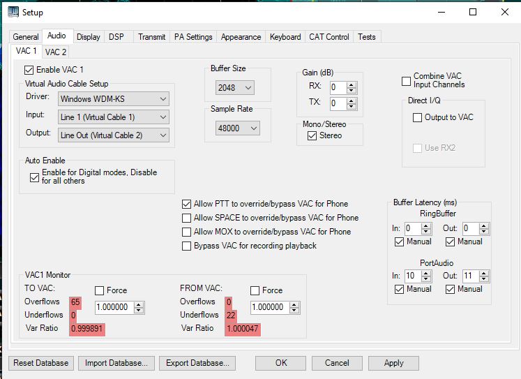

w-u-2-o wrote:Third, in VAC setup, you did NOT follow my directions to use the WDM-KS driver, so make that change. And turn on the stereo checkbox.
Done
image (5).png (53.39 KiB) Viewed 26387 times
w-u-2-o wrote:Finally, it would appear that all you did in Voicemeeter was hit buttons randomly. Channel assignments in Voicemeeter are labeled A1, A2 and A3 for the hardware inputs, and B1 and B2 for the virtual inputs, left to right.
I believe I have done this right?
w-u-2-o wrote:VARA (or any digi mode software) will need to be assigned to channel B2, so in those app's choose the device that has "Voicemeeter AUX" in the name. In fact, please post a screen shot of your VARA audio setup so we can check it.
image (2).png (248.01 KiB) Viewed 26387 times
w-u-2-o wrote:With that all done, you need to SEND audio from B1 to B2, and from B2 to B1. So on channel B1, assigned to Thetis, turn on the B2 send button. On channel B2, assigned to VARA (or whatever) turn on the B1 send button.
Let me know what I have right or wrong but I believe this is correct up to now?

Working with the other digital formats, things look different in the waterfall when transmitting. Signal doesn't look as clean as before but I'm sure there's a tweak somewhere in Voicemeeter that I still need to tend to.
I'll see if I can figure out how to grab a video snippet of it when its transmitting. Seem to remember Windows now offering that capability in Windows but will figure something out, even if I have to snap it with a cell phone and upload it to Youtube.
Posts: 6135
Re: Packet Radio ?
That's looking a LOT better.
Change your VAC buffer size from 64 back to 2048 for now. Your VAC resampler is running wild--look at the giant under and overflow counts. Not good. You can reset the counts to zero by clicking on them.

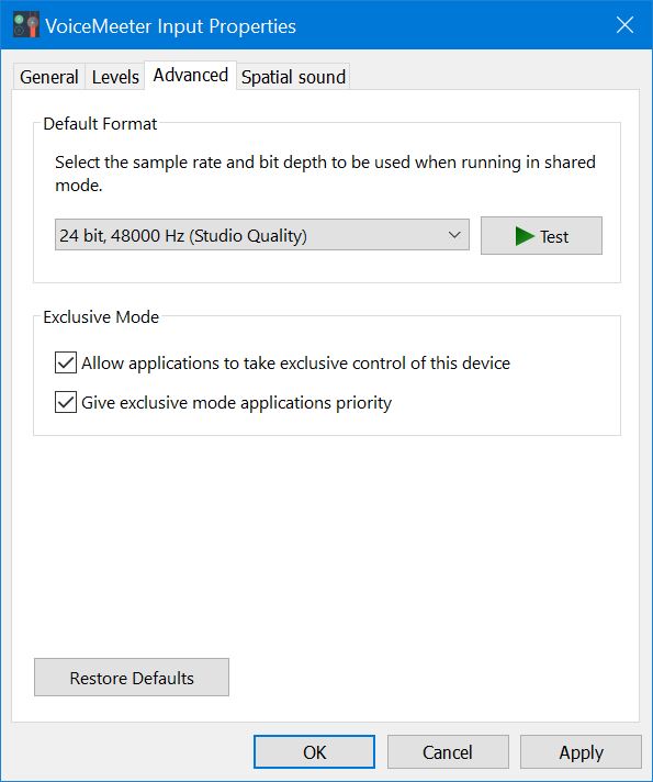

You have 5 devices that need their sample rates set to 48KHz (stereo if possible) in the Windows Sound Control Panel: the playback and recording devices associated with Voicmeeter channel B1, the two for channel B2, and your PC "Realtek" speakers. Double check that they are all correct. Example from my system:
In Voicemeeter go to Menu > System settings/Options and set Preferred Main Sample Rate to 48000 Hz.
Turn on the A1 send on channel B1 so you can hear your receiver audio. Then you may need to go into Thetis VAC settings and adjust the RingBuffer size until things sound good. If the resamplers are running wild you need to bump things up. Things need to sound right to your ear. Tune a phone or broadcast station if that works better for you than listening to beep/squawk digi stuff.

w-u-2-o wrote:You have 5 devices that need their sample rates set to 48KHz (stereo if possible) in the Windows Sound Control Panel: the playback and recording devices associated with Voicmeeter channel B1, the two for channel B2, and your PC "Realtek" speakers. Double check that they are all correct.
I'll get snaps if you need but that was done but not to Studio Quality. I did DVD Quality.

No need to worry about DVD vs. Studio quality.

Okay, got an ear on the output and it all looks great, sounds great too. Here's what I think is happening.
When I had the FT-450D in line, I noticed that when it would go from transmit to receive, the listen time was greater than what this 7000 is doing. Is that done in the Port Audio Buffers?
I noted too, before you stated my over and underflows were going nuts. I believe that screenshot was taken when the rig was off. I have the buffer at 64 and the Port Audio at 0 and the under and over flows are at 0.
image (1).png (52.8 KiB) Viewed 26345 times
What can I do to increase the transmit/receive time?
John

I do not get the yellow flashes. That could be indicative of a slow switch back to receive.
What did you change to get this far?
Why did you not match up your RingBuffer Out setting with the In setting? Other than that the settings you are achieving in Thetis VAC setup are about as fast as you can go.
Did you make the changes in General > Options > Options-1 we had discussed above? Let's see a screen shot.
In Setup > DSP > Options are your filter types "Low Latency"?

w-u-2-o wrote:I do not get the yellow flashes. That could be indicative of a slow switch back to receive.
Scott, I agree. I am wondering if the relay isn't releasing fast enough.
w-u-2-o wrote:What did you change to get this far?
You talked about the under and overflows so I started making adjustments to the latency to make them zero and am still in the process of adjustments, checking them and adjusting as needed to make the under and overflow at or near zero.
w-u-2-o wrote:Why did you not match up your RingBuffer Out setting with the In setting? Other than that the settings you are achieving in Thetis VAC setup are about as fast as you can go.[/qutoe]
Ignorance and still learning. I've changed it to make the under and overflows at or near zero.
w-u-2-o wrote:Did you make the changes in General > Options > Options-1 we had discussed above? Let's see a screen shot.
Yes, here is a screenshot. All to zero except RF Delay which is 2 as you stated.
The buffer size was set to 64 and the RingBuffer to 25.
image (3).png (53.88 KiB) Viewed 26305 times

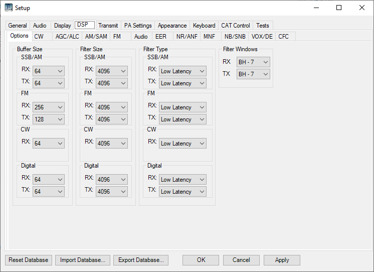

w-u-2-o wrote:In Setup > DSP > Options are your filter types "Low Latency"?
Yes.
image (2).png (42.9 KiB) Viewed 26305 times
Let me know if there is anything else.
John
Posts: 6135
Re: Packet Radio ?
Can't see your settings getting any better than what you have. They are actually extremely good, you clearly have a fast computer. It should be plenty fast enough for VARA and Winlink. Is it working OK?

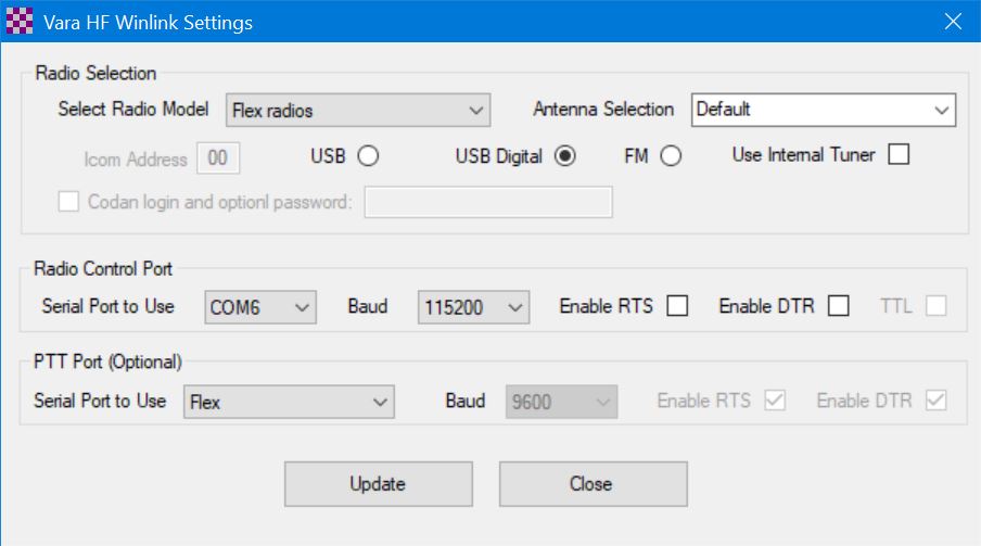

I have the exact same problem with the latest versions of Winlink Express and VARA HF. When I try to initiate a connect, I can hear the other station respond, and see it on the VARA waterfall, but it seems like my station is not acknowledging the response and goes into transmitting again almost before the other station has finished transmitting to me. Did you ever get VARA HF to work with the Anan 7000DLE?
Tnx de Arnie W8DU
KC4LZN wrote:
w-u-2-o wrote:What sort of hardware or software packet solutions are you looking to use?
Winlink Express with either WINMOR or VARA is a 100% software based solution, very easy.
I've got Winlink Express, VARA and Thetis 2.8.11 and have not been successful connecting to a mail server. After it transmits, I can hear the station reply but it never connects.
Someone mentioned to me about latency and have made several adjustments to no avail. What is the areas i need to focus on and correct to make this connect?
John

a question: How did you configure WinLink that PTT works? WSJT-X works without problems when I configure a Kenwood TS-2000 incl. changing frequency and PPT on TX. In WinLink I tried all Kenwoods, but none of them triggers PTT. When I solve the problem with VOX, then I have the same that I hear the other station answer, but no connection. I checked the images in this thread but there is no one hith the CAT/radio setting.
With "Kenwood amateur" at least it changes the frequency.
András
