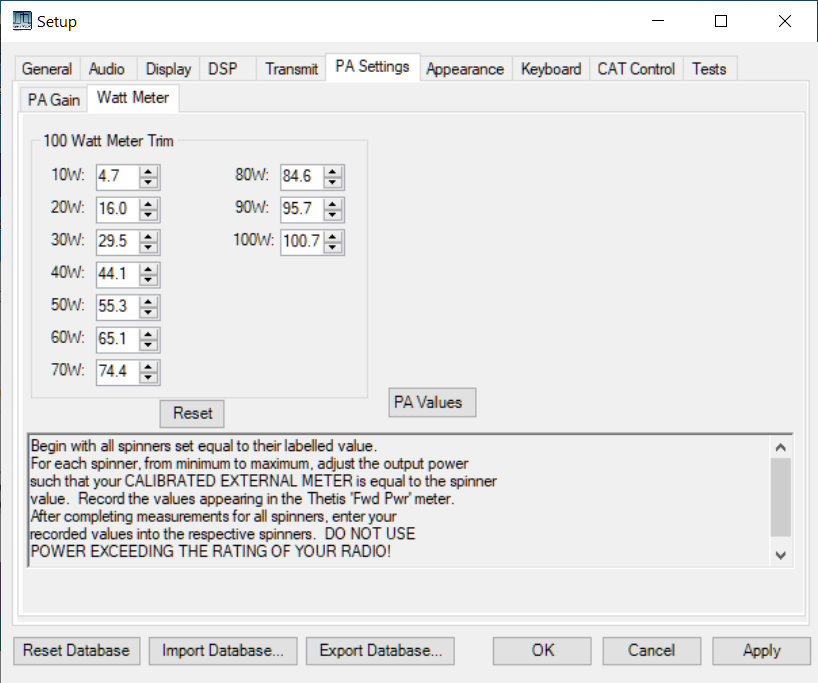

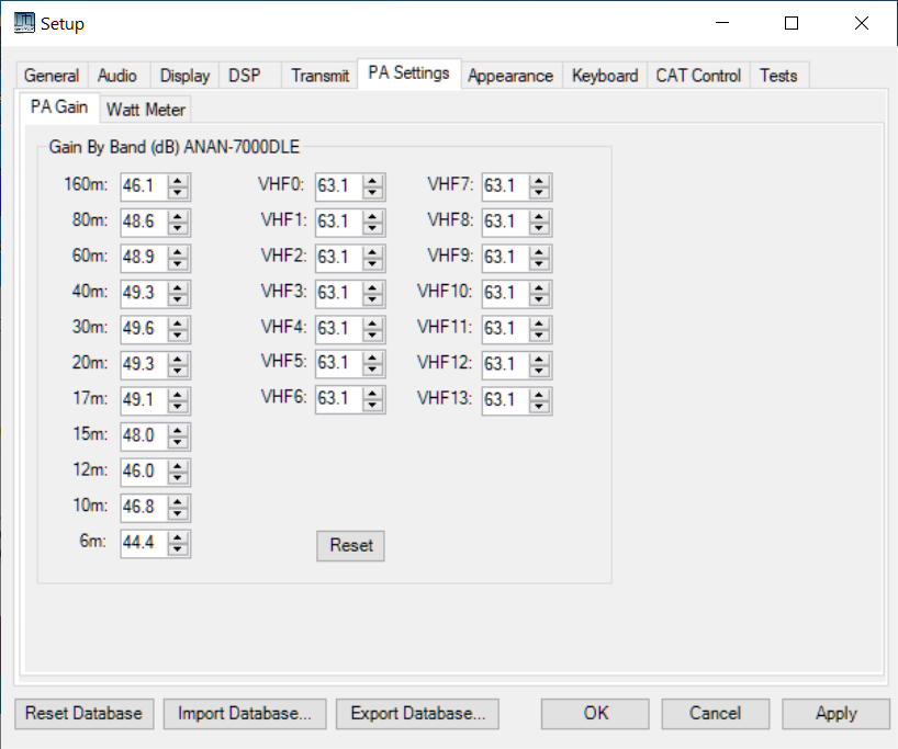

Yes, you absolutely DO need to "dive into" the PA Gain settings, and you will also probably want to adjust the PA Watt Meter settings. Be aware, the whole process will take some time.
For reference, here are my settings (below). I calibrated my drive into an oscilloscope feeding thru a calibrated 40dB attenuator. After tweaking the PA numbers my power is now within a couple of watts of wherever I care to set my drive, on all of the HF bands (I don't mess with VHF).
NOTE: The settings in the pics are for reference only, your final numbers may be different. Also be aware that small changes to the PA Gain values make a BIG difference.
Mark K1LSB
PA Settings - Gain.PNG (122.22 KiB) Viewed 4150 times
PA Settings - Watt Meter.PNG (157.33 KiB) Viewed 4150 times
