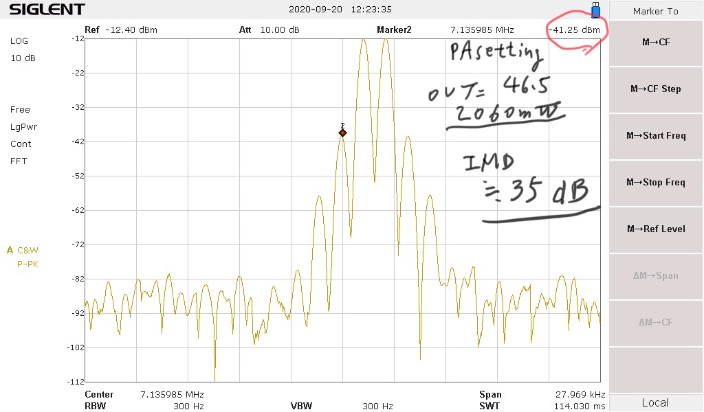

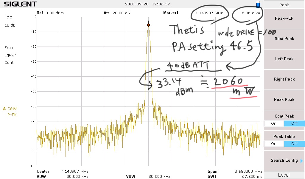

Re: Orion MKII amplifier output quality and bias adjustment
HI All,
I measured the output power of my Orion MKII by PA Setting to 46.5 for 40 meters band (7000DLE selected).
The power is around 2,060mW and the IMD is around 35dB. The IMD is almost the same as the PA setting 53.3.
My Orion MKII amplifier is good enough to use it.
Is Orion MKII designed for 3W or 2W?
Tokio
ja1cca
Tokio
ja1cca
- The output by "TUNE"
- fullsizeoutput_bda.jpeg (108.4 KiB) Viewed 4732 times
- The output by 2-Tone
- fullsizeoutput_bd8.jpeg (129.98 KiB) Viewed 4732 times
