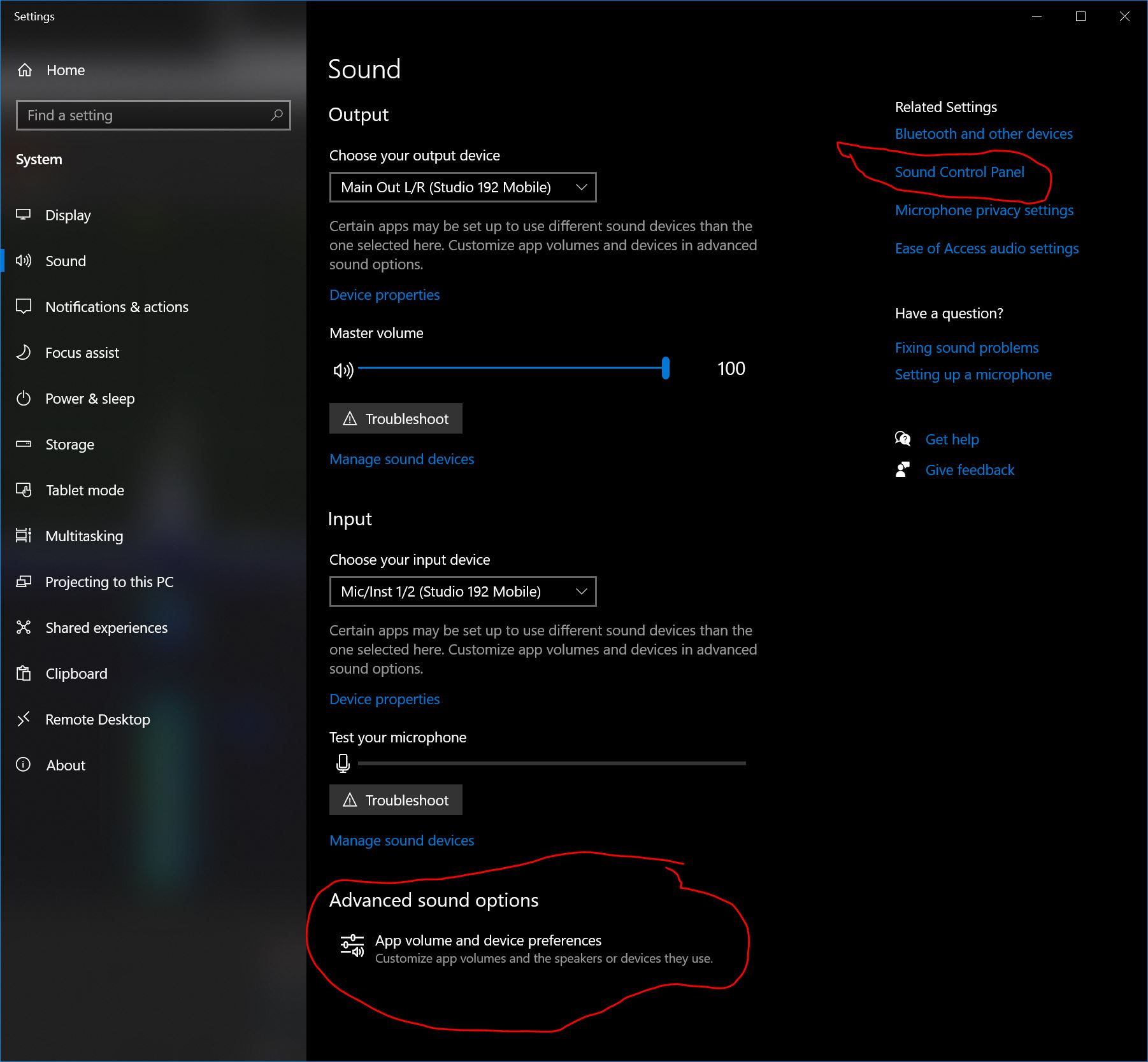

Another, very basic, device level place where audio gain can be adjusted is in the Windows Sound Control Panel. At the bottom, under advanced sound options, you will find a mixer that can be adjusted for applications that support the Windows Sound Mixer.
However, the new, Windows 10 Sound Control Panel still does not replicate the device level controls that are found in the legacy Windows Sound Control Panel, which can be reached from the new sound control panel by clicking on "Sound Control Panel" in the upper right hand corner. Confusing? You bet! But it is critical to go into the old style control panel and check the levels assigned to each device. Fun tip: you can right click the numerical readout and change it between percent and decibel readings.

If it does not show -1dB, then there is a problem in your virtual cable or in Windows. As discussed above, check the Windows Sound control panel (new one), all the way at the bottom, under Advanced Sound Options. Check also the old Windows Sound control panel and the levels set for your virtual cable devices.
