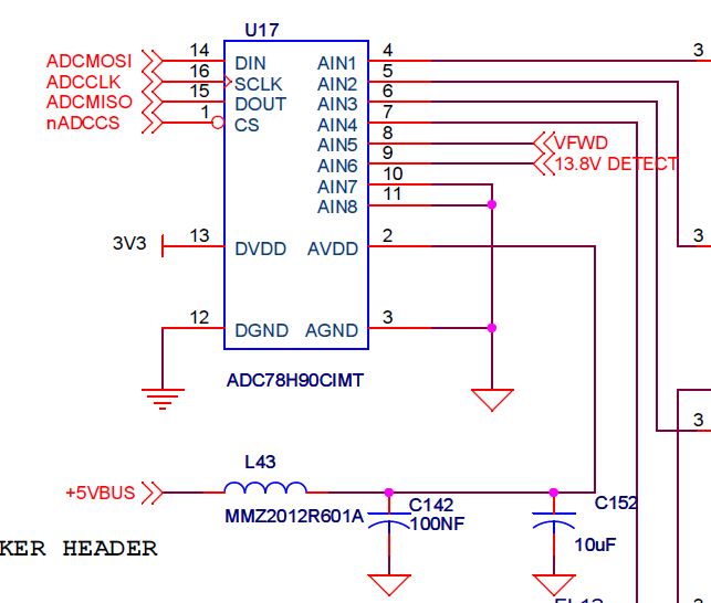

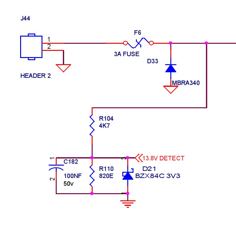

I don't have a 7000, but if you look at the following Orion MKII schematic snippets you can see the 12VDC is sent to a voltage divider, the output of which is limited by a zener diode, then sent to an 8 channel ADC.
You'd have to put a scope on the 5V analog voltage reference input to the ADC to see how well behaved it was. Similarly, you'd have to put a scope on the ADC input in question to see how noisy it is. After that it becomes a question of how well the firmware does at reading the ADC and how much filtering goes on in the software.
IMHO it's not super important stuff, but it is certainly understandable why it is annoying that it doesn't work well.

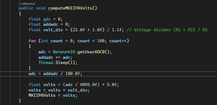

Thetis code... protocol 2
//Bytes 53,54 User ADC0 [15:0]
prn->user_adc0 = prn->ReadBufp[53] << 8 | prn->ReadBufp[54]; // AIN3

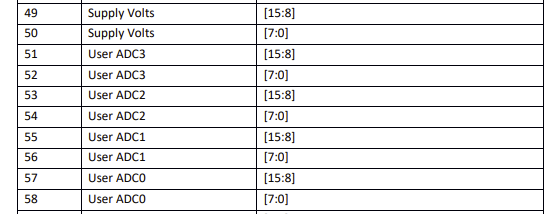

53,54 are actually 57,58 in the port 1025 high priority status packet (page 46 of the protocol manual)
Thetis takes 100 of the adc samples, and averages them

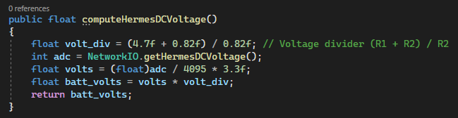

EDIT, just to add this code is not used any more, which I note uses the 4.7k and 820ohm as per the schematic you included Scott.
//Bytes 45,46 Supply Volts [15:0]
prn->supply_volts = prn->ReadBufp[45] << 8 | prn->ReadBufp[46]; // 49 + 50 in the 1025 packet
So, I guess we need to look at the schematic for AIN3 ?
Re: Changing Voltmeter
It's a little bit of chalk and cheese going on here, Richie, I think.
AIN3 is the 12VDC power measured at the input to the PA, on the PA board. It's measured after it comes out of the ACS713 current measurement IC. The 12VDC is processed through an LM358. I haven't checked the gain of that circuit vs. the code yet, but I suspect it matches. The output of that op amp is taken off the PA board through that Berg connector, goes over to the rear panel breakout board and then is taken into the Orion MKII board via the J16 connector. I hesitate to post too many schematic snippets since Apache has asked for the schematics to not be publicly posted, but the snippet that shows the sensing circuits on the PA board is shown below. I'm sure you have them anyway, Richie.
AIN4 is the amp current measured by the ACS713 and processed through other half of the LM358. Same signal routing as above.
AIN6 is the 12VDC as measured on the Orion MKII board, as previously discussed.
Are they all supported in the P2 interface on the high priority packet? They could all be displayed on the status bar, theoretically. I do have the amp voltage and current being displayed on the 8000. I have not checked to see if the scaling factors are different in the code or handled in the hardware on the 8000 PA board, the major difference being that the 8000 amp power supply voltage is 50V. The 50V display I see here is well behaved.

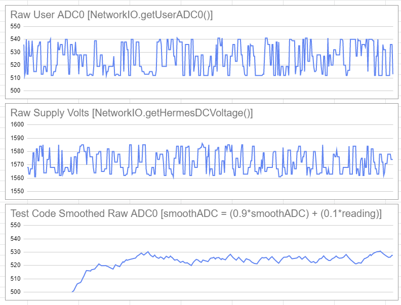

grabbing some data, P2 7000dle, and playing around with some different smoothing. Sampled every 10ms.
I have changed the way the adc's are sampled in 21k9c which should be out over the weekend some time.
Previously, a thread would sample PA volts for 100 iterations, with 1ms delay between each read. After that, it would then read amps for 100 iterations, with 1ms delay between each read. Then it would wait an additional 600ms and repeat the process. Consequently, we would have blocks of reads that were close together spaced around 800ms as the total process would take ~800ms to complete.
I have changed this, to take a single volt and amp reading, every 8ms. So in 800ms we would have taken around 100 samples of each, the same total samples in the same time as above, but now spread out over the duration. These are dumped into a fifo queue as they come in, and then averaged when a volt/amp status bar update is needed.
Perhaps this massive volt-swing that people have noted is related to more recent 7000s, who knows, but the change above should eliminate any step changes related to sampling at nearly once per second.

I would say it's a near 100% bet that Bytes 49+50 is AIN6, I'd call that supply voltage, whereas Bytes 57+58 is AIN3, PA voltage. I'm assuming you have also identified the bytes for AIN4, PA current?ramdor wrote:yes, but the take away from the code is that User ADC0 is being used to display the PA voltage (commented as AIN3 in the code) and uses bytes 57+58 from the HPSP. Bytes 49+50 which are defined as Supply Volts (whatever AIN that is I do not know as it is not commented in the code, probably 6?) is not used in Thetis right now.
Your prototype smoothing algorithm looks much better. A LPF and/or rolling average approach as opposed to chunking it up will provide not only a more stable answer but the opportunity for a higher/smoother update rate on the UI.ramdor wrote:grabbing some data, P2 7000dle, and playing around with some different smoothing. Sampled every 10ms.
AIN6, supply voltage, is available on all ANAN models from the bare board Hermes on up to the latest 7000.ramdor wrote:possibly, I don't know what is returned to be honest through the various firmware for all other radios
AIN3 and AIN4 are only available on the 8000 and 7000 variants.

I re-wrote the volts/amps averaging code a while ago. Every 8ms a volt and current reading are taken and are stored in a queue of capacity 100 for each. At the display interval defined by cpu meter interval (yes I know), these queues are averaged, converted and displayed as V and A. As we are rounding to display the text, a tiny change may cause the flicker between 13.8 and 13.9v for example. Increase the queue size too far and it will take ages to settle to the required value.
I have added some logic that will only let the display change if the deviation between previous readings is > 0.05, which should prevent a flicker between 13.9 and 13.8 if just on the edge case. I have also increased the queue size for volts.
Also to note, there is a change in my new version (released soon(tm)) to adjust the current calculations, and I will be looking to do the same for volts to hopefully get around the issues with new hardware somewhat.
