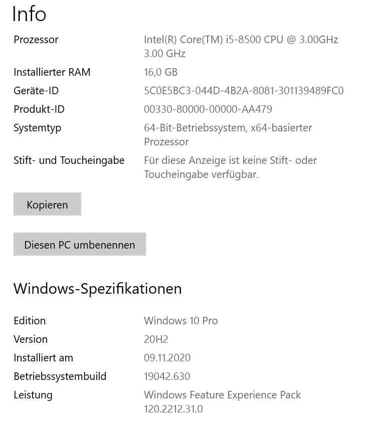

Since the update of Windows in October I have very big problems with the PTT. A normal QSO can't be done any more......To the problem....I start Thetis 2.8.11 and switch on the TRX....the PTT works fine for about 2 minutes, that means if I press the tune button or the foot switch the TRX goes on air......after about 2 minutes. after pressing the Tune button or the footswitch the Disaster starts. In Thestis the "Mox" button (or the Tune button) lights up, but the TRX is not switched through, there is no transmission.... .it feels as if there is a loose contact (which is not the case)....sometimes the transmitter gets stuck, so it is not switched off or it does not start at all....... up to Windows 10 version 1909 Build 18363.1198 everything works well......in the attachment you can see my current configuration......who has similar problems or knows an advice?

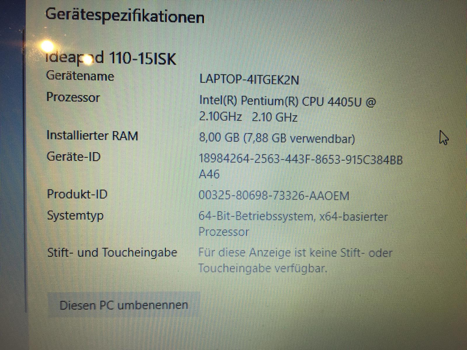

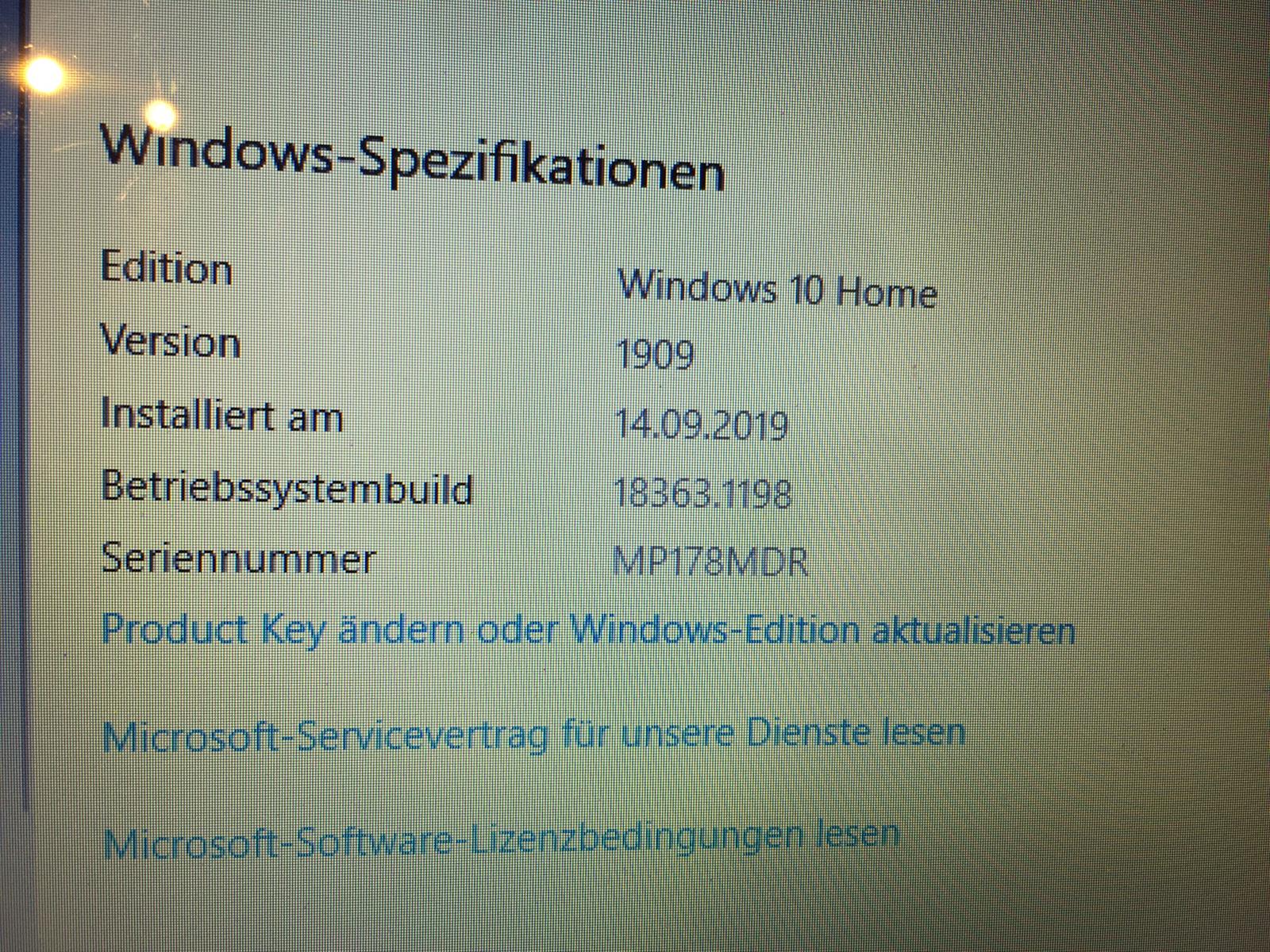

I am using Thetis2.8.11 with the protocol 2 with an Anan 10.........it was running fine before the update......but I have tested the following:....a )with another PC, same windows configuration as the original PC....also here the same problems......
...a laptop with an older Windows configuration (see appendix)..... here everything works fine......
...a friend of mine has found similar problems and similar things.... he will also comment on this problem here....
...I am no expert, for God's sake, I only described what I noticed or observed.....the only thing I changed was the update of Windows (other things are automatically "updated" with the Window update......Framework and so on)....I rule out a hardware error (errors from relays or Anan 10 and so on) because Thetis 2.8.11 works perfectly with protocol 2 on the laptop (and also worked perfectly on the PC before the update).....

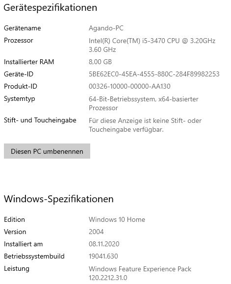

I have an Intes processor.
Maybe it is also interesting to specify the hardware of the radio with the firmware.
I use a Hermes board.
FW: Hermes 10.8 pre18
SW: Thetis x64 2.8.11
protocol 2
73, DL5AI
Arno
protocol 2
73, DL5AI
Arno
- PC Info Win10.JPG (41.62 KiB) Viewed 8295 times
