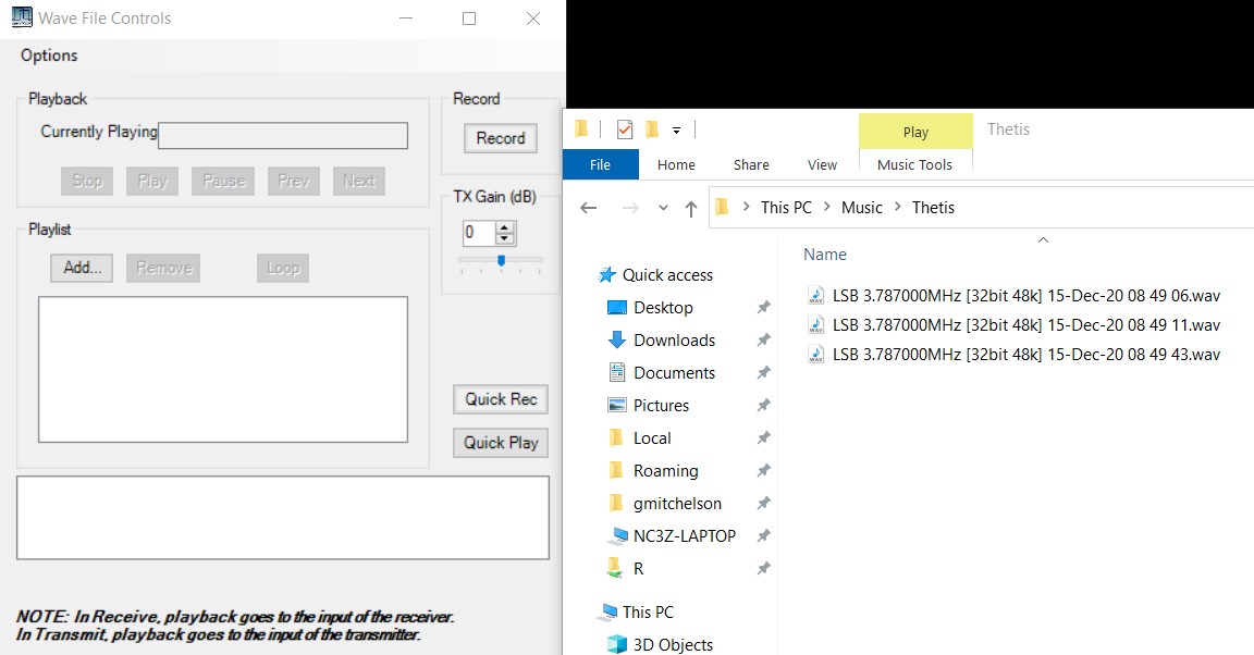

Is there a way to record a signal off the air and then save that to a place where it can then be sent, say via email, to another ham? I know you can record and play back over the air but I've not been able to find where that file is saved and if its accessible.

Open the Wave menu and every time you hit the Record button Thetis will make a new recording in your Music folder.
Screenshot 2020-12-15 085017.PNG.jpg (90.93 KiB) Viewed 3014 times

NC3S, thanks! The "where is it saved" info was the info I needed.
I also found that 3rd party software, like at this link (free): https://www.nch.com.au/software/free-do ... %20-%20WAV
will do the same thing but with more steps.
Appreciate the help and info!
