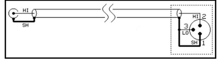

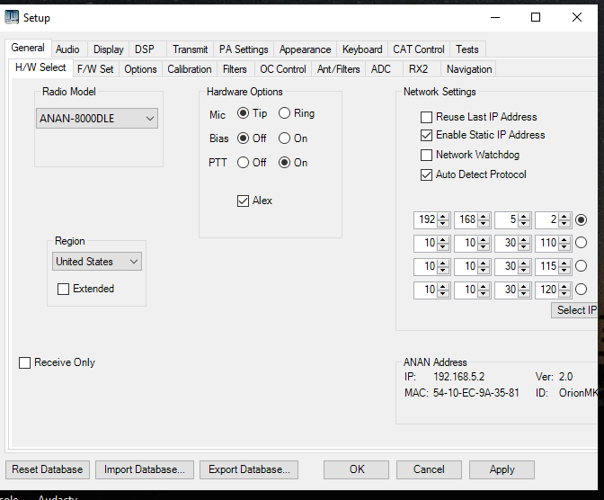

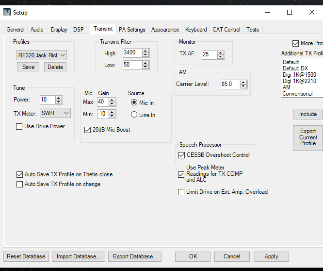

Post screen shots of your main console display, Setup > General > H/W Select, and Setup > Transmit.
Post a schematic of the mic cable you are using.

MK-4 has been my mic for 6 months with Phantom power,when I lost audio I switched to RE320 using proper settings which I enclosed,
I tried the forward power test and had power.
- transmit.PNG (39.95 KiB) Viewed 24102 times
- MIC.PNG (16.3 KiB) Viewed 24102 times
- H-W.PNG (41.21 KiB) Viewed 24102 times

You did not show the pinning of the unbalanced end of the cable. Assuming it is correct, then the problem is almost certainly that you don't have your audio chain settings properly adjusted.46flatlander wrote:Yes, I realize that,but my complaint is the audio going out over the air is distorted. It sounds like a lot of noise.
See this topic: https://apache-labs.com/community/viewt ... f=6&t=2550
