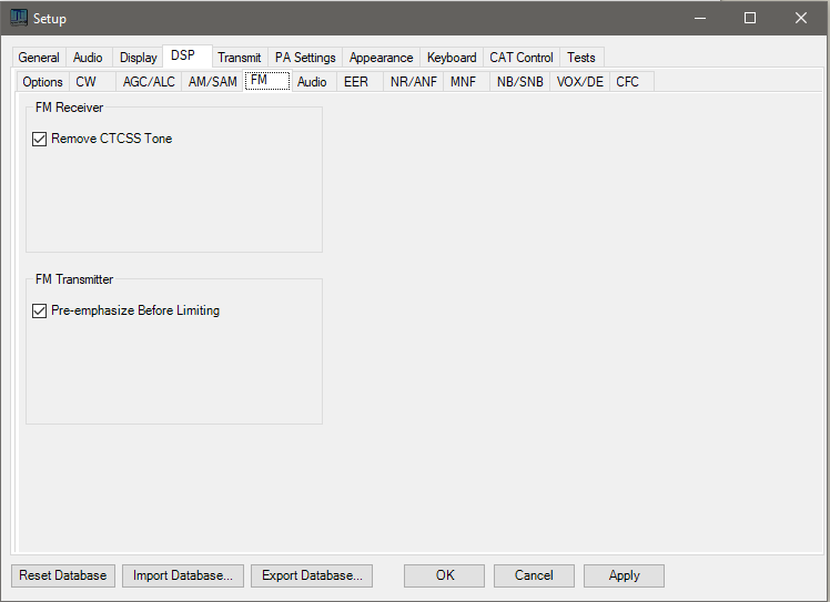

Have you already enabled "Pre-emphasize Before Limiting"?

DH1KLM wrote:Have you already enabled "Pre-emphasize Before Limiting"?
Ahh, this did the trick. Now it sounds much better on FM. Thank you so much, I was really on the brink of frustration.
