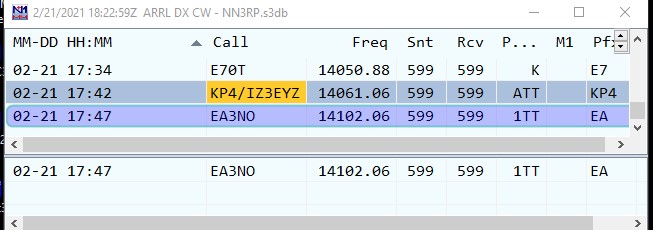

I am using Thetis v2.8.11 with 7000dle MKII. In doing this weekends ARRL test I noticed something really weird. Let me be brief:
I am using N1MM+ and in Thetis setup I make it to be Focus Master. Say I make a contact and then realized I made a mistake so I go and edit the contact. As soon as the edition is made, Thetis, abruptly, shuts down. I cannot recover it as I launch it again because it gives me the dreaded window about network error is the radio on? The only way to gain back access is to completely shut down the whole thing.
This happens a couple of times doing the same; a correction to a log. So it triggered me to remove N1MM+ from Focus Master. Once I did that, there were no more issues with editing at all.
Any one can reproduce this or is it me only?
