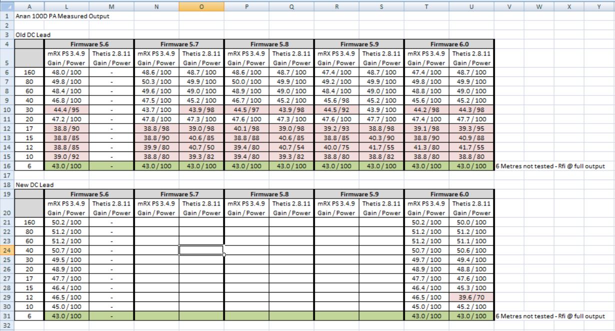

As posted in the 'Everything else...' section of the community I have been experiencing problems with the Power Output of my very early model Grey protocol 1 Anan 100d. Some background:
Typically I only run 20-30 watts however one day when testing with FT8 I noticed my output as measured by Powersdr mrx (Thetis does come up further down) disappearing to zero. Checking the PA Values in the setup/PA settings/Watt meter tab I could see that the power was folding back due to the SWR spiking at a very high value occasionally. This was traced to a faulty co-ax lead between the rig and my external Power/SWR meter.

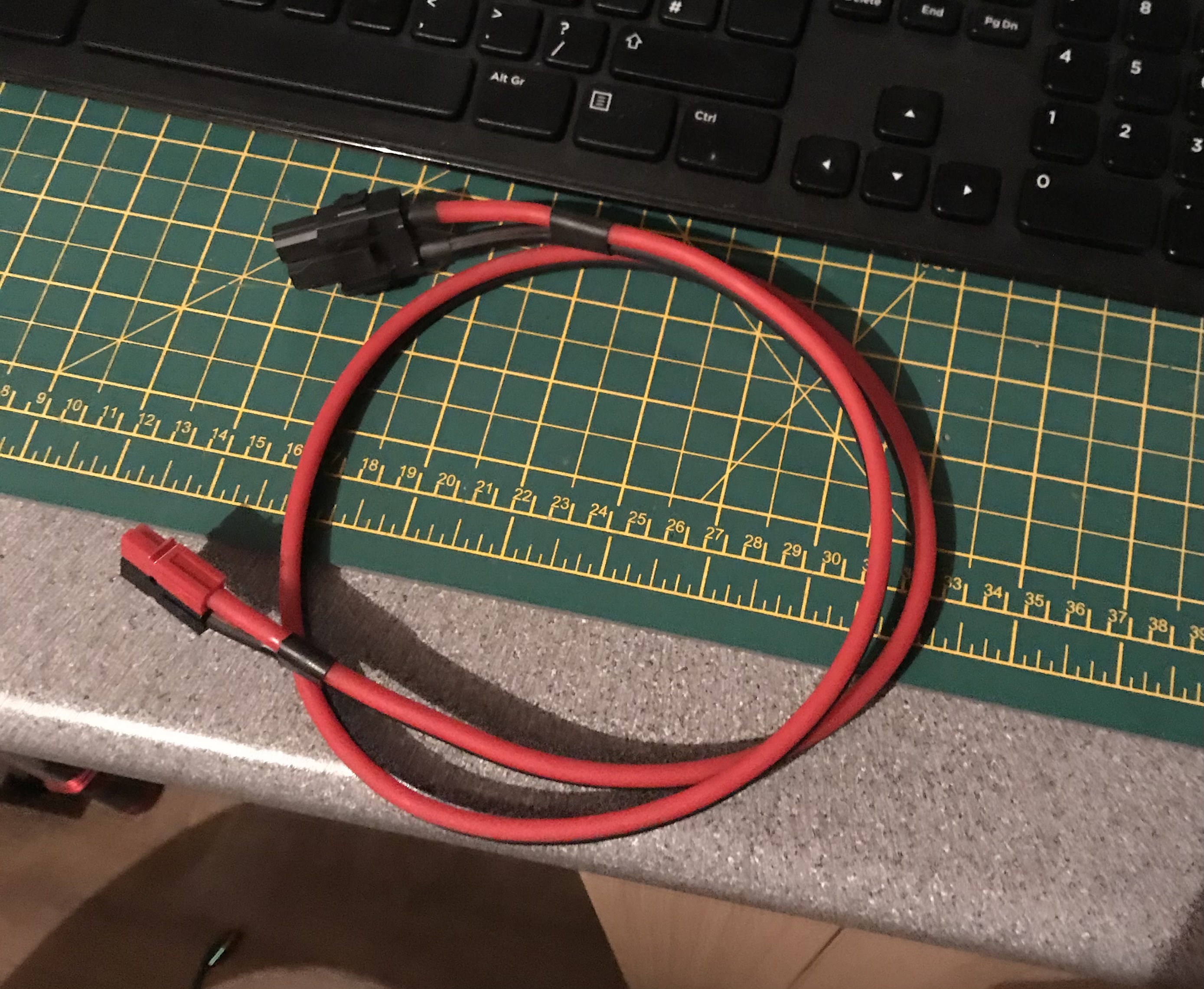

New BNC to PL259 lead made up and all is well. Lesson one learnt.
So, I decided to check the PA by performing a PA calibration. This showed that whilst I could achieve full power on the lower bands. 30 metres and 17 to 10 metres were unable to achieve full power. I wondered if this was firmware related so tried the next firmware version, similar result.
Is this a Powersdr mrx problem ? Tried Thetis similar low power on some bands but different values than with Powersdr mrx.
So, I tried every version of Firmware from 5.7 to 6.0 with both Powersdr mrx & Thetis. The results are plotted on the spreadsheet below.
Interestingly sometimes Powersdr mrx produced better power on the affected bands other times Thetis did.
Sometimes, depending on the firmware version Thetis would only get 12 metres to 50 or so watts !
Like another poster on the forum I noticed that the DC Lead fuse holder was warm. I have never liked the DC lead it is too rigid, has sharp zip ties and is generally of poor quality. So today I made a new one using a flexible silicon rubber cable, omitting the fuse holder (the lead is fused at my Powerpole powerstrip).
Bingo full Power on all bands when using Powersdr mrx, I tried the earliest and latest firmware versions I had.
But with Thetis whilst all other bands achieve full output I cannot achieve more than 70 watts on 12 metres.
I'm not concerned about this because as stated I typically run 20-30 watts but I would like to know why Thetis struggles with my 12 metre output when Powersdr mrx doesn't ?
Anybody else experienced this ?
Cheers, Peter.....G1FXE

- IMG_E0814.JPG (1.76 MiB) Viewed 58012 times
- Output.JPG (198.88 KiB) Viewed 58012 times

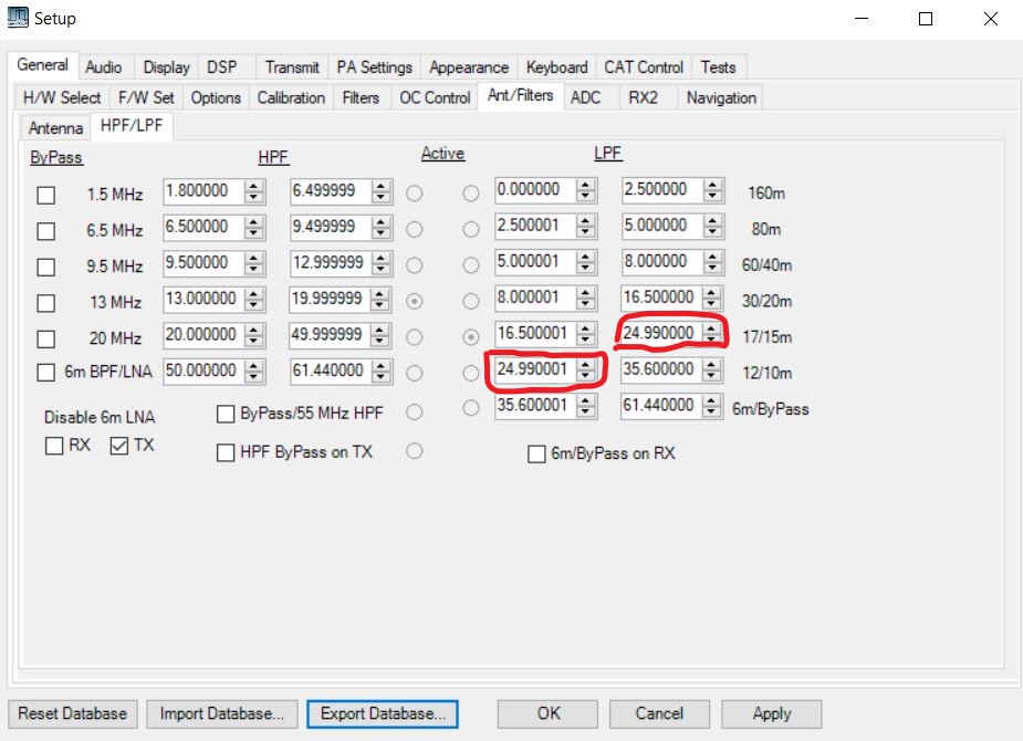

Can you post a screen shot of what Setup > General > Ant/Filters > BPF shows when on 12M?
https://apache-labs.com/community/viewt ... =17&t=3407
It would be unfortunate to discover that it is only working correct on Rev. 24 RF boards.

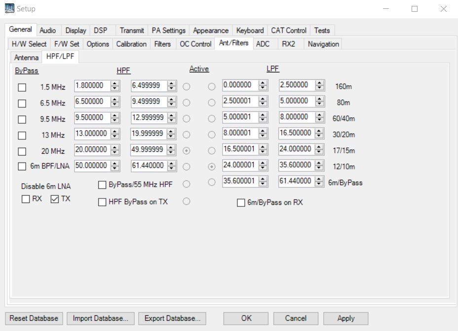

Scott,w-u-2-o wrote:Can you post a screen shot of what Setup > General > Ant/Filters > BPF shows when on 12M?
Screenshot attached as requested.
One thing I noted this morning when playing further:
Even though the Band filter ranges are identical between PSDR & Thetis in my install it does appear that PSDR pairs 12metres with 15metres whereas Thetis pairs 12metres with 10metres.
Or should I say when changing from 15metres to 12metres in PSDR there is no relay click heard whereas when changing from 12metres to 10 metres in PSDR a Click is heard. The opposite applies in Thetis.
Note: When I reset the database in PSDR the Band filter ranges differ from my norm (which matches Thetis) but full power is achieved on every band in PSDR regardless of what the switch points are set at (Custom or Default).
The more I look into this the more confused I become
Cheers, Peter..... G1FXE
- filters.JPG (81.77 KiB) Viewed 57933 times

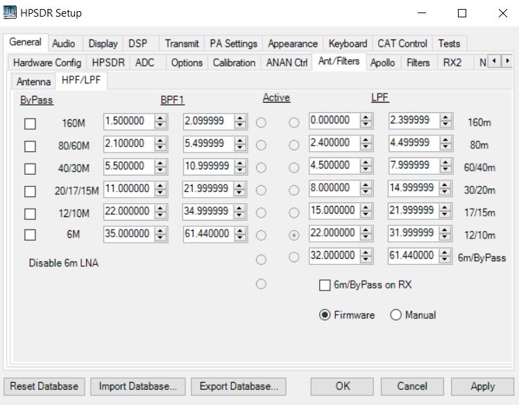

As you point out, that makes no sense.g1fxe wrote:Or should I say when changing from 15metres to 12metres in PSDR there is no relay click heard whereas when changing from 12metres to 10 metres in PSDR a Click is heard. The opposite applies in Thetis.
One thing to look at in PowerSDR: you'll note the two settings, "Firmware" and "Manual". In Firmware mode code in the firmware will look at the tuned TX frequency and make its own decision about what LPF to select. In "Manual" mode it uses the table on the setup page to make those decisions. In Thetis it only has "Manual" mode.
You might play with PowerSDR and see if you can get it to mimic Thetis. That might offer a clue.
Re: Power Output Woes (Largely solved)
Scott, yes I managed to get PSDR to mimic the issue with 12metres in Thetis. Selecting Manual on the LPF tab results in the same 'low' power.w-u-2-o wrote: One thing to look at in PowerSDR: you'll note the two settings, "Firmware" and "Manual". In Firmware mode code in the firmware will look at the tuned TX frequency and make its own decision about what LPF to select. In "Manual" mode it uses the table on the setup page to make those decisions. In Thetis it only has "Manual" mode.
The default (with fresh database) in PDSR is that 'Firmware' is selected in which it appears that 12Metres is switched with 15metres resulting in full power on 12metres.
Particularly strange considering I get full power on 10metres. I would have thought an issue resulting in low power on 12 would result in the same on 10 (when in manual) ?
Below is a screenshot of the PSDR default database LPF tab. Frequency ranges are slightly different than Thetis but still don't account for the issue in Manual.
Rgds, Peter.....G1FXE
- psdr default.JPG (75.71 KiB) Viewed 57867 times

Unsurprisingly when the upper edge of the 17m/15m range is adjusted to include 12m full power is achieved on 12metres.
Nice to see that when you adjust one band filter upper range the lower edge of the next band adjusts to compensate. IE. I changed 17m/15m upper limit and the 15m/12m lower limit 'changed itself'.
I suppose the big questions is, is this a fault with the manual selection of LPF's (or the range assignments) in PSDR & Thetis, a firmware bug or a hardware issue with the Anan 100d or a combination of the last 2.
My guess is we'll never know. For curiosity sake I might see if I can find the release notes for the historic firmware release to see if Band/LPF assignments are mentioned.
Thanks for indulging me in this head scratcher.
Peter.....G1FXE
- Thetis.JPG (102.87 KiB) Viewed 57799 times

Not having much luck tracing older firmware release notes but did find this:
http://lists.openhpsdr.org/pipermail/hp ... 44830.html
If I read this correctly Joe made a change to the firmware way back when to correct a low power issue on 12metres because the Anan 100d (Angelia) needs different LPF switch points than the Hermes rigs. I guess the 'manual' switch points by default are the 'Hermes standard' in both PSDR & Thetis ?
This seems to tie up with my problem. In Lieu of the missing 'Firmware' switch on the filters tab in Thetis it appears that amending the ranges
as I did in the previous post is the way to go.
Peter.....G1FXE
