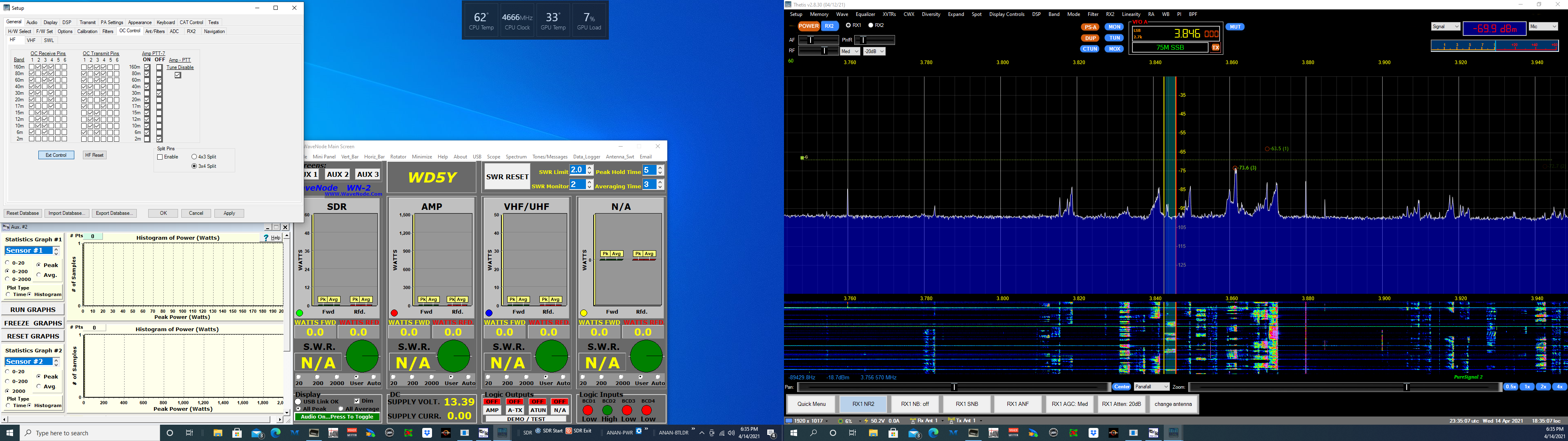

Everything I tested so far looks good. But, I am trying to look into the "4 x 3" and "3 x 4" split checkbox choices and baffled at this point of how to take the OC-7 out of those options. It needs to stand alone and not be affected by VFO selections when one of those checkboxes come into play. As long as those "split" choices are not used all is good. I am attaching a photo of the screen. When I can I will look at this more. I definitely will use it as is now because I will never have a use for the OC split functions.

What do OC outputs have anything to do with this issue?
Re: Tune Button
From what I understand he modified Thetis and disabled the PTT out and enabled it with OC outputs. You may see the disabled PTT menu in Thetis configuration in the above screenshot.

How does that meet your requirement, Mike? All you need is the disable PTT part.
In fact, why not just use an external switch? Or an external switch controlled by an OC output. Or an external switch controlled by a DDUtil macro button.

What Joe accomplished, and I was asking, is that the tune button is not enabling the PTT out.

I am not disabling the main radio ptt at all, it functions as it always has. I merely give the option to use the OC-7 as a ptt function. You can select by band for ptt and/or check the disable during tune checkbox which will not key the amp/device during tune on those bands selected. I had to provide the second checkbox corresponding by band to allow a memory after tune to remember the band that you want to disable the ptt function on. Again, from what I see you can not provide this function with the main radio ptt. For myself, I prefer the radio as independent as possible without relying on other software other than using in my case wavenode for my amp and tuner control. I just posted in case someone was interested, showing it is a possibility. To be honest someone with greater coding knowledge could more than likely provide a better solution. I agree with Mike that a feature like this would be of value for amps/devices controlled by ptt.
