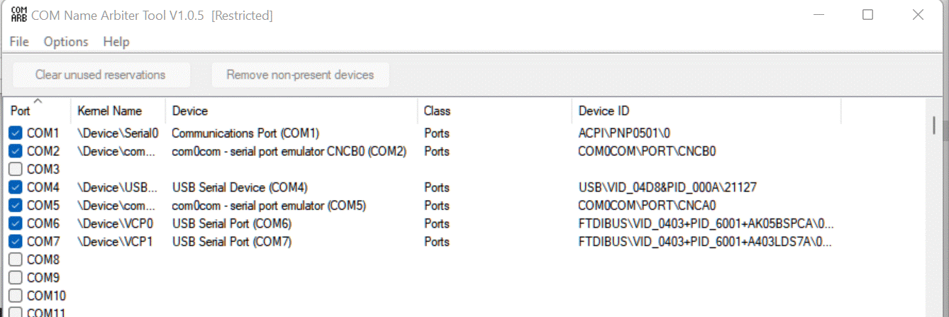

'At present' SWR Plotter is starting but shows only as an icon in the system tray. Hovering over that with the mouse pointer opens only a white background just above the system tray. None of the right click options seem to move it beyond that point.
The last setup I selected COM2 and it indicated it was connected (or other appropriate language) via Virtual Port Pair 0. That port pair was set up with com0com. Per com0com COM2 appears to be paired with COM5. CAT Testing is set as TS-2000. Changing that to other options without restarting Thetis seems to make no difference with the manner in which SWR Plotter starts up. Use Ports class is checked for COM5 and COM2. None of the other boxes are checked.
Opening my antenna switching macro I see L- - COM4_2 at the upper left of the title bar. Is that an indication that COMports 4 and 2 are connected?
What other information may I provide?
de Dick - KA5KKT
de Dick - KA5KKT

It sounds like somehow the setting for SWR Plotter have become corrupt. Your best bet is probably to uninstall it and reinstall it.
