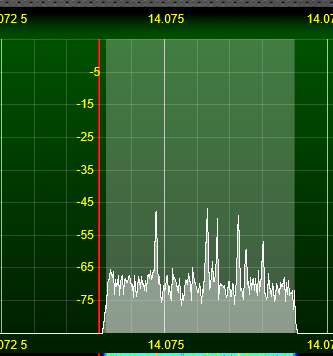

I also see a noise burst at the start of a transmission, in this case it is FT8. The noise looks like it is coming from the receiver just prior to the input from WSJT-X.
Since it is around 50db below the transmit level of 0dBm it is not a problem but I would rather it was not there. I wonder if there is a delay setting that can resolve this. Not sure if this is similar to what you are seeing.
initial noise burst
initial noise burst
2021-03-27 09_16_01-Window.png (15.58 KiB) Viewed 21442 times

Re: Noise Burst on initial transmit
Posted: Sat Mar 27, 2021 4:49 pm
by w9mdb
That looks like it's receiving...I see a lot of what looks like FT8 signals there.
So it appears transmit has not occurred yet.
Posted: Sat Mar 27, 2021 4:55 pm
by mcindan
Yes, it appears to be FT8 receive - the capture is from the TX display, not the RX display.
Posted: Sat Mar 27, 2021 5:01 pm
by mcindan
On transmit there is a burst of RX signal at the start of the transmission. PTT from WSJT-X or MOX result in the same issue. It appears I am seeing the same thing as in the original post.

Here are the captures you requested. It was really early this morning (2am) when I went through and made changes. I went through again to make sure ai didn't miss anything. I've looked at the Sound Blaster manual and nothing jumped out at me. I went trough and reduced levels on all the mixer settings except Microphone and Speakers. I wet into the Speakers sub-mixer settings and reduced all but L and R. I posted those. Also on the Playback page I went into the settings menu next to the tuning fork. I changed the speaker configuration from 5.1 to Stereo.
After all those changes I tested it. The noise is still there. I tried something else. The output of the sound card is fed into an integrated stereo amplifier. We I turned the volume on the amp down the sound disappeared completely. Turned it up and it's there. Wit the sound off on the stereo amp, I increased the sound output via RX1 on the Thetis UI. The noise is completely gone. The intensity of the sound burst is directly proportional to the volume on the amp. (during the test) The louder the noise feeding into the microphone the more intense the burst.
I will continue to look for something in the chain that ma be inserting noise into the signal. I assume that is what you were suggesting?
Edit: The sound at this point doesn't seem to be nearly as pronounced as it has been. I need to speak with someone that originally pointed it out and see if they still hear it. If I can find an SDR station on line where I can make a decent recording, I will try that also.

To repeat, it sounds like your mic is picking up the audio coming from your speakers. Mute your speakers and test for burst again. If the burst goes away then the problem is as I have described.
I say that because I have the same problem. I mitigated mine by putting a value of 90 in the RF Delay in General Options tab.

K1LSB wrote:To repeat, it sounds like your mic is picking up the audio coming from your speakers. Mute your speakers and test for burst again. If the burst goes away then the problem is as I have described.
Yes, you are absolutely correct. That is exactly what it is. My question for you is, when you put 90 in the RF Delay on the General>Options tab, do you still see the burst on the screen? If it is still on the screen I assume it is not being transmitted?
I ask those questions because I have put 90 and I still saw the burst on the screen. I then put 200 in the sale place. The burst was still there. It was just not as intense. I have posted the shots below. As you can see there is not much difference in the tree conditions. My level from the speakers is at a level of what I normally hear. Hence, Yes that sound from the speakers and entering the microphone is what is being transmitted.
Edit: I did get the burst to completely go away. I had to put 300ms in the General>Options> RF Delay section. 250ms is where it begins to show back up.
