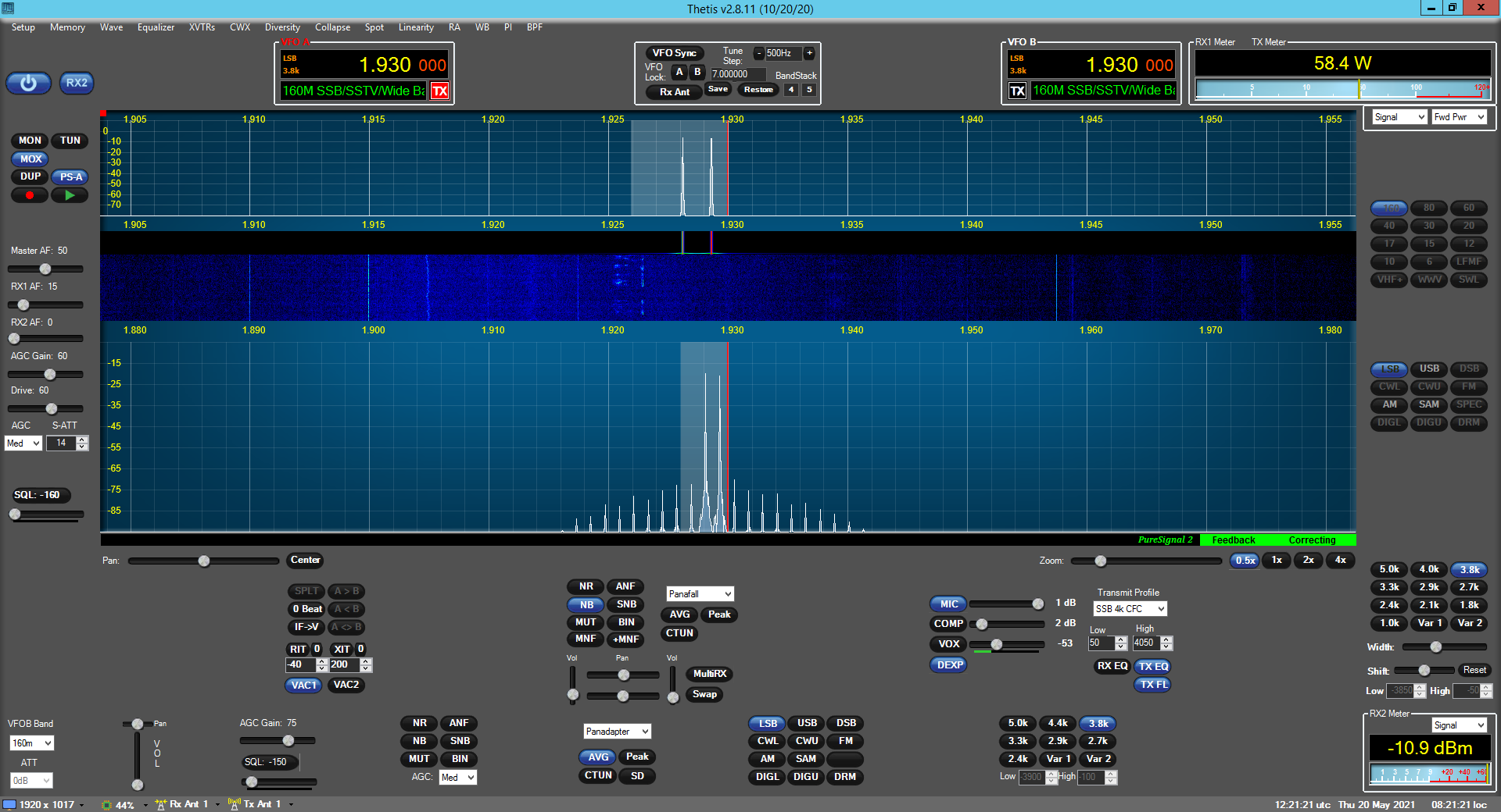

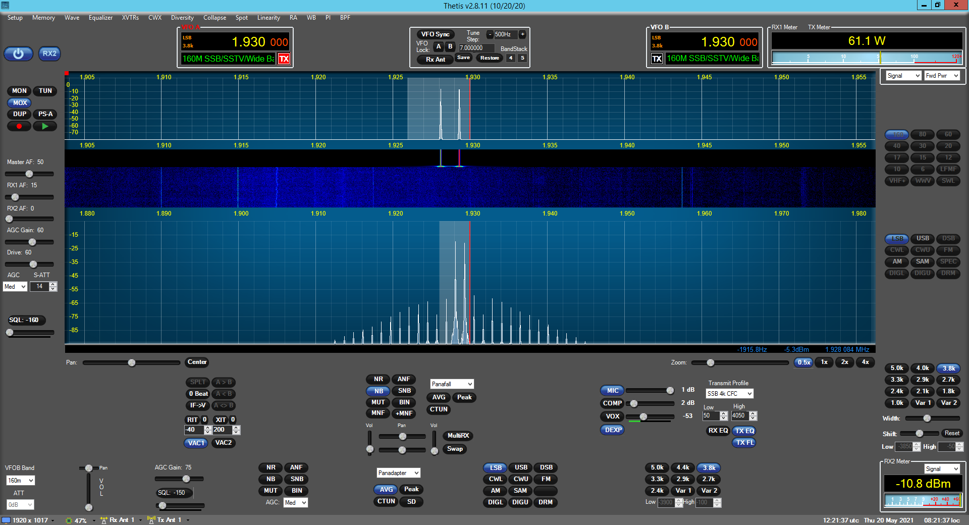

Greetings, gentlemen. I've been reading the forum and enjoying the wealth of knowledge and expertise here. I figured I'd share my experiences with PureSignal in hopes that someone might find it useful and/or interesting.

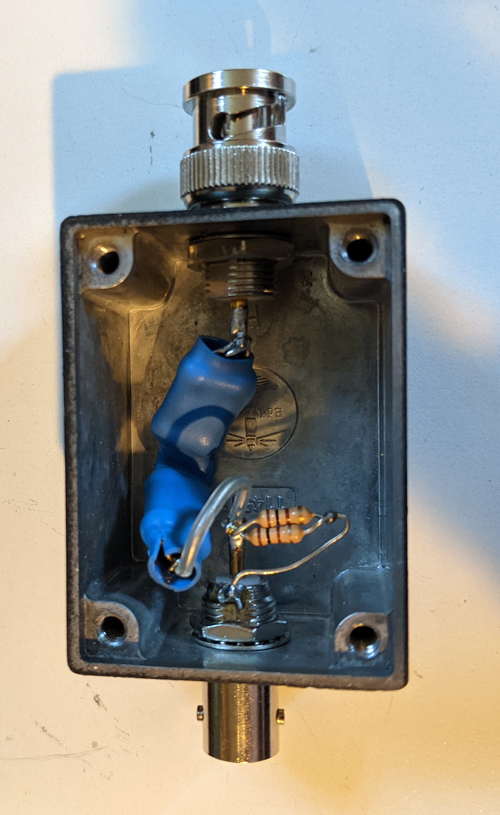

Firstly, I'm not using an ANAN. I have a homebrew setup based on the Red Pitaya 125-14 which works as a 100D in Thetis, so keep that in mind.

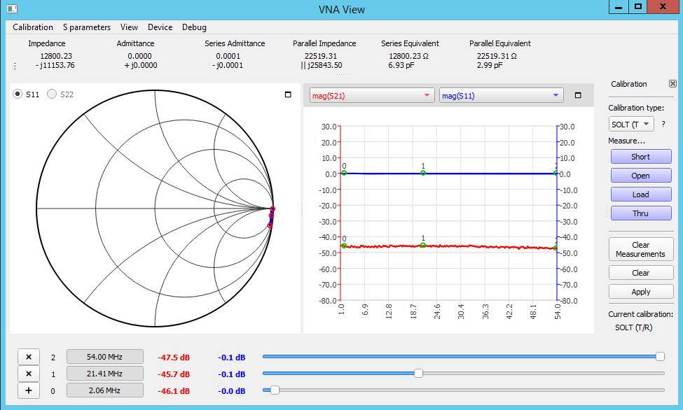

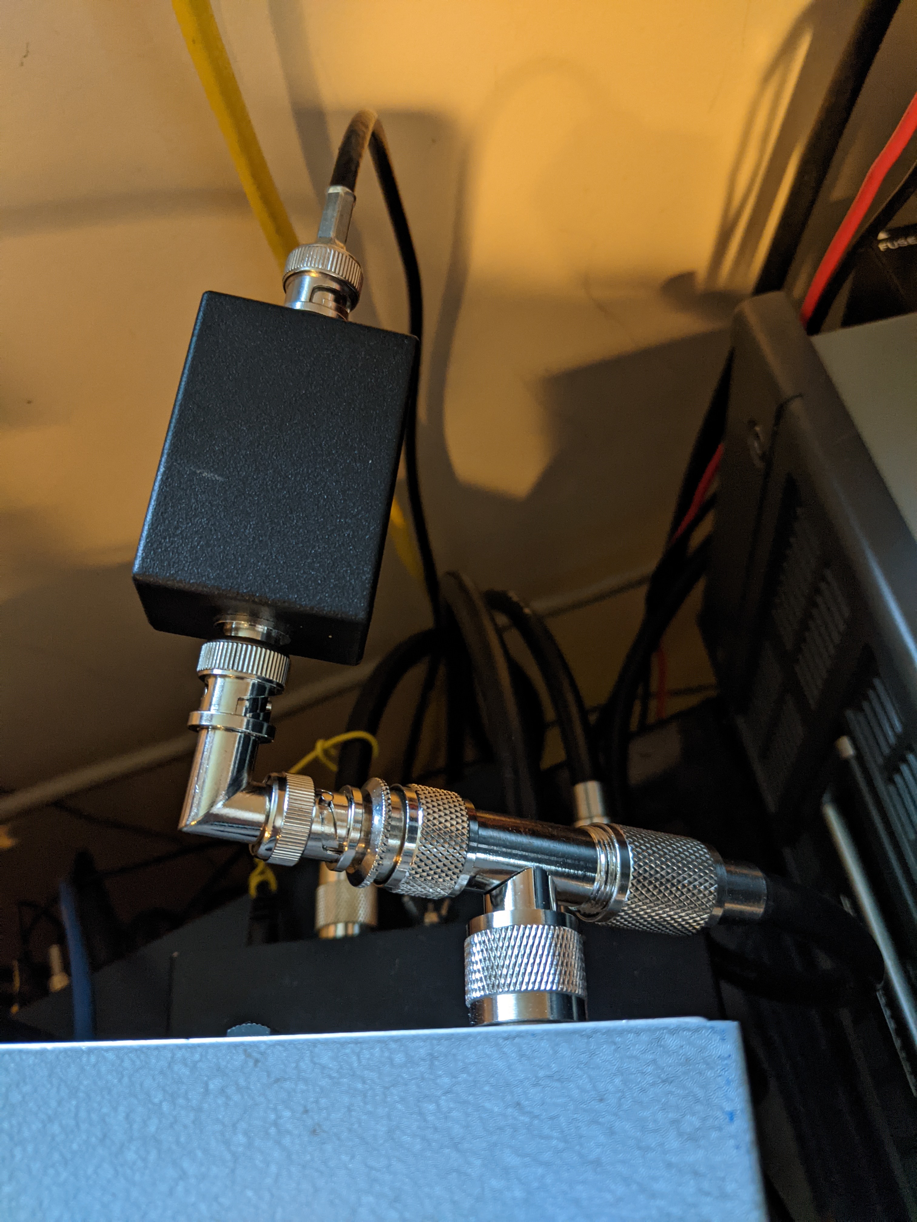

I made a very simple resistive RF coupler using series 11k and shunt 50. It is connected to the output of the amp (TL-922) using a UHF-tee connector. This offers about -47dB coupling with practically 0dB return loss. I just used resistors I had "in stock" to derive the 11k. Using 16k/50-ohms would give a -50dB coupling. Inside the rig is a PE4302 step attenuator which Thetis controls with the "Auto Attenuate" feature. The RF inputs on the Red Pitaya are very hi-Z and I use transformers to help with this on the antennas, but for PureSignal I'm omitting the transformer. This may or may not make a difference.

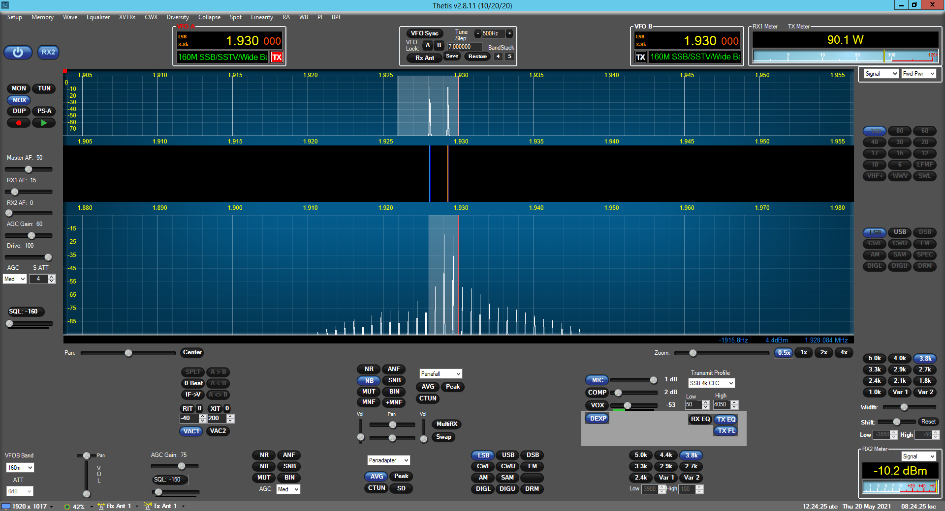

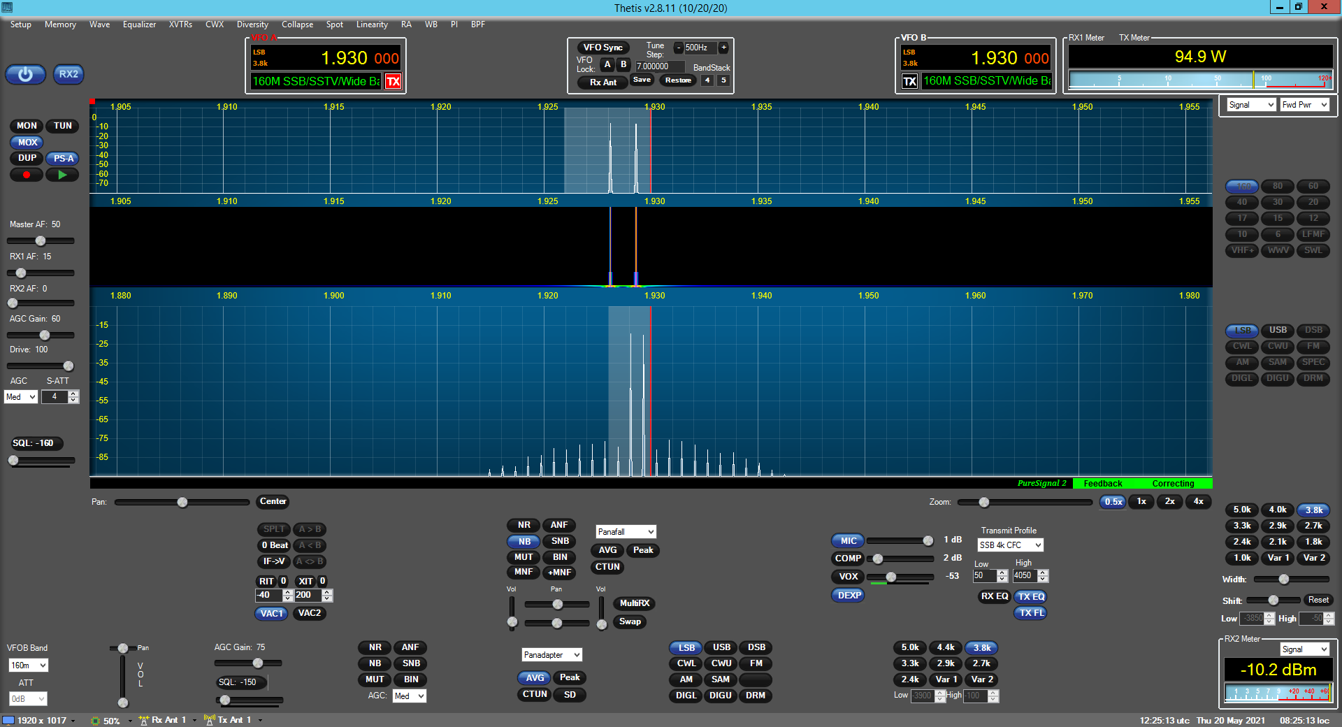

This morning in preparation for this post I (quickly, had to go to work) fired everything up to take some screenshots. These tests were transmitting into an antenna, not a dummy load. As you can see, the IMD is pretty good even without PS. I seem to remember more of a difference between PS on/off the last time I looked at it but nonetheless, this is what I got this morning on 160m. I might do some additional testing later.
Nick W1NJC
~1400W or so:
~100W:
Coupler:

My homebuilt sampler is also pure resistive (18K ohms). I used that approach because 1) it's fairly linear (i.e., independent of frequency) and 2) to avoid any potential for undesired influence of inductive or capacitive reactance on PureSignal's operation. My memory is dim now but I probably decided on the 18K ohm value mainly because that's what I had in the parts jar.

Thanks, Mark. Well 18k/50 would give you -51dB so seems sensible. I put a shunt 50 on mine so whatever driving point impedance the PE4302 step attenuator presents is in parallel. Probably 50 ohms so maybe another -3dB. I don't think it really matters anyway.
Mine seems very linear. I think they are carbon resistors (they were OLD).
