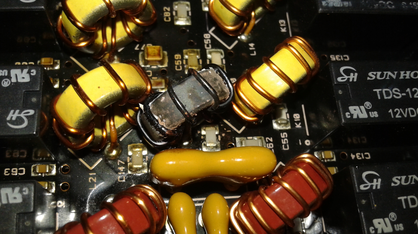

Hi and thanks for reading this.
As the subject says, the L9 toroid is in a pretty bad shape and need replacement. The inductors in this portion of the PCB where too close to each other. So, the result is a loss of power on 20 meters and a electronic burnt smell when it happened but it runs a few years before the problem occurred.
Please, can someone tell me where the heck I can get one or two of this 311 nH toroid?
Tried on Digikey and others but for no go.
Maybe is it better to ask Doug W5WC for this?

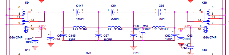

Hi dear OM's of Apache Labs forum.
FYI, I replaced Toroid #L9 because it was totally burnt. Radio got back is 100 watts but just for a few minutes, after FT8 key down that I used to do since 2 years, now it is burning right away. (maybe I was lucky but is was too much power handling and duty cycle)
I checked everything, put back a new toroid at L9, and this time, I did not let it burn right away, but I have another problem in that area of the PA board.
So for now on, I am suspecting a bad G6A-274P (K10) and or some caps in the vicinity of the circuit. (will get a good cap multimeter)
I can have DS2E-ML2-DC12V Relay Latching PCB DPDT 12V 2A in Montreal, just near by.
SWR bridge seems OK. Power on the other bands ok, only 17 meters experiment the same issue since it is the same circuit.
I'll will get back later with this when I'll complete this fix. (hoping so)
Please, if you have more informations on this issue, fell free to reply. It is not seems to be a common issue since I do not find anything on this trouble.
Good luck and 73's to all.
Stephane VE2SCA
