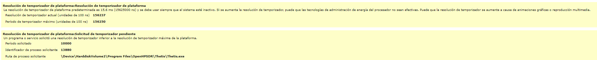

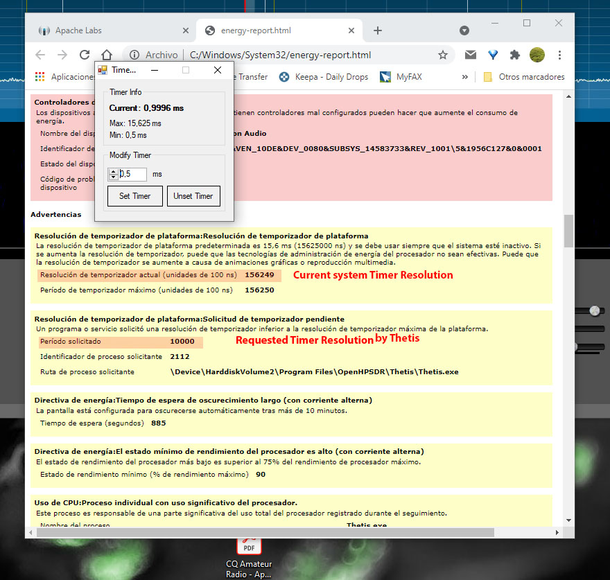

Run powercfg -energy duration 5 in powershell (admin mode) and take a look at the report located in /Windows/system32/energy-report.html
On W10 v.1903:
If I run it at IDLE the report shows a current Timer Resolution of 15.6 ms (Windows default and OK to save energy)
If I run it when Thetis is running, it shows a current Timer Resolution of 1 ms because Thetis requested a higher Timer Resolution and the OS agreed.
On W10 v.2004 and v.20H2:
Here things have changed... Interrupt Timer Resolution never goes lower than 15.6 ms.
If I run it when Thetis is running, it shows a request from Thetis to change to a higher Timer Resolution of 1 ms but windows sticks at his default resolution of 15.6 ms. and that's the origin of VAC under/Overflows.

If I run Timer Tool I also see a current resolution of 0.5 or 1ms when hitting "set timer" in the app, but looks like it is not right..w-u-2-o wrote:This may not be a universal problem.
I have been running Windows 10 Pro 20H2 since March. I've loaded every optional update except for the latest one. I've not experienced any problems at all. Using TimerTool (https://vvvv.org/contribution/windows-system-timer-tool) this is what I see at all times, with and without my audio software (Voicemeeter and Reaper) running, with and without Thetis running:
The current timer is less than the min/max range allows. Not sure that is a problem, but again my system is running fine, no audio glitches at all.
Could you please check the OS real Timer resolution running powercfg -energy duration 5 and checking what says your windows energy report?
I have the same problem with my "everyday windows drive" and also with a fresh W10 v.20H2 installation.
Have you read the first link in the bottom of my post?
EDIT:
Could it be a platform specific issue, what processor and W10 are you running?
Me a Ryzen 7 3700X and W10 Pro

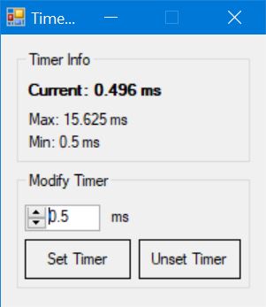

I ran the powercfg report. It reports that the current timer is set to 15.6ms, however it also reports all my audio software, and Thetis, requesting timers of less than the minimum allowed 0.5ms.
Both TimerTool and SysInternals "clockres" report that the current timer is set to 0.496ms.
I'm inclined to believe that the powercfg report only reports on the max. allowable timer interval and not the current timer interval.
Again, I'm experiencing zero problems hear with anything that is using real time audio processing. This includes the Presonus driver, Reaper DAW, Voicemeeter DAW and Thetis.

I'm sorry but I must dissagree.
If I run Powercfg in w10 v.1903 it reports current timer interval of 1ms when Thetis is running and 15.6 when the system is IDLE.
On W10 v.2004 or 20H2 Powercfg reports a 1 ms request from Thetis, but unfortunately it is not set and the current timer interval stays fixed at 15.6ms as per report data.
https://ibb.co/YdZLnpM
- timer.jpg (91.5 KiB) Viewed 59706 times

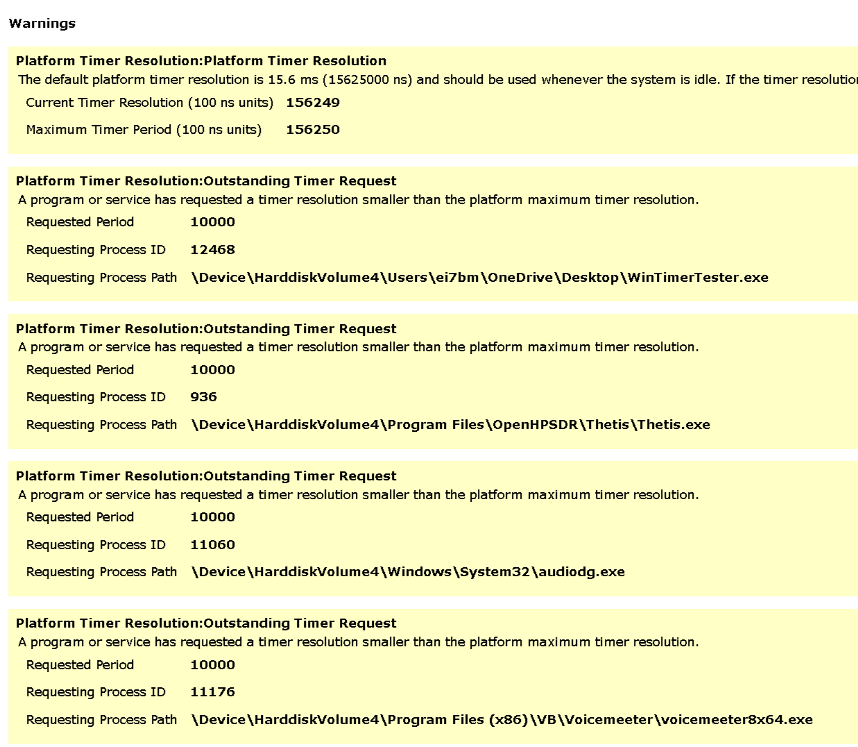

I did the windows upgrade last night and I am also now seeing issues with overflows/underflows where previously this was rock solid. Using Ryzen 1700 CPU
Re: VAC under/overflows due to changes in how Windows handles Timer resolution
Here''s what I am seeing in energy report and Timer tool
Platform Timer Resolution:Outstanding Timer Request
A program or service has requested a timer resolution smaller than the platform maximum timer resolution.
Requested Period 10000
Requesting Process ID 936
Requesting Process Path \Device\HarddiskVolume4\Program Files\OpenHPSDR\Thetis\Thetis.exe
Requesting Process ID 11060
Requesting Process Path \Device\HarddiskVolume4\Windows\System32\audiodg.exe
Requesting Process ID 11176
Requesting Process Path \Device\HarddiskVolume4\Program Files (x86)\VB\Voicemeeter\voicemeeter8x64.exe

Yes, I also see the program requesting a smaller timer resolution but the problem is that this request is not being applied.
Look further on the yellow or white section and you will see the "current resolution" stuck at 15.6ms
I've read somewhere that timer resolution setting tools no longer work properly on W10 v.2004 and newer...

Here is data from my system. I was able to run rock solid 8ms in and out before the upgrade. Now I can go no less than 50ms before I get endless underflows and overflows. I'm running an Intel I7 9700 cpu
I don't have any "before" data, just the current energy report
- Timer.PNG (12.48 KiB) Viewed 59633 times
- Energy.PNG (20.64 KiB) Viewed 59633 times

First of all, thanks for the report, but unfortunately there is no info about your current Timer resolution on you Powercfg screenshot, I just can see your 1ms request. Check also in the "white part of the report to see if it is there. (sometimes it appears in the yellow part, and sometimes in the white one).rbduck wrote:Here is data from my system. I was able to run rock solid 8ms in and out before the upgrade. Now I can go no less than 50ms before I get endless underflows and overflows. I'm running an Intel I7 9700 cpu
Please check further in the report to find the current resolution and please post it!

ea3aqr wrote:First of all, thanks for the report, but unfortunately there is no info about your current Timer resolution on you Powercfg screenshot, I just can see your 1ms request. Check also in the "white part of the report to see if it is there. (sometimes it appears in the yellow part, and sometimes in the white one).rbduck wrote:Here is data from my system. I was able to run rock solid 8ms in and out before the upgrade. Now I can go no less than 50ms before I get endless underflows and overflows. I'm running an Intel I7 9700 cpu
Here it is with all the info. I've tried all power modes and same results with them all.

Scott am I right in thinking that you are not seeing the warnings in /Windows/system32/energy-report.html ?

Linked in the first post, it is a must read document! (including all comments).
This is the explanation of all the problems after W10 v.1903
https://randomascii.wordpress.com/2020/ ... le-change/
