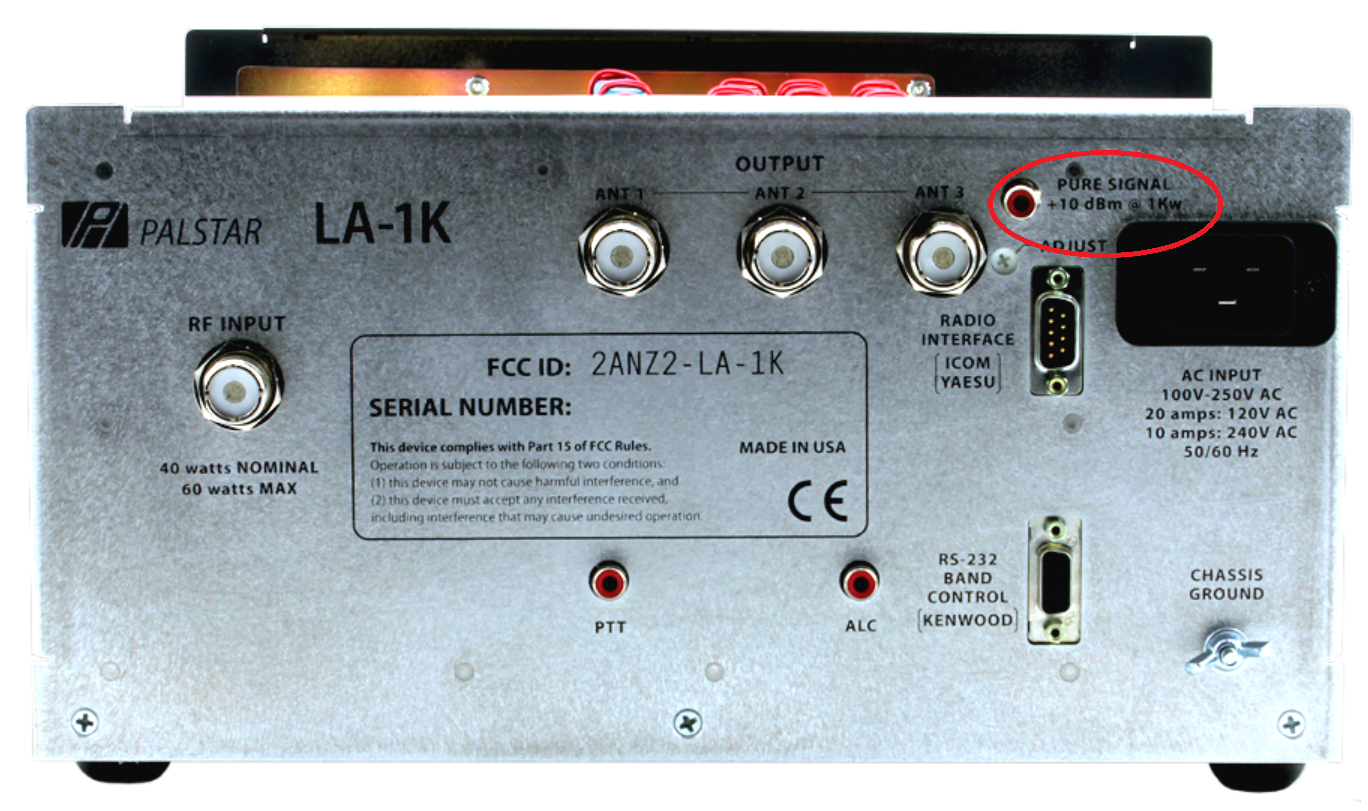

I recently just received my Palstar LA-1K and noticed it has a Pure Signal Jack on back, anyone using it and how would it connect to the Anan 7000 MKII Black?

If it were me I'd just run a cable between that jack and the Rx Bypass jack on the Anan.
It'd need to be a custom cable, with a BNC connector on one end and an RCA plug on the other end.
But that's just me.. :)

Mark is correct, of course.
You need to set the "Bypass on TX" option in the settings so that the radio uses the external feedback signal instead of one from the internal coupler.

Ok, got that, but will it also correct the Amps output as well as the Anans? I am guessing no, of course PureSignal still gives a cleaner signal to the am to work with. That being said I am guessing with the newer Anans it's not needed?
Re: Palstar LA-1K Pure Signal Jack
Posted: Mon May 10, 2021 11:44 am
NI0Z wrote:Ok, got that, but will it also correct the Amps output as well as the Anans?
Yes, that's the entire point of using a feedback signal coupled off of the amp output. PureSignal will make the necessary corrections in order to achieve linearity at the point where the feedback signal is coupled from, in this case the output of the external amplifier.
Think about it mathematically: PS knows the shape of the input signal. PS is measuring the output, in this case at the output of the external amp. It does the math to make the output look like the input.
That's definitely not true. Without PureSignal the linearity of all ANAN models, newer ones included, is not significantly different or better than any other amateur radio transceiver. And, as a group, non-linearized amateur radio transmitter linearity is pretty poor, with IMD products in the -30 to -40dBc range. That's why PureSignal is so awesome. It can take that mess and reduce IMD products down to about -60dBc.
