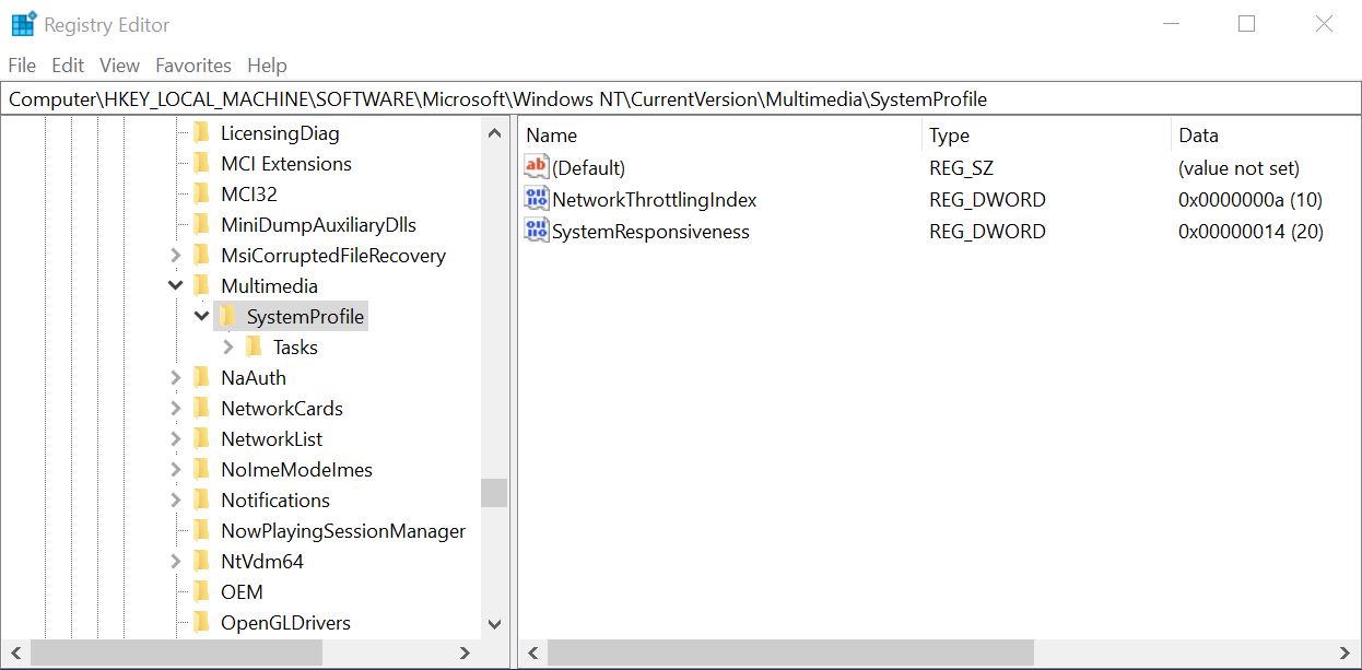

To change this setting you need to run the Registry Editor (regedit), then find the following registry key:
HKEY_LOCAL_MACHINE\SOFTWARE\Microsoft\Windows NT\CurrentVersion\Multimedia\SystemProfile
In that key you should find a registry value of type REG_DWORD called NetworkThrottlingIndex. It will have a default value of 0000000a in hexidecimal notation, which is 10 in decimal notation.

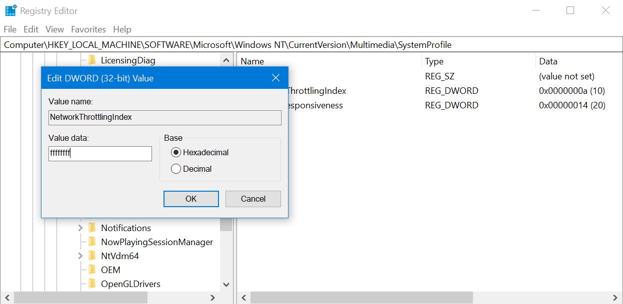

Double click on that value, change it to ffffffff (eight "f"s), click OK, close the Registry Editor, and reboot.

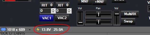

All
I have made these changes and now I have a Yellow lightening bolt with 13.8v 25.0A in the bottom LHS where it used to give me the CPU usage.
If I click on it it does not change or give me any information.
Any suggestions what it means,

John--what version of Thetis are you running, and with what hardware (e.g. 200D, 7000, etc? Not only do I not see CPU percentage, but also do not see the antenna assignments on the status bar. This implies that you are either running an older version of Thetis, in which case you should update to 2.8.11, or if you are running 2.8.11 that the database or installation has somehow become corrupt. In either case this seems entirely coincidental to your registry change, which should have absolutely nothing to do with any of this.
FWIW, you can turn the volts/amps display on/off in Setup > Display > General.

May not be relevant (and I’m away from the shack and going from memory - never a good thing for me- lol), but I had what appeared to be “full screen” but it wasn’t - not until I expanded to actual “full screen.” If I remember correctly, only then did I see CPU usage, etc. Again, may not apply, but I thought I’d note it.VK2WJ wrote:All
ANAN 7000 DLE MKII

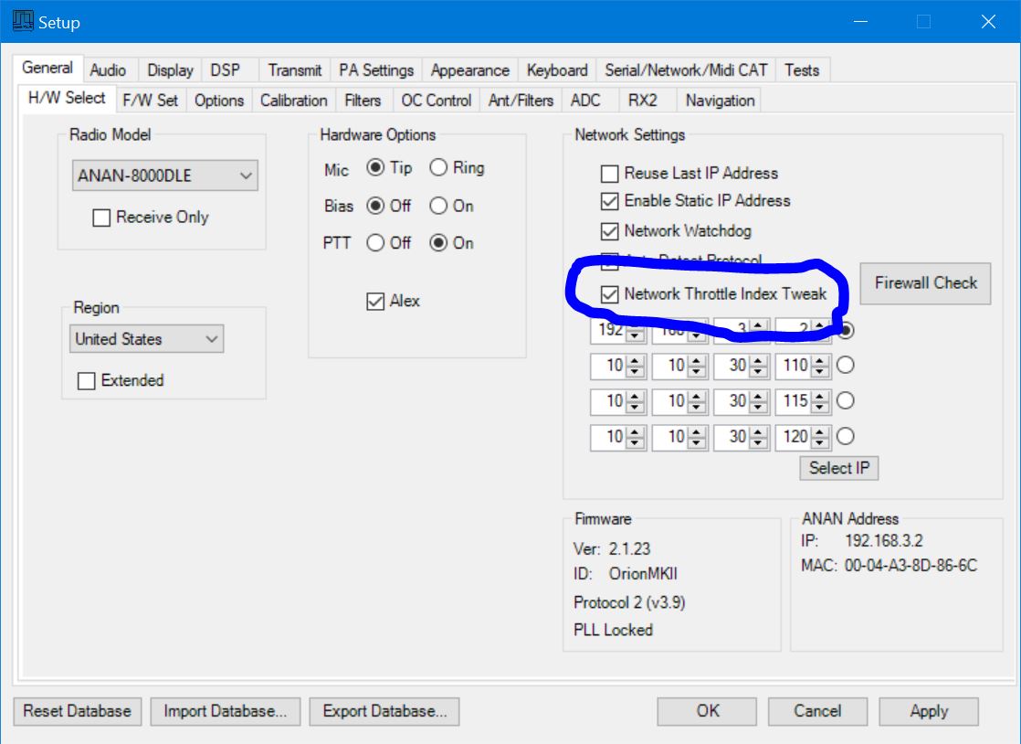

Don't forget, if you run Thetis as administrator you can change this right from within Thetis:
